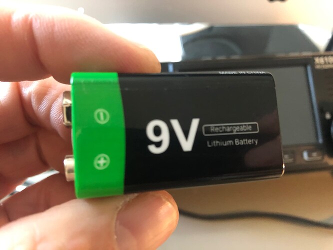

Hi Ivo @LZ1CLM
I’m using this one for my keyer and no noise on my TRX :wink:
73, Éric
F5JKK

There’s no way it can be 9v 6800mAh in a package that small. It will have a switched mode boost converter built in and it will be noisy.
I’m using this one from Amazon. No noise that I can tell on transmit or receive. I also don’t believe the 1300 mah claim. It’s more like 600 mah.
The normal Voc from a 2-cell Li-ion “9V” battery varies from 7-8.4 V depending on the state of charge. Some new brands are using a step-up converter within the package to bring the voltage up to 9V - I’m sure that some of these cause RFI. If a manufacturer claims “true 9V” on their battery, that’s a clue they’re stepping it up. Probably also bad for shelf life - to be avoided.
