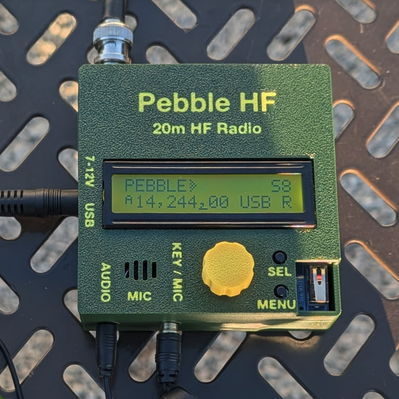

New Pebble HF Radio
Hi all :waving_hand:,
New Trx !
73, Éric F5JKK
Watch the YouTube video by K4SWL last night, it looks an awesome little rig. Perfect to leave in the car for quick, unplanned activations.
I think the Pebble will be popular. Now we just need Neil @G7UFO to organise a European assembly operation! I could easily assemble a PCB by hand, with a board order from JLC, but I don’t have experience with 3D printing.
The project is open source, with the BOM and gerbers online, but I do think something should be kicked back to the project originators too.
What a great idea for a radio!
73, Colin
Yeah, it does look smart. Have been chatting to Mike, N4FFF about the mic wiring and element for the Pebble HF.
My understanding is that they’re wanting to get a few out of the door and the design nailed down before looking to expand where it’s available.
Saw the videos last night. I’m going to order one when they become available. I have a K6ARK 49:1 unun that is not being used (prefer the 9:1 version with my KX2). This radio, the 49:1 EFHW antenna, and a spare battery from my KX2 will make for a tidy little radio for lightweight activations.
Chris
If you are interested in this project, visit groups.io here :down_right_arrow:
https://groups.io/g/BluQRP/topic/118455508#msg353
73, Éric F5JKK
