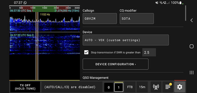

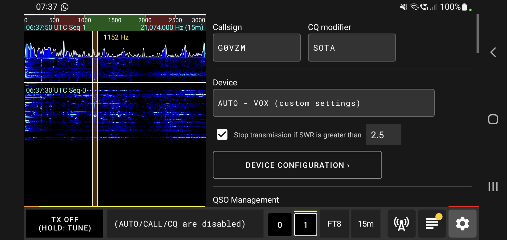

That’s what I do as well if I’m quick enough to swap the message before the next cycle, which can be fiddly on my phone. Some software lets you put a - or / in the free text but some don’t in which case I don’t know if it shows up at the receive end correctly so I tend to use the format “SOTA GW NW043”.
I’ve just checked qFT8 and the SOTA suffix and locator are still there from the recent activation. If the app requires permission for each time location is gained, this will happen. So for some software it is easy to mistakenly look like a sota activation of that was done recently.
For the one in question, the DX cluster shows the same location for multiple days. Is conclude, without any other info, this is a simple operator mistake. I’ve learnt to check those two details from reading this thread.
BTW qFT8 had only 4 chars it the suffix so no ref possible. The manual states a free text field is in the protocol but not implemented. So good spotting is key.
TBH I’m in two minds about ft8 and sota, having sat racking up contacts without touching the kit on a hill when other modes were not possible, but that is a different thread and a personal choice. Maybe I’ve “reached the age”.
I don’t use qFT8 so I’m not sure if I follow. Would this situation you’re describing with the app cause it to accidentally call “CQ SOTA” instead of just “CQ”?
Hi, yes. If I enter SOTA in the field (which allows only 4 chars) it will remain until I change it. So if come home and use the same app to operate it will TX with SOTA in the CQ call. To be fair, the full text is presented on the screen during transmission so I would have to not be paying attention. But given the auto nature of operation it is possible.
The same for the location which comes from GPS or manual. If auto it is four uppercase characters. If manual it also remains until changed.
So I could easily appear to be activating my last summit for ten years if I paid no attention to the app.
Ah, I see – so it might call CQ SOTA just by virtue of retaining old data in the fields.
