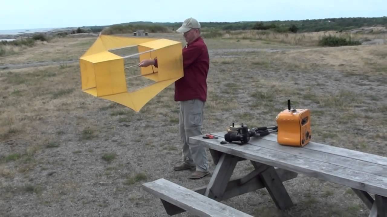

pictured is Helge LA6NCA who specializes in WW2 equipment. The video is at

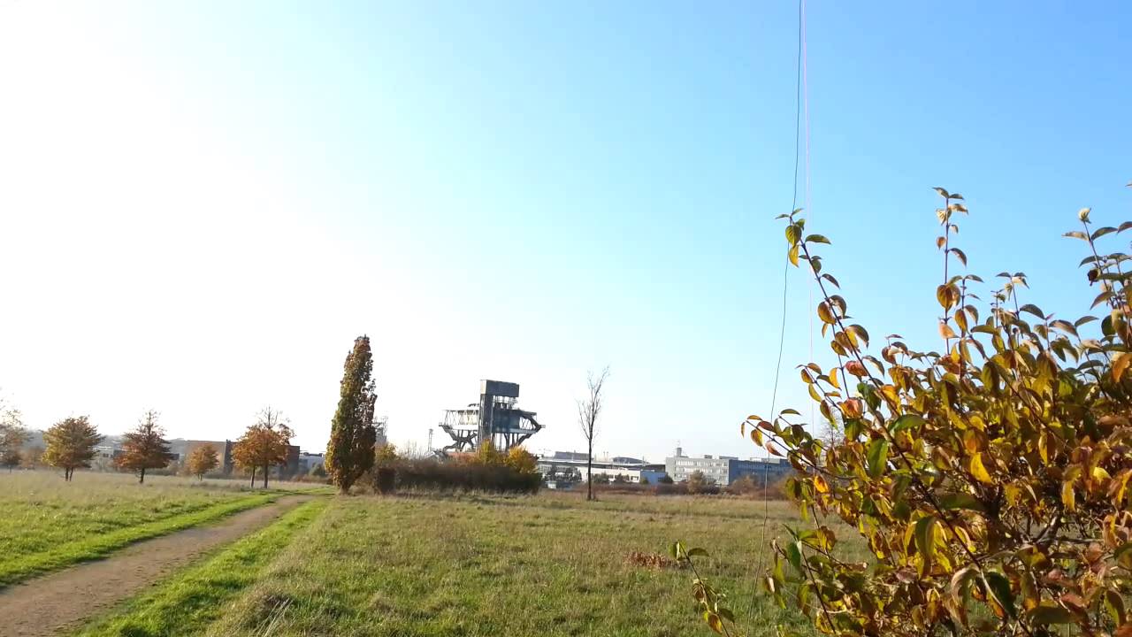

This is reminiscent of my attempts with the 20m long EFHW about 15m above ground. Unfortunately it was a windy affair, you need a diligent companion and often the antenna and kite fell down.

My use case would be an 20m end-fed wire going hopefully almost vertically 30m into the air, the balloon holding the wire, the small 49:1 balun and about 10m of coax cable, which along with the radio, would be grounded.
73 de Martin / HB9GVW
Yes, that was exactly my working condition. The Unun brings the wire to the ground of the coax. And I had no static noise and no static voltage on the trx. But don’t do this in a thunderstorm, hi.
