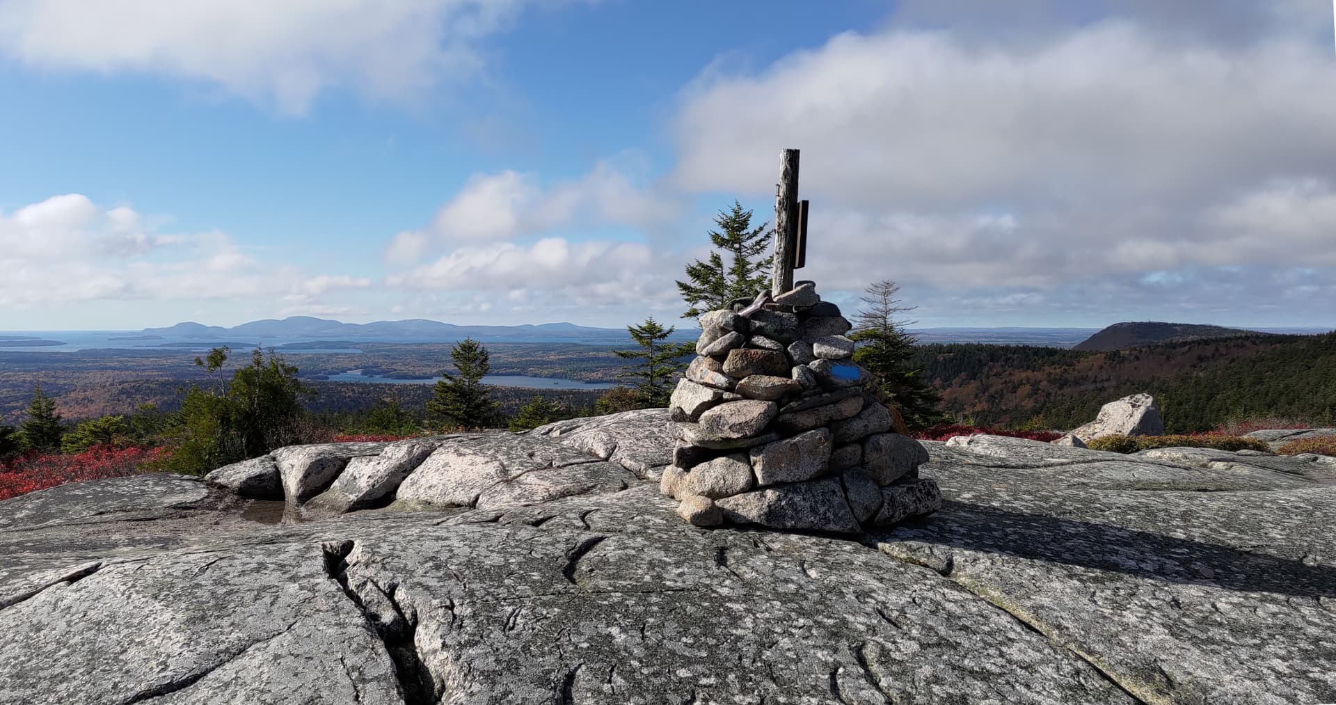

Black Mountain (SOTA W1/EM-013) in the Donnell Pond Preserve on 2025 October 17.
About 1.5 hours drive to the trailhead then 1.5 hours walk. Black Mountain is a beautiful, mostly-bald granite summit with views of mountains, autumn colours, very blue lakes, and the Atlantic.

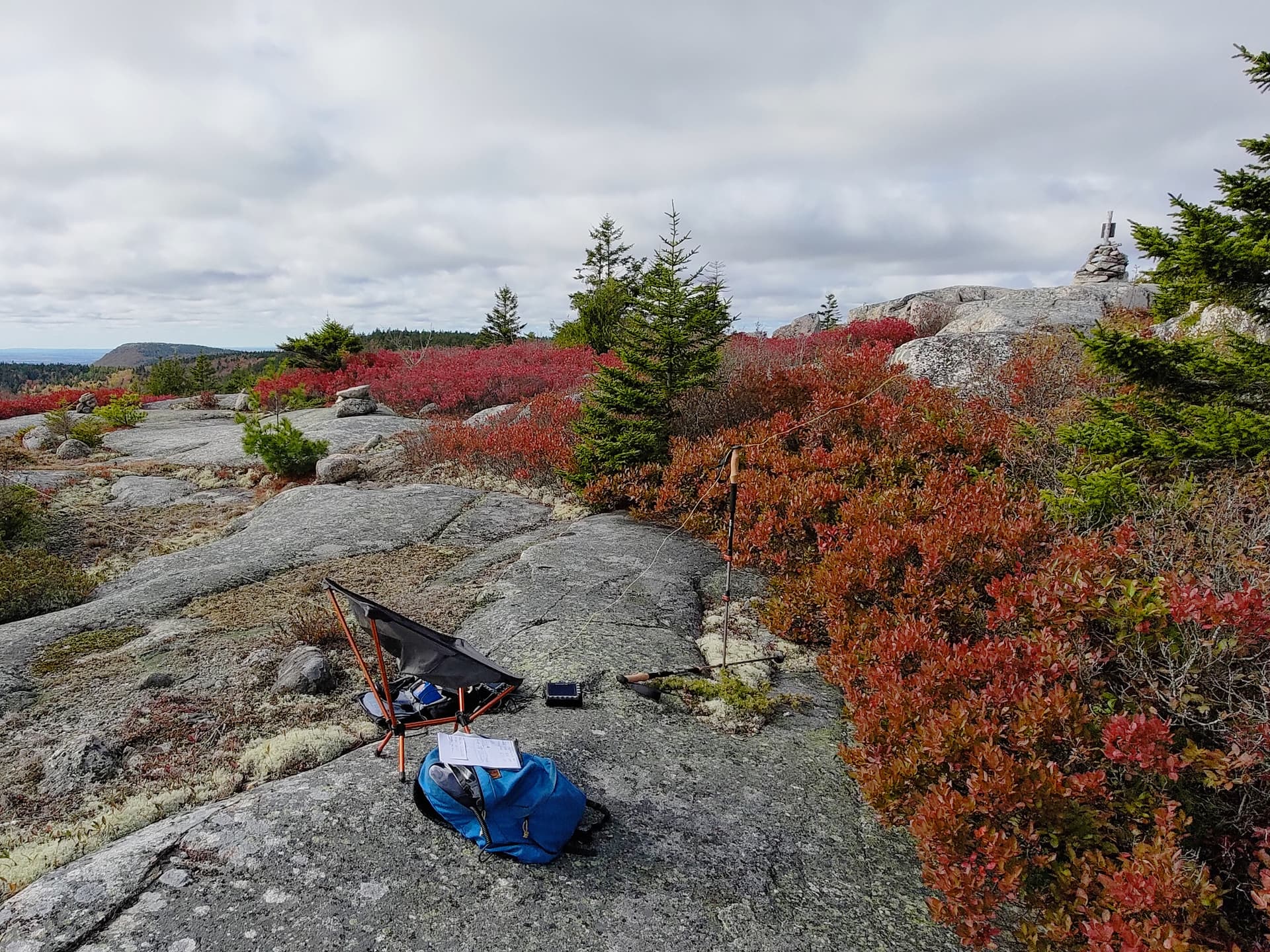

The only antennas I took were wires with some fishing line to hoist them up. The tallest spruce trees there are about 12 feet but finding a few together meant 10-foot trees (3 meters). I chose two 42-foot (13 meter) wires and strung each one up to one tree then across to another tree for V with horizontal wings. The antenna worked better than I expected. Getting to both sides of 4 trees meant a lot of detours to walk on granite and not trample the drought-crisp flora. The KX3 tuned this antenna to all 5 bands that I tried.

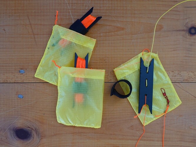

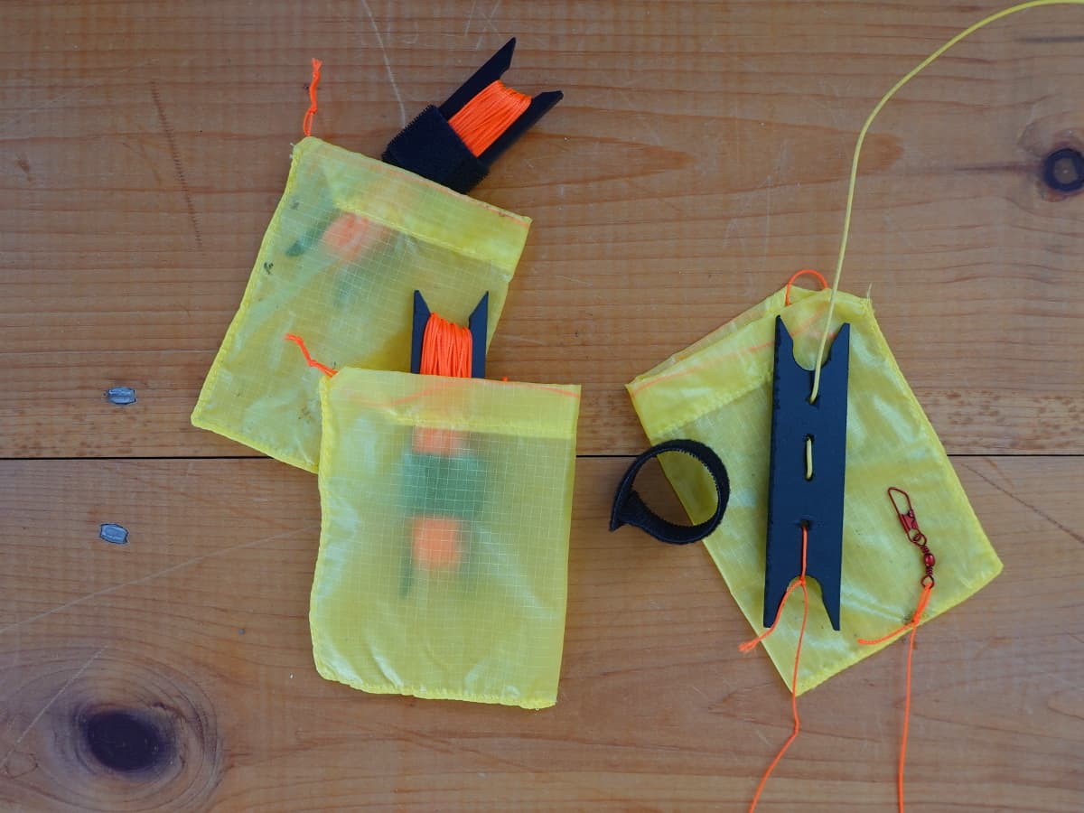

My fishing-line winders & antenna ends are maybe less than genius. They work for hoisting an antenna TO a tree but hit some sort of snag hoisting an antenna THROUGH a tree. Whod’a thunk? They also require that I unwind much of the fishing line before tossing the weighted bag over a tree. They worked OK this time but I need to work on version 2. They’re made of “expanded PVC” which has foam in the middle with a thin layer of solid on each side. Very light. With a clip for the weight bags, I had to tie zero knots on the summit. (I’m a knot aficionado bit tying and un-tying and re-tying a weight that’s not going where it’s supposed to is tedious.)

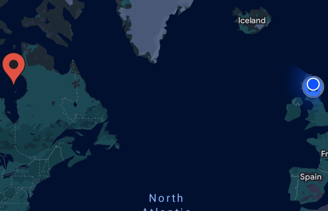

@MM0EFI North? The latitude of W1/EM-013 is south of the latitude of Venice, Italy. Quite far south of Scotland. But yea, if you look at the centre of the US, you’ll have to scroll north.

I don’t want to argue with you about the geography of your own country, but it doesn’t look like you can’t go further north than Maine without hitting Canada. :sweat_smile:
As you say, it’s all relative. My village is the same latitude as the middle of the Hudson Bay. Thankfully, milder in winter!
