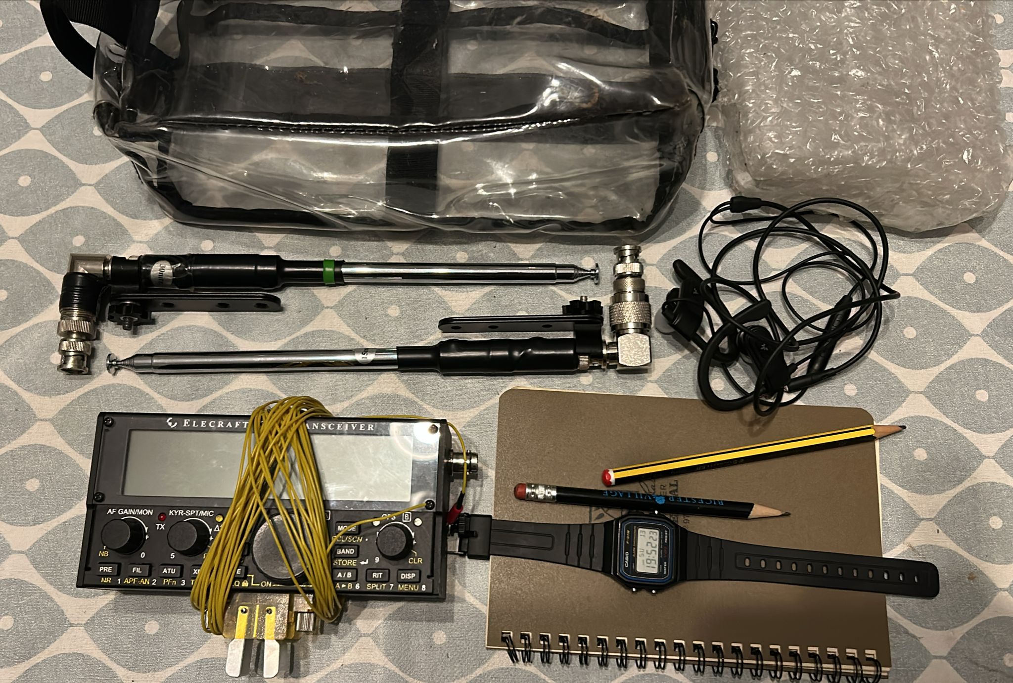

My instincts tells me my EFHW on a 6m pole has to be a better radiator / collector than my 1.4-long MFJ18xx monoband whips (and 7m counterpoise wire) sitting at rig height. Which is why I was so surprised with the results when I first tried them.
I don’t have enough experience to judge – especially now the solar cycle may be starting to wane – if the short whips still work well. So, I’m going to go ‘minimalist’ in an hour or so on 30m and 15m to find out.
I hope so, now in my mid 70s, in wintry weather I would prefer to spend two minutes setting up the short whip rather than 15-20 minutes with my ‘proper’ antennas.
