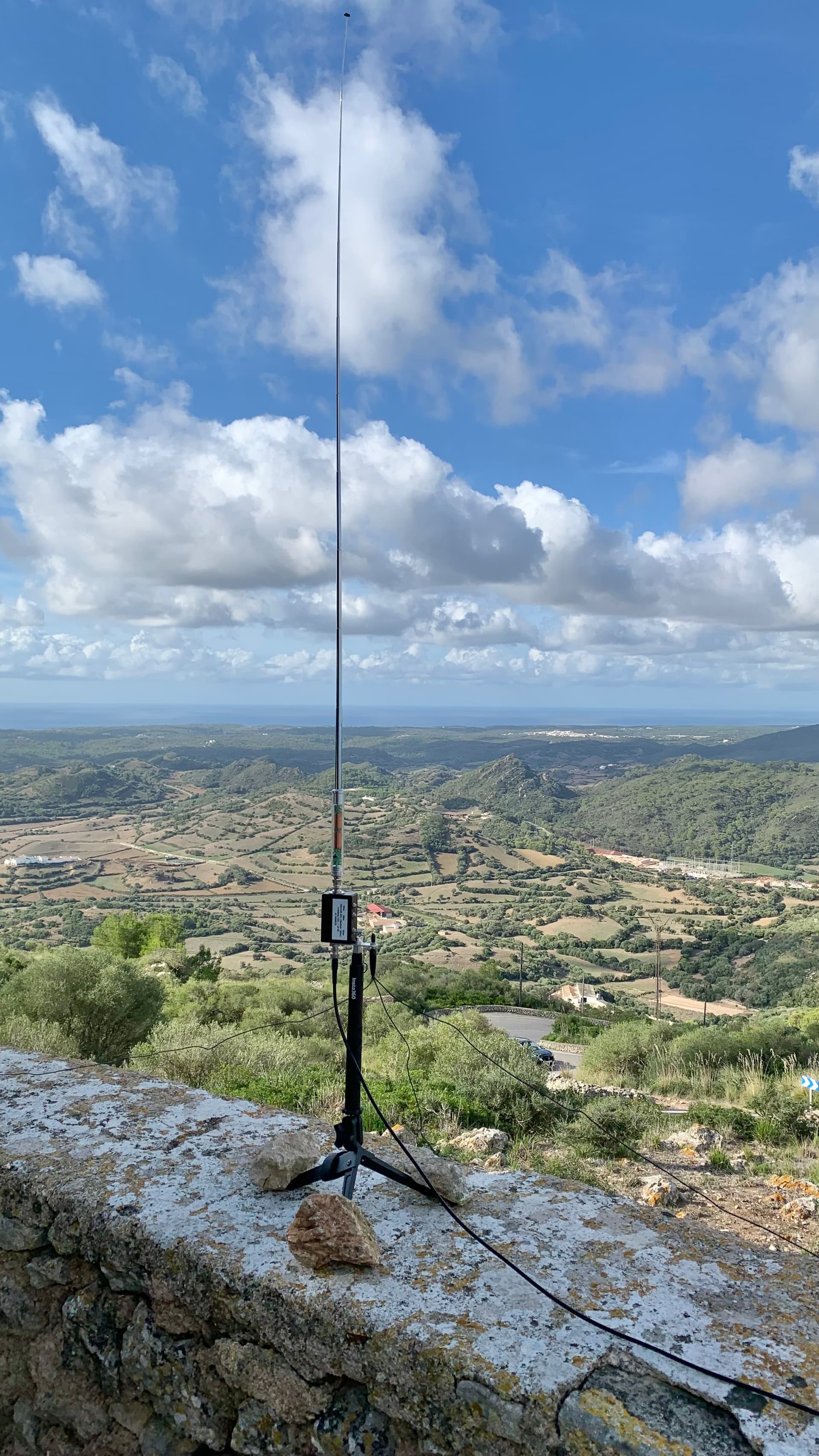

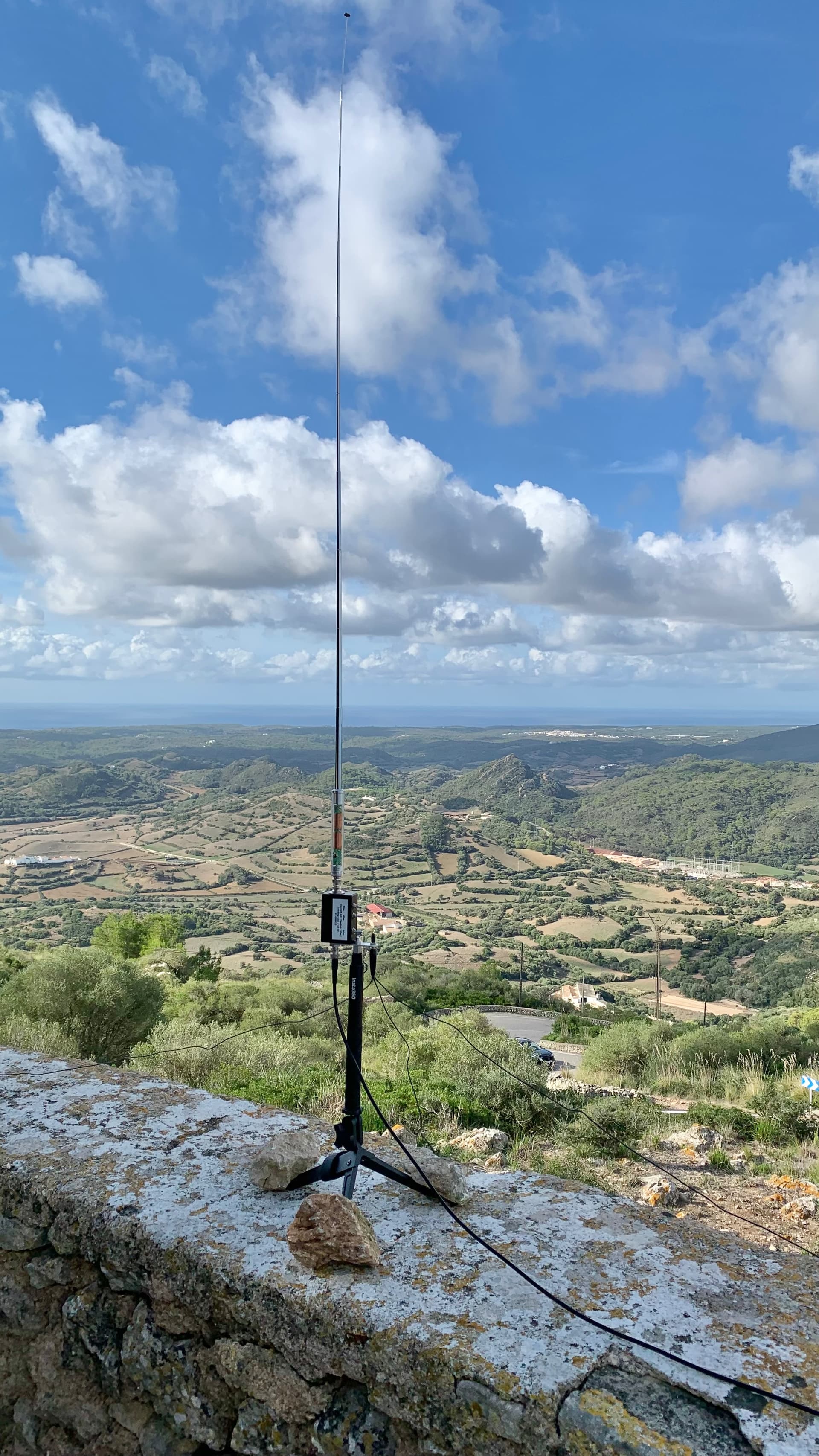

Recently, for example, Daniel, HB9IIO, while on holiday in Menorca, noticed that during his activation (photo below) the propagation conditions and thus the signal reports on 30m were significantly better than on 20m.
Nothing spectacular, just as can always happen, hi.
73, Heinz

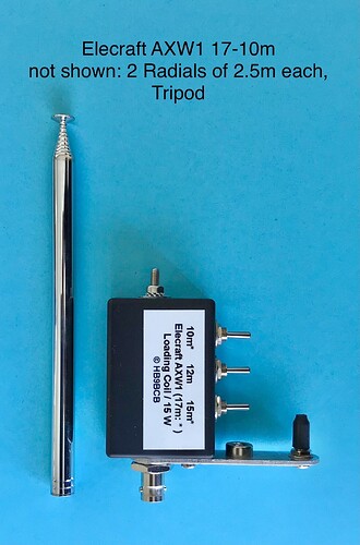

Not sure if you’re referring to the photos uploaded to groups io elecraft?

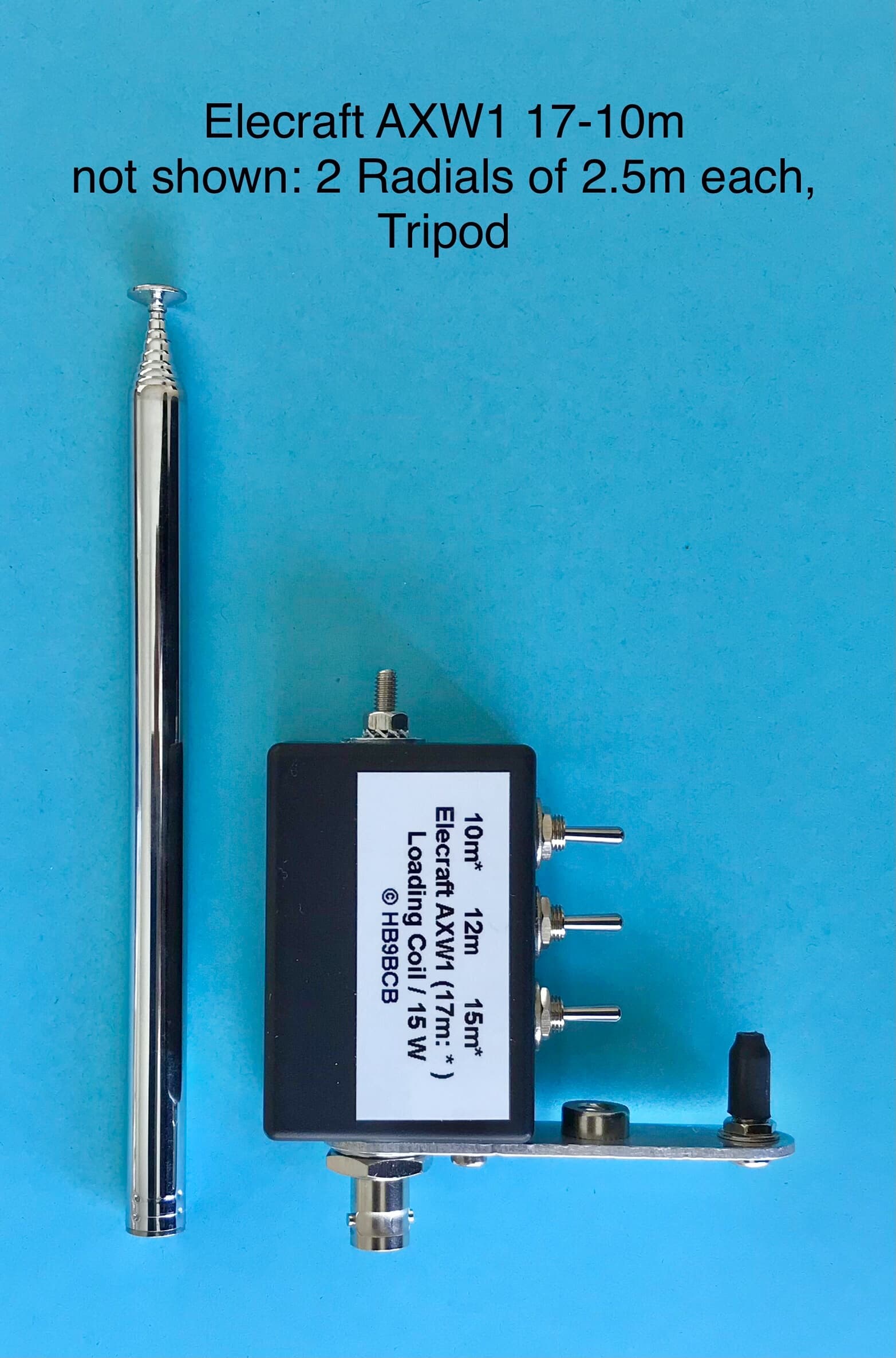

Elecraft AX1/2 for 60-10m by HB9BCB
Friends in France had a 2CV, and I loved driving it. With it’s low weight and small tires it actually does very well in snow and non-muddy off-road; you can let the sun in; and the sound is music to my ears. Quite different to the MV Augusta of course.
I was referring to this picture, Heinz:
Crafted like a Swiss clock!
73, Peter

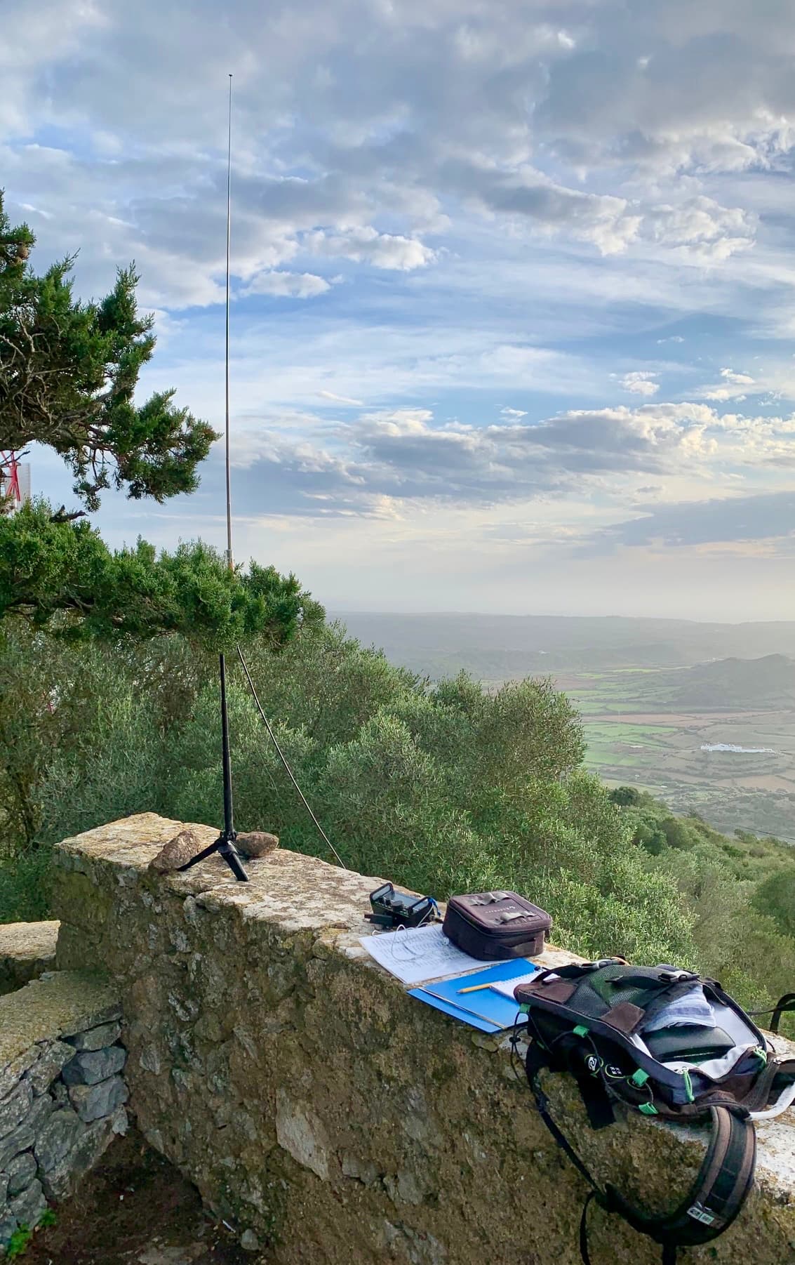

Just to report that Daniel, HB9IIO, still enjoying the beautiful holiday weather on Menorca, also benefited from the particularly good Spaceweather today.

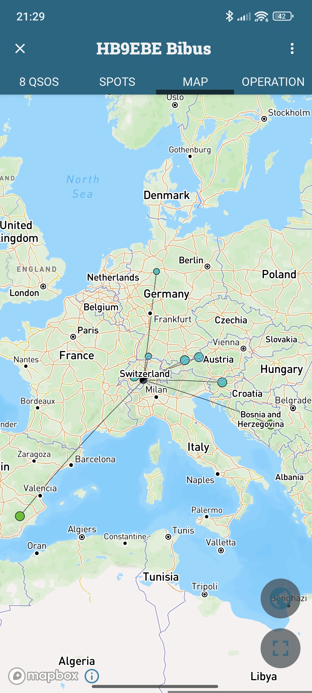

Daniel, an AX1 enthusiast, especially on vacation, deliberately reactivated SOTA EA6/ME-001 at a slightly later time of day. His hope of logging a handful of DX QSOs was fully realized, with 8 of 37 QSOs across the pond.
Well done, Daniel.
:heart_eyes: :waving_hand:

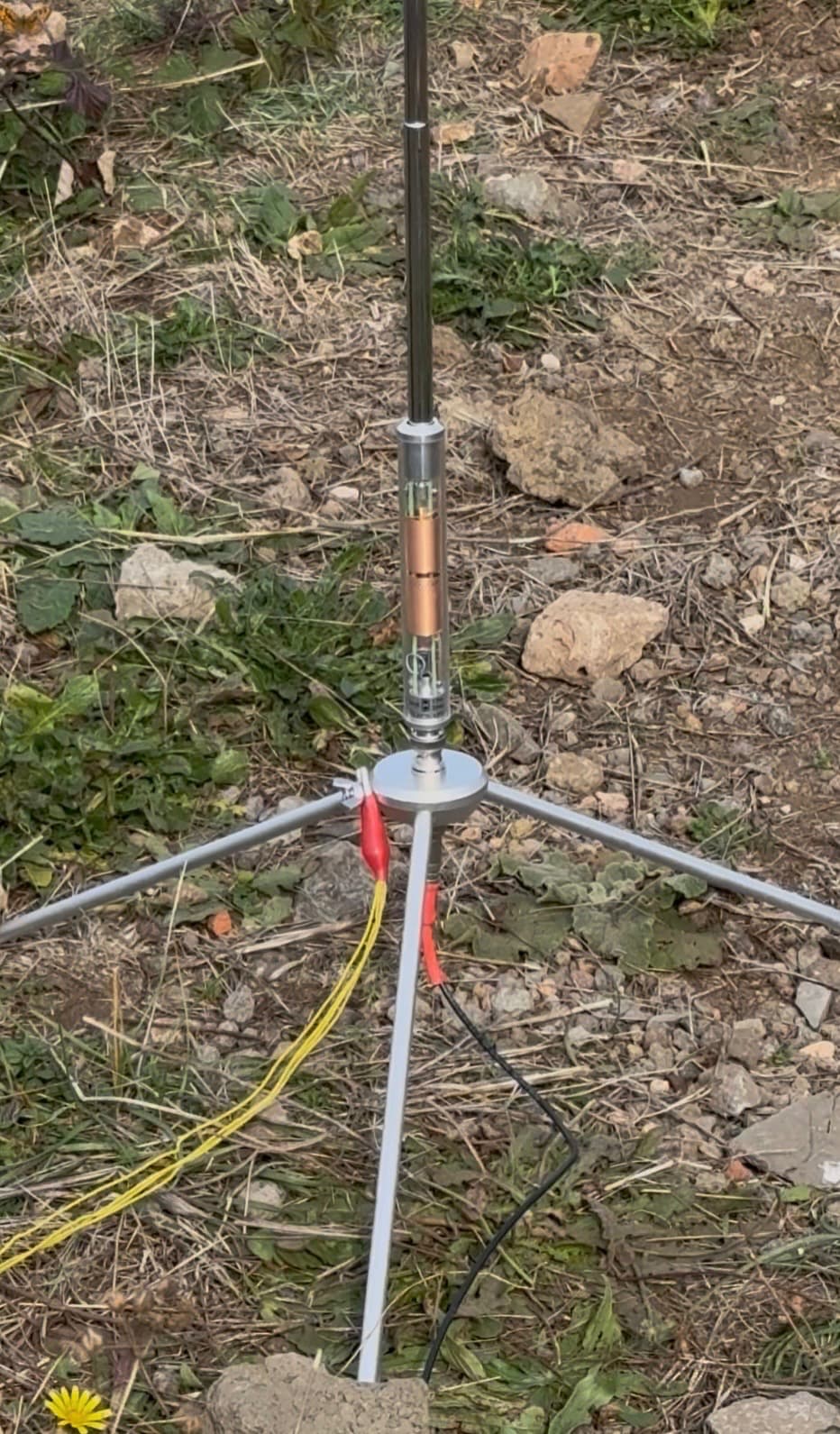

Nice antenna setup! I used the same one in Italy, on Monte Salomone (I/LZ-136), with a QRProject tripod. However, I had some trouble at airport security since the tripod is made of aluminum, they checked it several times, both in Málaga and in Rome. I haven’t used the BuddiStick tripod yet, but I plan to try it on my next SOTA activation once I recover from my cold.
  1. Manu!
Typically, we use the AX1/2 with guyed radials and an Insta360 selfie stick as a height-adjustable mast, as shown here Elecraft AX1/2 for 60-10m by HB9BCB

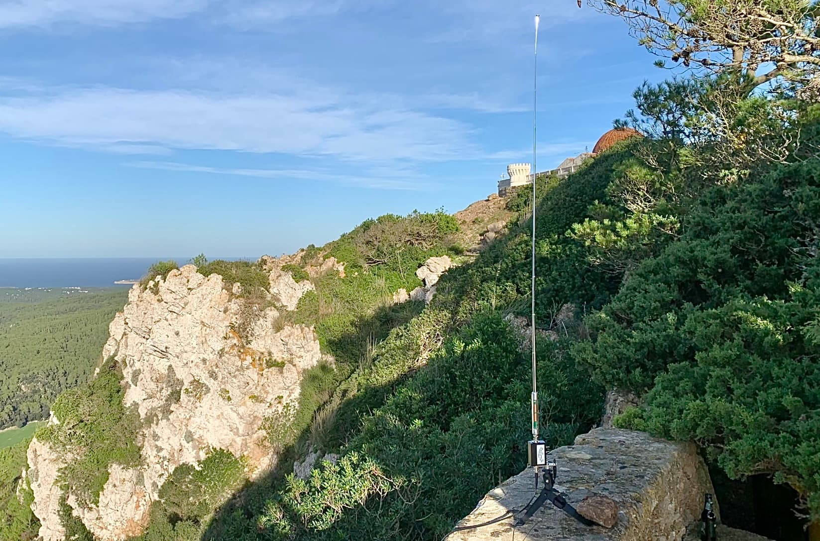

Daniel used this kind of antenna setup during his first activation of SOTA EA6/ME-001
Ah! I thought you were using the BuddiStick mini tripod, I have one and it looks exactly the same. I’ve set it up for the AX1, but I haven’t tested it yet. When I try it out, I’ll make a video so it can be seen properly. :blush:
Even today, with the AX1 and KX2 (5 watts) on 10-30 meters:
Within 1 hour, 10 out of 52 QSOs were across the Atlantic and 8 QSOs were on 30 meters.
That’s really a lot of fun!
