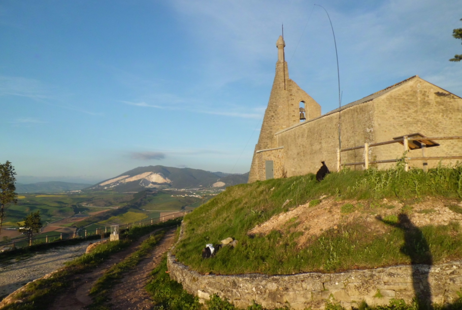

I installed the endfed as a vertical and being the wire longer than my fishing pole, I extended the rest of the wire horizontally along a wooden barrier at about 1,3m above the ground level.
See this picture showing the two antennas.
On 40m, the endfed was far superior than the mobile whip with several S units difference noticed on every signals received. This didn’t surprise me at all as the moble whip is far too short for 40m.
On the other hand, comparison of the two antennas on 20m surprised me a bit as I didn’t see any difference at all on any of the signals received during the test. The monoband mobile whip for 20m with a single 1/4 wave wire radial sloping down at about 45° seemed to perform the same as the endfed installed with about 7m of wire vertically and the other 3m horizontally plus a 6.5m long counterpoise extended on the ground.

The ermitage you’ll see in the pictures was placed right to the East, so it was kind of blocking my QRP signals towards Hungary.
