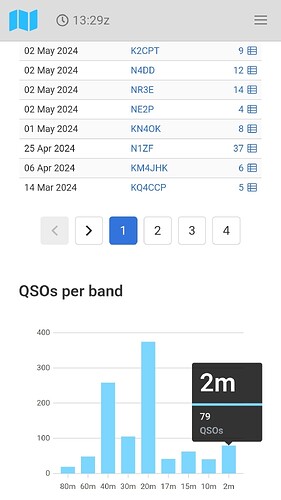

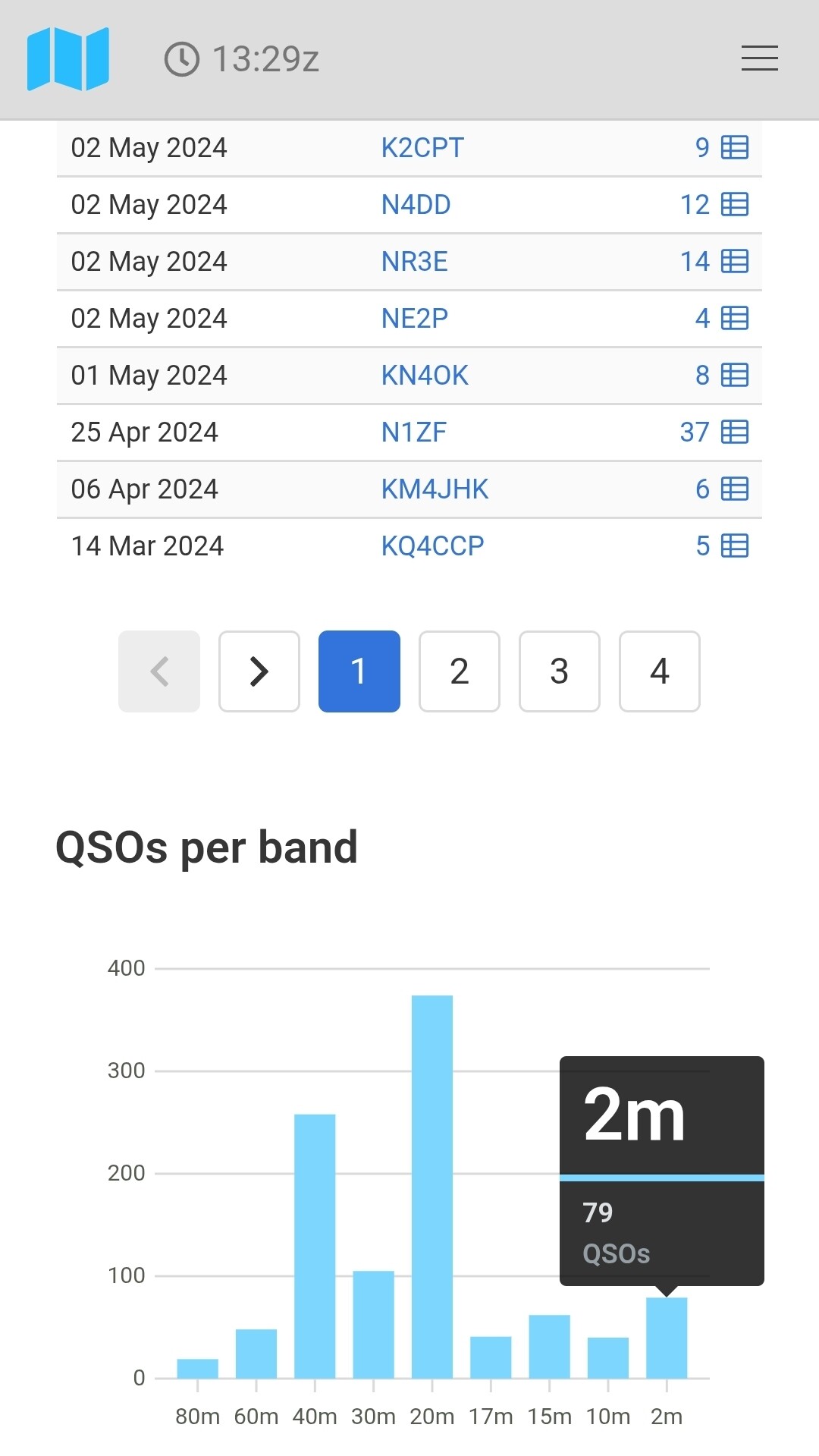

Sotl.as says yes to 2m, and I noted at least one activator with 4 QSO’s on 2m FM.
