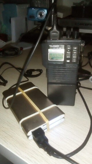

I had been willing to go out and activate SOTA for testing my 2 power banks connected in series to supply power to my vintage Yaesu FT-23R HH, but several duties kept me home until about 18h30 local. The good thing is I populated a good chasing log with more than 30 QSOs, including some transatlantic ones.

In the following picture, you can see my FT-23R still ON on my desk while still being powered by the 2 power banks connected in series.
In this picture, the FT-23R has the rubber duck antenna, but, at the summit, I used my Diamond 2m/70cm mobile whip antenna with one single wire radial like this:

The test with the 2 power banks was successfull and after my Baofenf HH got dead, I’ll now be able to be back again QRV on 2m FM during my hikes and also during my HF activations. Since these 2 power banks have a 1A output each and a capacity of 5000mAh, I think they may also be a good back-up to power my FT-817ND in case my LiFePo4 4S2P fails one day.
