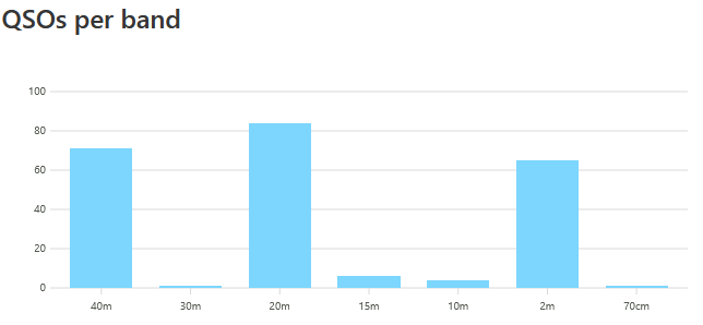

I’ve never been to Mt Whitney but I would be surprised if there were no cellphone coverage at the top. You might able to spot yourself.
Depending on weather an the situation I would focus on 2m FM as main.
Looking at the statistics it is very likely to work out:
So I would recommend bringing a descent antenna. At least a full 1/4 wave or 1/2 wave telescope antenna. Or my choice a rollup J-Pole
