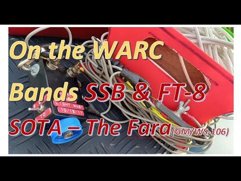

I had a couple of days leave to use, so decided to make the best of last weeks continued good spell. The “official” reason for going, was to try an aerial I’d bought off ebay (on a whim) last year. It was advertised as a “Military Aerial” and came in its own washbag, along with guys, pegs and basic instructions.
When it arrived, I could see it was a linked dipole, with a switched balun & some 75 ohm feeder. Fairly well made and far too heavy for SOTA. I made some measurements at the time and then put it away for the best part of a year.
Curiously, there was a QSL card in the bag. I’ve drawn a blank when looking him up. Was this his design, I wonder?
Measurements
30m 1:2:1 balun 1:1
17m 1.1:1 balun 1:1
15m 1.0:1 balun 2.25:1
12m wouldn’t tune
10m 1.1:1 balun 1:1

washbag antenna used on 17m

I casually erected the 40m/20m and got going on 40 with the FT-857d running 25 watts, enjoying some decent conditions on the band which brought in 12 stations, including a summit to summit with I1IKN/IN3 on I/TN-142. I think conditions were better thanks to my earlier operating time - 0950-1001z
Swapping to the washbag WARC set for 17m, I got on the air at 1028 and worked OE6GND, CT1MH, F5JKK and HB9HEO over a period of 30 minutes.
The washbag WARC was double-guyed today

What’e everyone else using for WARC?

Nice video Frazer with some brilliant and awe inspiring vistas. How lucky you are to have it on your doorstep so to speak. Concerning 17m, I tried it a couple of weeks ago for the first time and was really surprised how good it was for dx especially using a long wire with very little power. Anyways keep em coming mate…They’re enjoyable.

Hi Fraser, I have used a fan dipole for 30 and 17 in inverted vee configuration which worked well but is a bit tricky to put up in wind. My DX Commander also covers WARC but is heavy and takes time to set up. I’m going to try a 17m delta loop on my next hill - easy setup and weighs next to nothing. 73, Simon
30M:
60/40/30 link dipole
30/20/17 dipole
Buddistick clone vertical
40/30/20 EFHW trap dipole
17M
30/20/17 link dipole
12M
1/4wave GP
Not all antennas are with me at the same time.
I had a go at making your trapped vertical a while back. Couldn’t get it to tune at all and put it in a box. Time for a revisit methinks.
I know Brian G8ADD built one and it worked. Barry GM4TOE built one and had some issues at first but I can’t remember how he fixed it. I think the height of the radial above ground at the antenna is key and then the radial has to be a fairly constant height. If it dips closer to the ground it will get detuned. Also the ground affects tuning… the radial is shorter for rockier ground. When I’ve used it in EA8 and CT3 it needed to be a lot shorter. Down at my sister’s QTH near Nimes in France it has to be a little shorter.
I’ll measure the missing measurements on mine and post the results.
That would be very useful thanks.
I had it strung up in the garden, so probably not the best.
30M:
40/30/20 EFHW
60/40/30/20 linked dipole
Chameleon MPAS Lite vertical
17M:
*40/30/20 EFHW
12M:
*40/30/20 EFHW
*My KX2 ATU makes the EFHW work pretty well on these bands.
The MPAS is my new toy so I tend to favour it nowadays. It’s less than 2lbs heavier than my wire antennas / poles and quick to put up / take down.
Nasty! Got four on Whitbarrow Scar yesterday but nine? Cunning little blighters.
Thank you Andy, that’s very useful information.
Cheers, Fraser
Yes, first time no trouble. I built it using banana plugs on the wires, and sockets on the coil and a Moonraker dipole centre so when needed I can make more wires up for higher bands, and I may add an extra roll-out radial to configure it as an inverted “T”. On its first use it got me a transatlantic SSB contact on 20m.
I use a 20 / 17m link vertical with 4 radials for the Trans-Atlantic S2S events which works extremely well. It does need to be temporarily telescoped to get to the link on the vertical element, but no such issue with the radials of course.

I love the BNC protection :rofl: :rofl: :rofl: :rofl:
73 de José (ea7gv)
Yes, the whole thing is very “rustic” but well constructed.
When did the WARC bands become legal? I suspect it may be that old!
