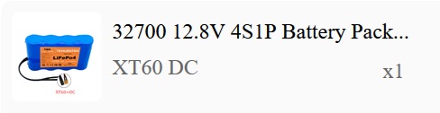

I was looking for something else on AliExpress and noticed all of a sudden that there are many, many vendors selling 4S1P 7000mAH (nominal 12.8V) and 4S2P 14000mAH packs using 32700 cells with integrated BMS. Last time I looked there were plenty of vendors of individual cells but either these packs are relatively new or I just never spotted them before.
Typical is a 4S1P 7000mAH pack with BMS that’s about 35x75x135mm and 580g. The BMS is good for up to 40A. Many vendors selling these for prices from £21-£26 for your first order. Subsequent price is double this. This is includes free shipping with a 7-10 delivery time. Some are offering deals of 4S1P+ 2A charger for approx.. £30. e.g. https://www.aliexpress.com/item/1005009475349087.html
The above is just an example of what is available, I haven’t bought one or dealt with that vendor. I make no representation of quality or otherwise. I’m simple pointing out what is available that I had not seen before.

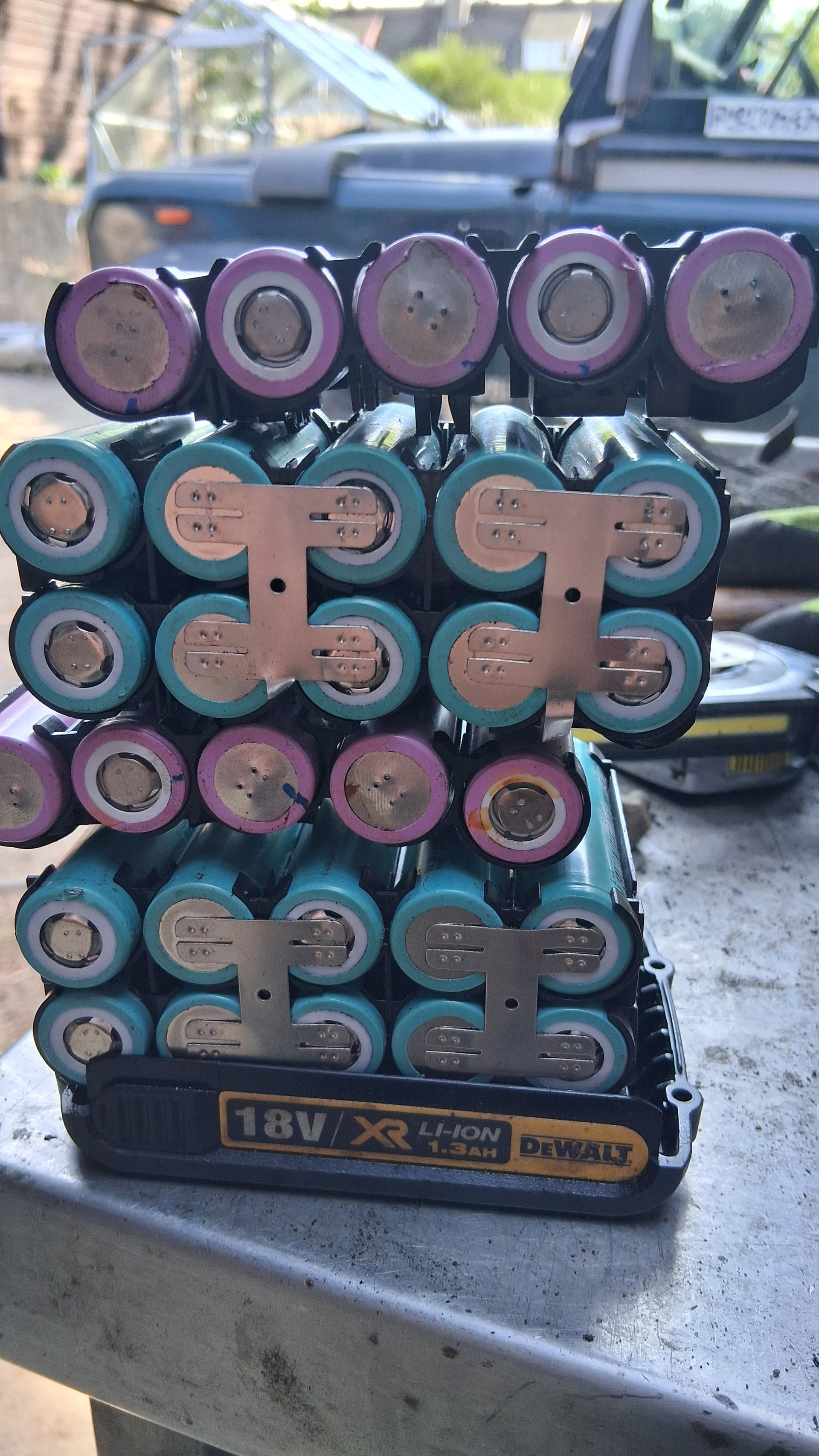

I’m wondering what to do with all of these 18650’s recovered from power tool batteries. I did contemplate making a 12v car jump pack, if I could convince myself it wouldn’t kill me during construction or use.
Go on, you know you want to make one. :slight_smile:

Ordered 14th Aug
Arrived 26th Aug.
Delivered by my local Evri delivery driver with no extra charges to pay.
Arrived wrapped in plenty of bubble wrap and packing tape, but no box.
Survived the 1.5m drop test, as I tried to carry to many things out to the workshop.
Not yet tried it out.
It will be mounted on the back of my 5Ghz panel antenna.
