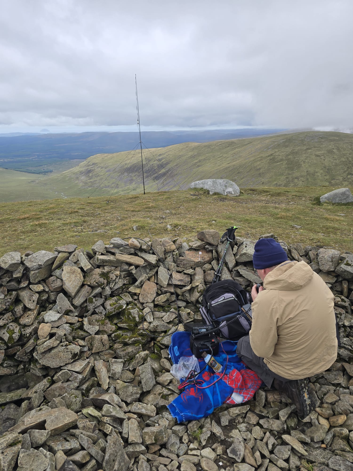

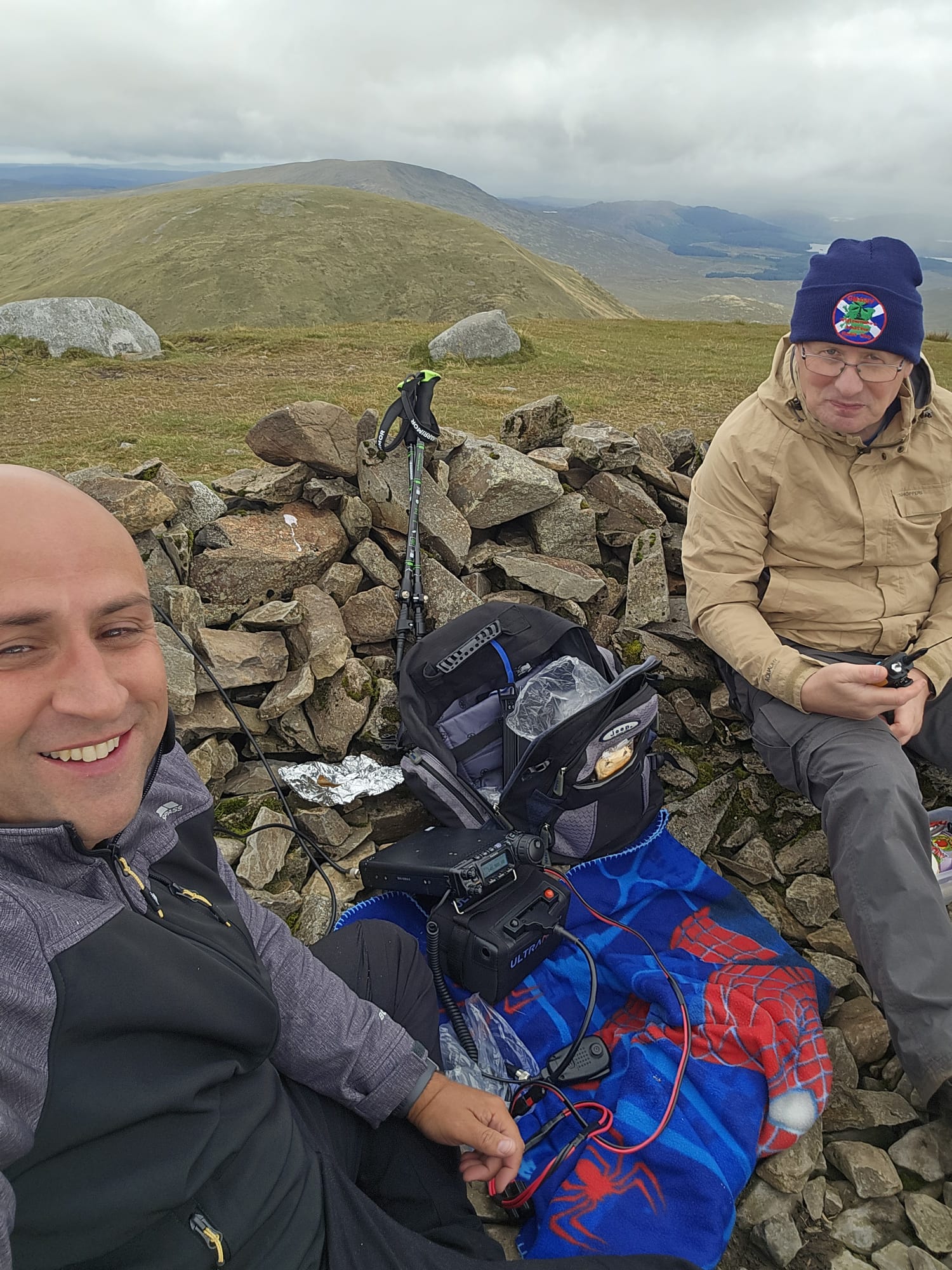

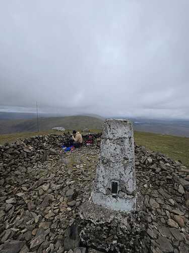

Started off sharpish around 7.45am with the climb up taking around 2h15. Not too bad for an overweight truck driver.. ;-).. The initial setup, taking no more that 5 mins saw myself & George on air raqcking up 36 QSOs on VHF along picking up S2S with G1JKS/P. My partner in crime today was George, GM0UEJ from Girvan, whose been licenced for 30+ years, yet has hardly ever lifted a mic to make any QSO’s, apparently he’s more of a CW man..
Once VHF had went a tad quiet, we QSY’d to HF and I think the “CAR CRASH” noise of a pile up was enough for George to say “Nah, that’ll do me”… SOmething about VHF that is slow and relaxed, where as HF, certainly activating, can be somewhat daunting and very contest style. ANyways, I managed to rack up a further 66 QSO’s on 20m alone before we called it a day. Near 4 hours playing radio on top of The Merrick and was near time to call the back of 2pm. 10 mins had antenna pulled down, few pictures taken and worked out way back down. Completely different type of difficulty coming down, certainly far from easy.
