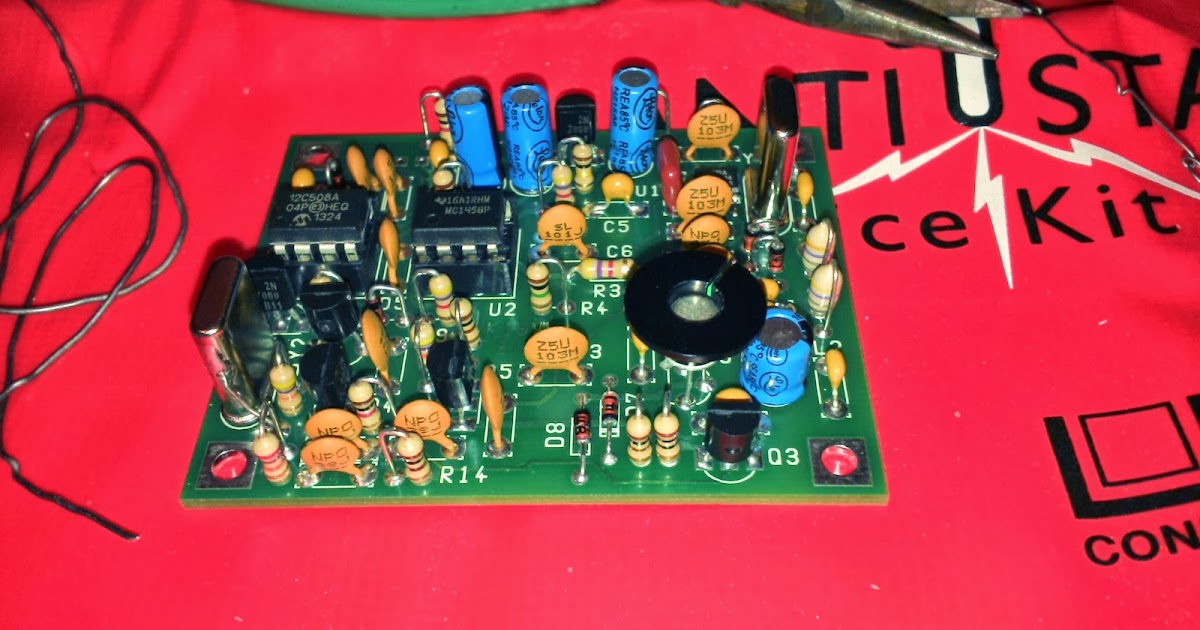

Gangue,
The new Rockmite ] printed circuit boards landed here in Limerick on Black Friday as promised by the pcb FAB house. The first unit has been successfully assembled using the new documentation and completed without any problems arising. The unit completed successful ā€˜first electrons’ turn on without any smoke leaking out of the components. Testing was completed and met expectations. A new kit is born!
Improvements over the original design include:
SA612 mixer is now a through hole part instead of surface mount.
Additional on board low pass filter components meet current FCC regs.
Additional grounded pads for easier connections to external parts.
Crystal sockets included with middle pin grounded for easy crystal swapping.
80m, 40m, 30m and 20m kits available.
External connectors, plugs and jacks supplied with kit…no more scrounging for parts. Just supply an enclosure of choice.
Introductory price of $40 including 2 PAIRS of crystals!
I have a couple last minute components arriving on the BIG brown truck later today and will be mailing out a bunch of Rockmite ] kits on Thursday!
Link to the 40m kit & documentation:
http://qrpme.com/?p=product&id=RM4
Merry Soldering!
Rex
