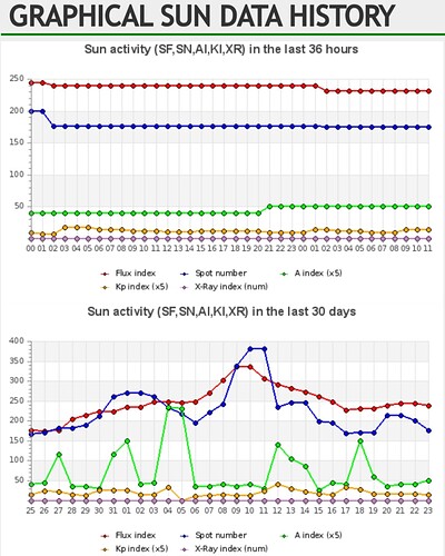

Do you ever look at solar data? It looks like the K index was high all day yesterday. 20m was poor when I was out on Tuesday evening, but 40m was fine. Have you explored other bands?
solar charts from HF Propagation on QRZCQ - The database for radio hams

I’ve never looked at data before heading out to do an activation. I think a quick glance at the data you’ve shared and a look at the maximum usable frequency may be a good shout.

I found conditions were pretty poor on HF yesterday. I only got one contact on 10m FT8 and was using 40W. Pskreporter showed some spots but not as many as last week at a similar time

Thursday is my usual activation day and I normally have no problem qualifying on HF CW. However I do find afternoons quieter although 20m is a good choice for that time. You may have just been unlucky with a solar flare or geomagnetic storm which are very common at the moment.
