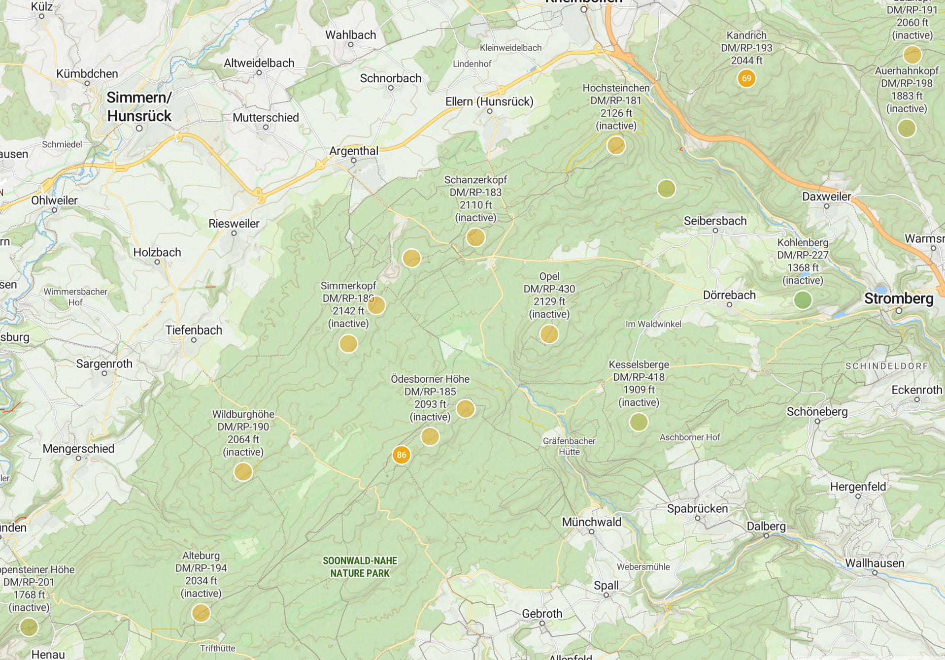

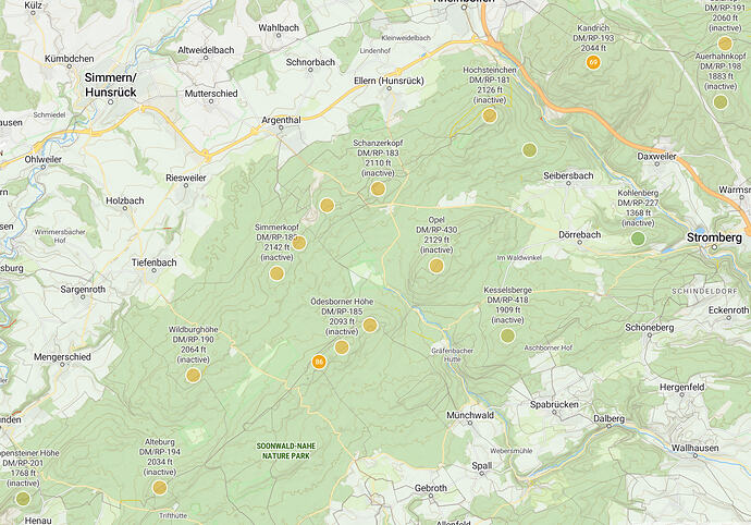

I noticed one of the peaks I activated in 2024 is now listed as inactive (DM/RP-180). I looked around at the area and many of the peaks are also listed as inactive. I assume this is just a glitch or database maintenance issue?

Thanks for the responses. I just looked at that area and there are many summits listed as inactive. The map wasn’t that way in October 2024.
I am not to worried about it since it is 6 points for me. I think other SOTA people that operate in that area might be impacted more.

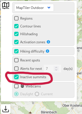

Most likely you didn’t have “Inactive summits” selected then.
Thanks. I meant to show just RP-180. I should have proof read my post before hitting send.

As Andy already wrote: You also selected the inactive summits to display.
