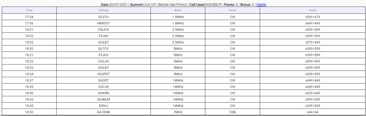

@DL3TU was a first chaser with a log on 1.835-cw, 599 and I received 479! qrb abt 500km
The second and last qso were with @HB9DOT, it was little bit difficult because his signal was weak, qrb 100km, NVIS qso!!
I qsy on 80mt cw, also on this band I received nice signal reports from chasers @F5LKW, @F5JKK and @IK2LEY.
On 60mt I managed a little pileup.
When I found a place with network I sent a selfspot on 40ssb, but I didn’t work any station…
At the onset of grayzone I switched on 20cw, also on this band the european chasers there have been and also a transatlantic qso has come. Many thanks @W4KRN for DX.
I returned in 40 ssb and I completed only one qso with @EA1DHB
