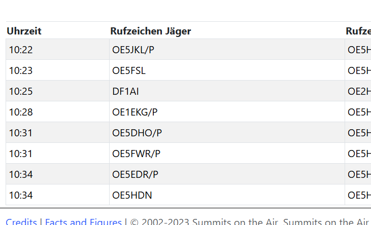

I think that if you upload a temporary log for the activation with just one QSO entry then you will be able to view the log and use the “See who chased me” button to see who you worked.
Hopefully at least 4 chasers will have uploaded logs.
You can then delete the temporary log and replace it with the real one.

This is better than nothing, but this technique only works for contacts uploaded by chasers. And some chasers do not upload contacts immediately. It can take weeks before some uploads. Not even talking about contacts made with non sota operators, which are nowhere to be found.
The only thing i cant restore are the summits to summits points. 3 stations i remember was also on summits… But maybe with some search on the hunter calls… maybe :slight_smile:
You can do this on sotl.as
For example your contact with OE5DHO/P was a summit to summit with OE/OO-246.
thanks, i did modify my log and now all summit2summit also correct.
