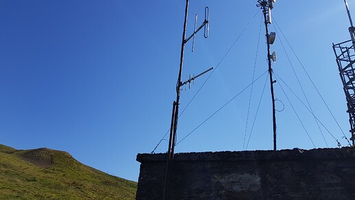

Because the site is just below the summit of Great Dun Fell the Digipeater uses a 3 element vertically polarised Yagi, which produces some gain in useful directions and avoids warming up the hillside behind with RF. You can see the Digipeater antenna here, below the GB3EV 2m antenna

Remarkable! My biggest concern was that G3WGV-11 would be rather deaf due to the noisy RF environment on GDF but it seems that my hi-Q filter design is doing its job filtering the crud out.
