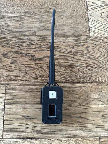

I have just found an old rubber duck hand held antenna - these can’t be that bad, they must be better than the stub supplied??
As long as they cover 70cm, then yes.
I’ve just tested my new antenna on the nanoVNA and at 439MHz SWR is around 1.5, much better than the 5 with the supplied stub.
Yes, obviously it’s from a 2/70 hand held.
Better than the stock stubby - yes. But not necessarily particularly good. Dave JKS and I have both tested quite a lot of these on network analysers and, in general, the dual band ones are optimised for 2m and they are poor at 440 MHz.
The antenna that I have recommended is a single band antenna that has a good VSWR at 440 MHz. It not a miracle antenna but gives solid performance at 440 MHz.

The Nagoya N771 type antenna is pretty poor at 439.9125MHz; really optimised to for 144MHz.
The antenna that comes with most LoRA boards also doesn’t appear that good up at 440MHz.
The best antenna I’ve come across for use with LoRA at the UK allocated frequency of 439.912MHz is the TX433-BLG-40
Which now seems to be available from Amazon:
https://www.amazon.co.uk/Outdoor-Waterproof-Fiberglass-TX433-BLG-40-Omnidirectional/dp/B0CNGNGKQD
Although there is some variability (1.7 to 1.2) at 440MHz so I tend to buy 5 at a time, test them and send back any that are wildly out. They’re generally excellent (VSWR) at the EU LoRA frequency 433.775MHz. Admittedly, they a tad unwieldy to attach to a tracker, so I’ve also ordered a couple RF Solutions FLEXI-SMA-433 on Richard’s recommendation - to give them a test. I ordered four from CPC (as delivery is free over £20) so I can compare.
