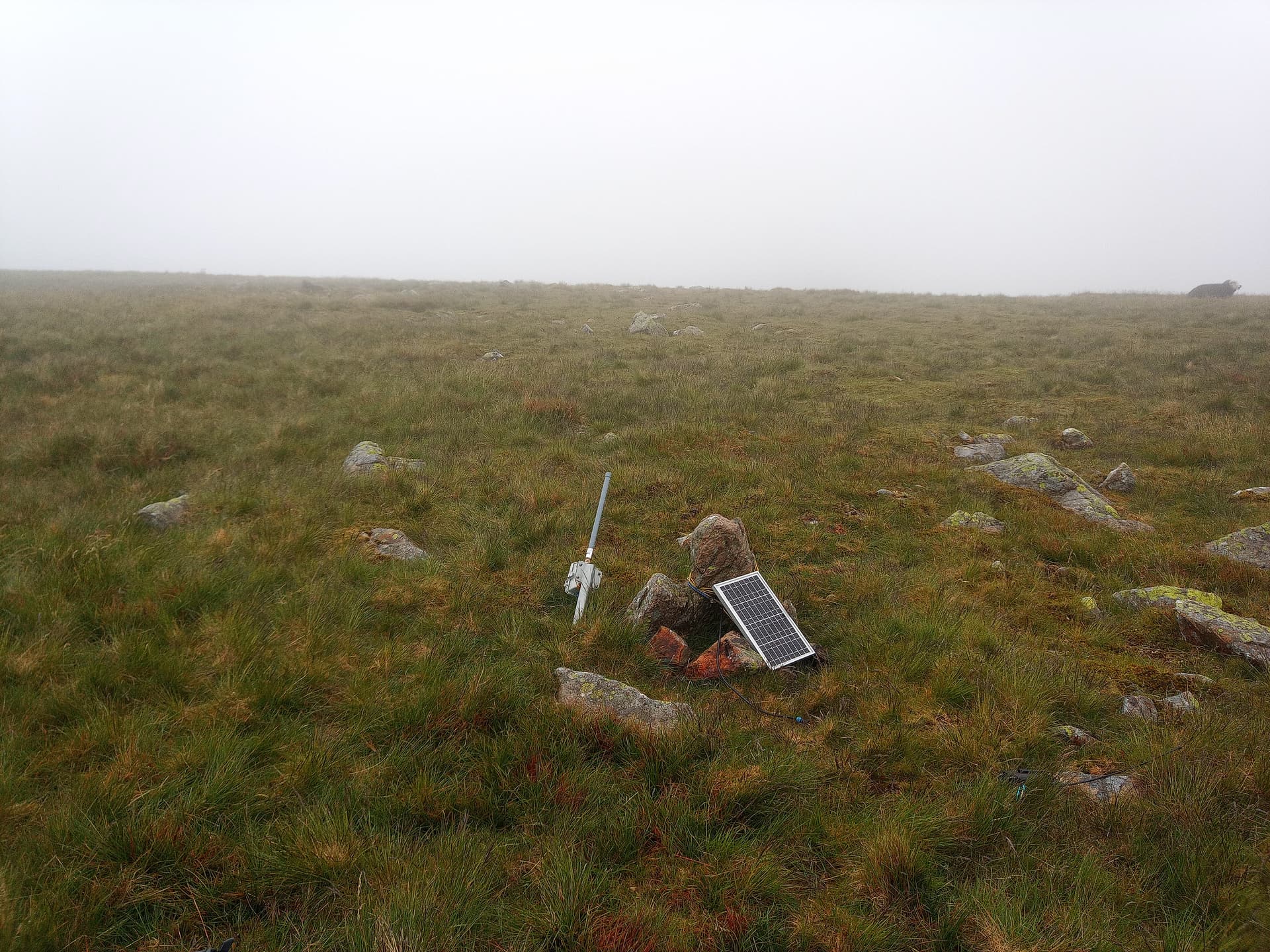

I’ve just been up Seatallan (G/LD-025) to check on the LoRa digipeater M0MZB-15. The digipeater went off air a couple of weeks ago.
I was pleased to find all tbe equipment still present. The plastic threaded fastening on the waterproof solar panel connector had cracked, and the cable had become disconnected
I didn’t have a spare connector with me…I had not really expected to find the equipment requiring only such a minor repair.
I have brought all the equipment home, and will be inspecting for any other damage.
The digipeater will be back on air, returned to its summit location, in a few weeks.
I was thinking about your digipeater only this morning while browsing the APRS map. Glad to hear it is all still there and only a small repair required!

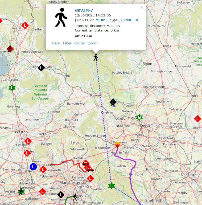

However, today I walked up a hill for an activation attempt (very flat bands and only 5w…) but the tracker reached 80km away for the highest portion of the walk. It bought some success to the day which was great.

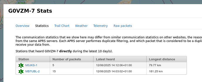

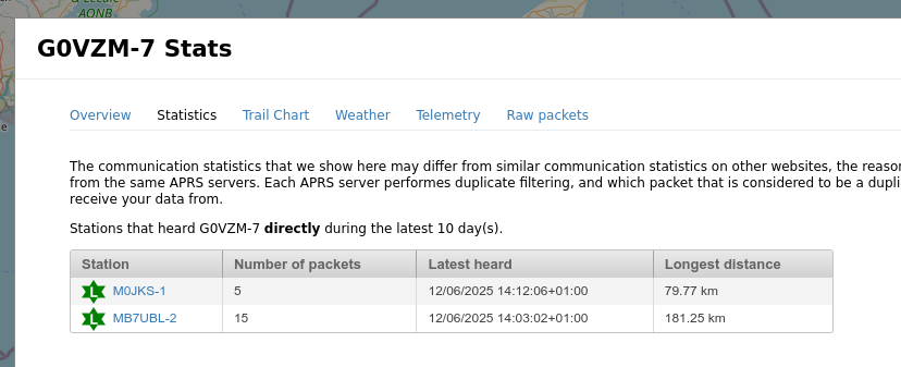

If you use the following LoRa APRS tracking site, and select “Trail Length” of 12 hours:
http://lora-aprsdirect.sarimesh.net/?center=54.1659,-1.9925&zoom=14
You will see your tracker was mainly being picked up by the Digipeater (M0JKS-1) on Kinder Scout; but also numerous times by MB7UBL-2 on Arenig Fawr (GW/NW-011) - in Snowdonia. That was a distance of 180km.
I only installed MB7UBL-2 on Arenig Fawr yesterday. So thank you for helping to prove it’s working perfectly!
