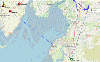

Walking the other (more sensible) dog on my nearest and dearest local summits (Arnside Knott G/LD-058 yesterday and Hutton Roof Crags G/LD-052 today) with LoRa tracker, the post-walk apr.fi map analysis [looking at where each tracker packet was routed] shows the advantage of having a number of iGates at different locations in the area as the walker moves between different line-of-sight (or near LoS) RF paths or even ones reflected off the hills.
We are already well served by iGates in the south of the county. For example, today’s G/LD-052 walk involved 3 iGates (G8CPZ-10, M0RBE-10, M5TUE-10) in south Cumbria and one digipeater (MB7ULU-2) in north Lancashire (Lancaster University).
LoRa APRS coverage for G/LD-052 walk-in
Coverage is poor in north Cumbria at least from the M6 around Carlisle and probably to the west. How well it is on those northern summits is still an unknown. Tracker-based activations needed.
