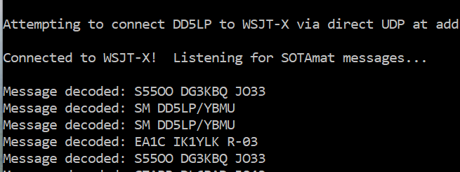

It didn’t bring up the firewall question with me Brian.
It did have the usual warnings where one has to keep / run anyway etc. that come from any App that hasn’t paid for a Microsoft key as far as I understand it.
In my case, in the debug display, my callsign did not come up - but I think this could be a webSDR issue - so let me set up my private “on-air” scenario with two rigs tomorrow and see if that works. If it does, then we’re close.
73 Ed DD5LP.

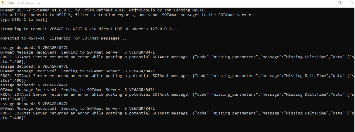

I agree that the presence or absence of the -d command should have nothing to do with it. Latest try on 6m I once again got clean decodes on WSJT-X and the skimmer recognized it as a SOTAMat message, but the server returned a failure code about a missing paramater, “missing delta time” - screenshot attached. Same thing happened when I used the computer mic as the input source rather than RF. Now I’m confused. never saw this on previous failed spot tests … does this just mean my phone has wandered too far out of time sync? (The computer should be bang on, I’m using Dimension 4.)
Hi Ken,
On my (Android) phone I use the ClockSync App which tells me how far off I am and then I give that value (rounded) e.g -0.4 using the “FT8 device time correction” slider in the lower part of the settings page of SOTAmÄt.
The Gotchya can be that once you have set this value, it sticks and the next time, you use SOTAMÄT your phone might be off by +0.7s - and if you don’t correct the value in settings - you could be off (in this example) by 1.1s and that will give issues.
The error message you are getting sounds like there is no correction set - which in itself should not be an issue but I guess the logic has somehow realised you are off-sync.
73 Ed.

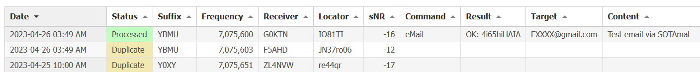

After my previously successful test, by using two HF radios and sending a test spot, yesterday evening, I gave it another try.
This time, I tested it by using a WebSDR along with a virtual audio device and sending out a predefined email message.
Short version: It was working!
The longer version: This time it wasn’t that quick 'n easy, I needed several attempts.
I don’t think it’s software related at all, but because of the current (bad) propagation.
The WebSDR I used for my experiments was Twente, which is about 520 km away from my home QTH and one of the most used in Europe.
First I tried it on 40m, where my signal was decoded by other stations, but not received in Twente. Today, looking at the archive of PropQuest, I think I know why it didn’t work on 40m. I suspect the pretty low F2@500km MUF of about 6.5 MHz at this time was the culprit. The MUF was measured at Dourbes, which is somewhere between my QTH and Twente, so it should be pretty accurate.
After two unsuccessful attempts (separated by more than 15 Minutes), I gave 80m a try and this seemed to do the trick, albeit only with an SNR of -16dB (see above). Moreover, I was only decoded once out of four redundant FT8 transmissions. Of course, my compromised antenna also plays an important role.
As noted by others, this WSJT-X plugin solution is extremely quick, compared by using the PSK Reporter route (that may take up to five minutes alone), it’s almost instantaneously.
BTW: Because of this (sometimes) long PSK Reporter delays, last Saturday I was spotted at the same time on the same 20m frequency as another activator. Such conflicts are seldom but they can happen, especially if the time from sending the spot until it is distributed takes some time.
Conclusion: Two of two tests using this WSJT-X plugin worked, both with different setups. I call that a success! Moreover, it’s not always the software fault when something doesn’t work as expected.

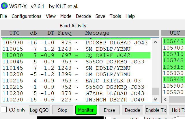

Update from here, is that I have the email feature working but not yet via my skimmer:
I have tried using the QRP radio into a dummy load and the home station receiving directly - although I can hear myself fine on the IC7300 when using the G106 - what is being sent is not being decoded by my instance of WSJT-x. Putting the G106 onto the main antenna and the IC-7300 onto another antenna just for receive - I still don’t decode my own signal (however someone else does do).
Apart from the UDP settings, is there anything else to change in WSJTx? I am using version 2.6.1.
I’m going to turn the timing correction off in the Sotamät app to see if that is part of my problem.
Ed.
UPDATE:
Now working to WSJTx
and decoded by the skimmer:
But its still other stations who are posting the reception back to the SOTAMAT server -
No errors shown from the skimmer but also no message to say it has transferred anything - should it give some kind of message in debug mode when it transfers a received SOTAMÄT FT8 transmission direct to the SOTAMAT server?
