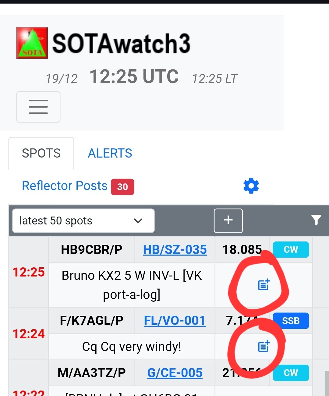

I also do a wee bit of chasing. I just log each contact as it comes, by pressing some buttons on SOTAwatch3 (android phone).

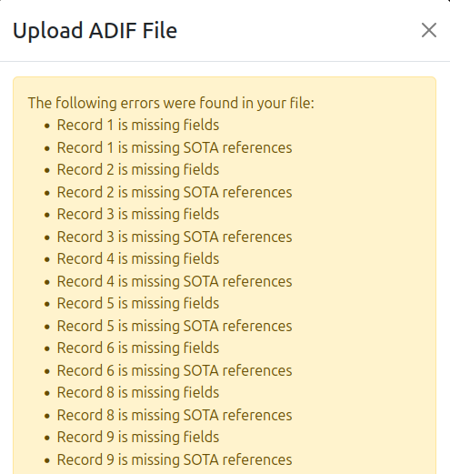

Looks like I need to filter my ADIF log file before import to only include SOTA contacts. My home log only currently contains 68 contacts since I started logging with qlog:
This appears to halt the export. I’m sure I won’t have a problem filtering the log, this is just for information.
There is no < SOTA_REF> or <MY_SOTA_REF> in your ADIF file for those records. And yes, if they are not SOTA QSOs it will error if you include them.

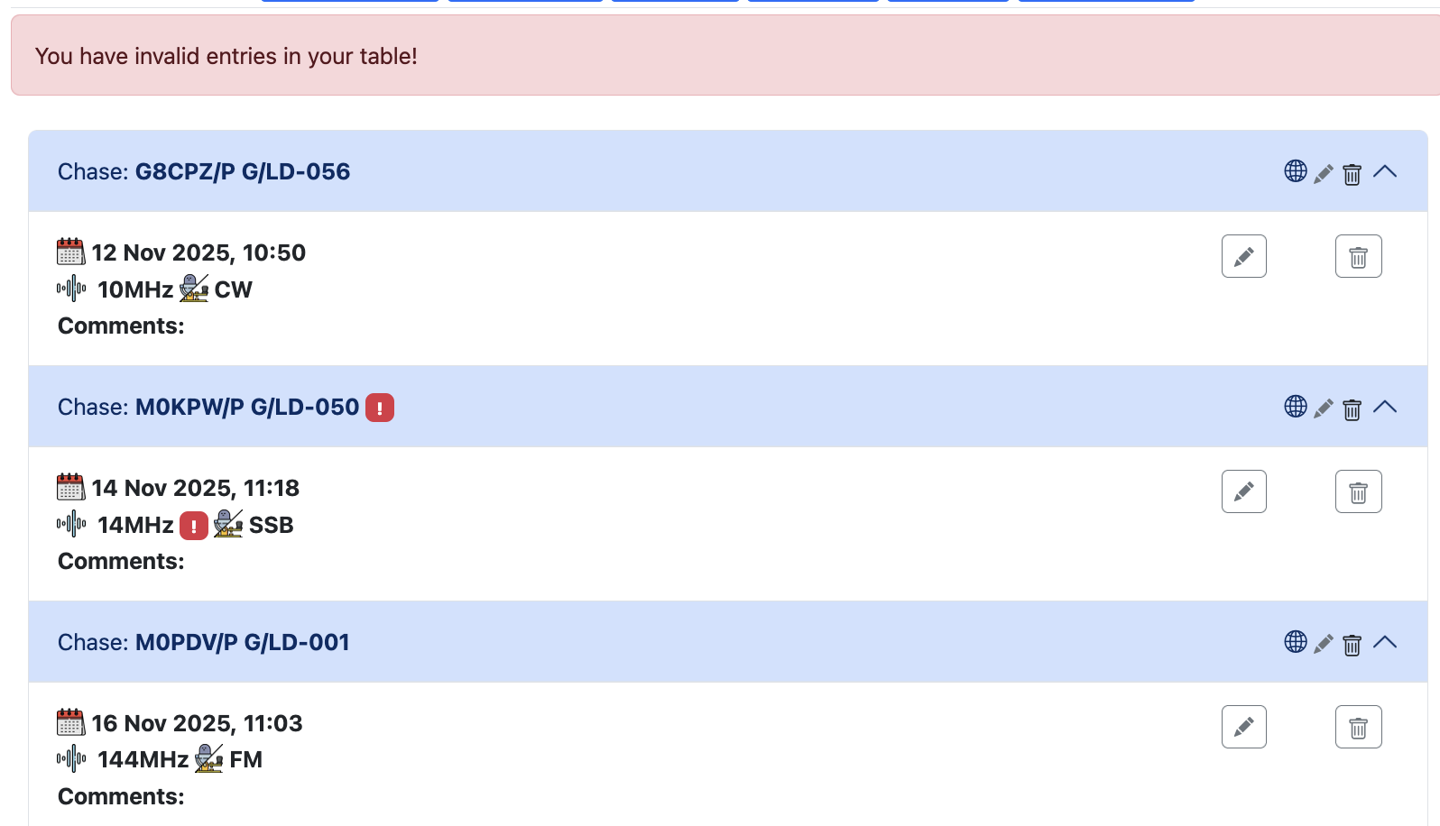

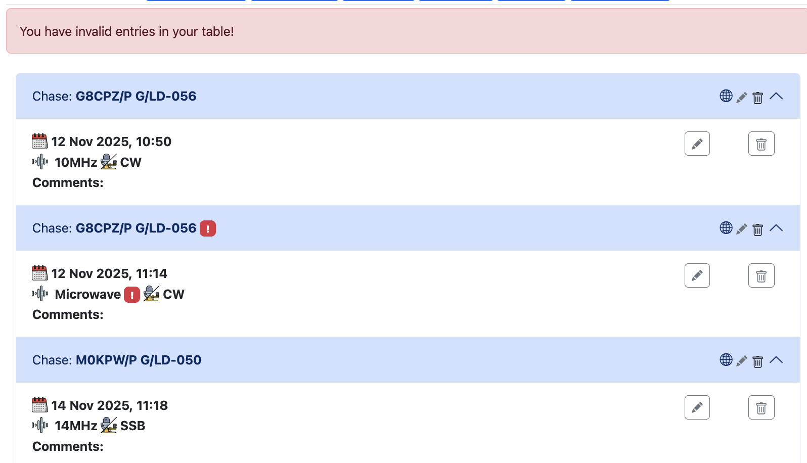

OK, so over that hurdle, and indeed it does now present me with a list of contacts. However, for some reason I’m getting an Invalid Band error on my contact with Chris on Gummer’s How.
I can’t seen anything inherently wrong here, but I must be missing something?

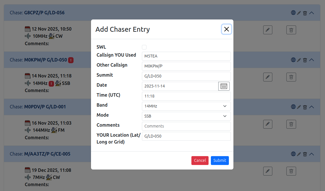

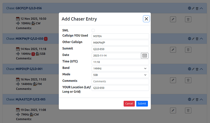

Hi Mark,
Could it be that your “YOUR location” field is wrong? You have the SOTA reference in it, in the first picture, when it should be either a Maidenhead locator or Lat/Long entry.
73 Ed DD5LP.

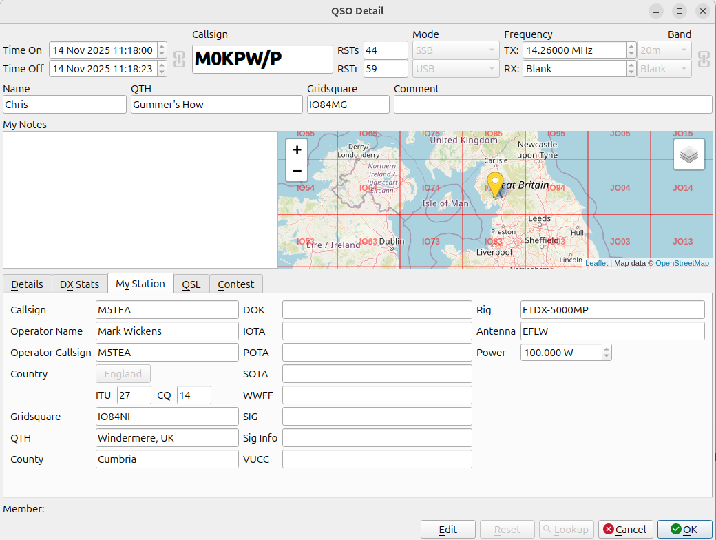

Hi Ed,

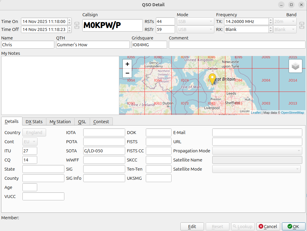

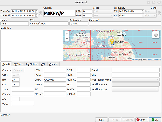

Interesting I hadn’t spotted that. Looking at the source ADIF entry, my location is specified as a 6-character Maidenhead:
<my_gridsquare:6>IO84NI
There is no entry for MY_SOTA in the ADIF file. We are very close, according to the qlog distance calculator 10.728 kms, however the gridsquare of G/LD-050 is different:
<gridsquare:6>IO84MG

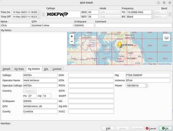

Looking at the second screenshot you can see that MY_SOTA isn’t populated.
Regards, Mark.
I think this is similar to an error I was seeing yesterday. When going into edit chaser (SWL in my case) on the Sota database, the Location field had become populated with the summit reference.
I know a fix was done early today on other stuff that was happening, maybe this one sneaked through.

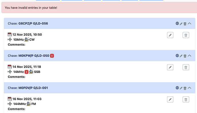

I tried with the full entry, something I should have done first. No errors shown. The error on the screen may have been from a previous import.
Yes, good spot, you are right. The bug happens if I delete an erroneous record.
So once imported and verified I get:
If I then delete the G8CPZ/P record with the error, the error skips incorrectly to the next record in the log:
Just for reference, in case there is an issue recreating the error, the contact with G8CPZ/P had the following error in the ADIF file:
<band:4>oob!
OK, one bug that needs fixing.
This is a feature, rather than a bug (although the populating of it during editing for @G7ADF is a bug, it appears). You can enter Lat/Long, Gridsquare, POTA or WWFF reference in the location field of either a chase or an activation QSO during the upload phase and it will autopopulate that with correct lat/long during the upload process.
