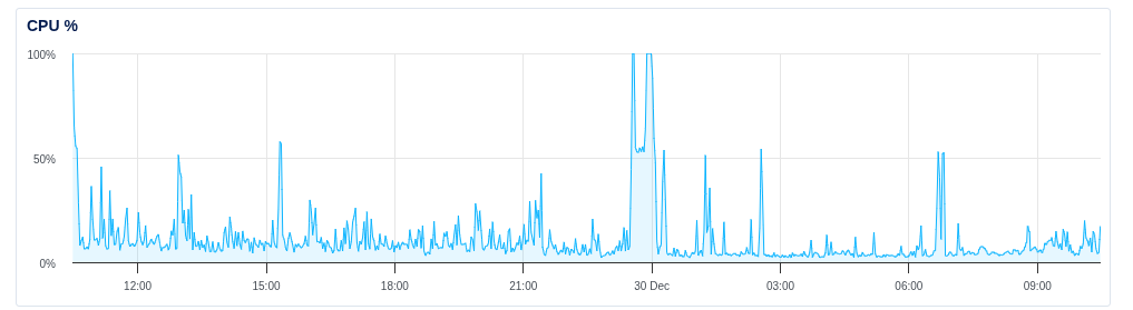

Here is a graph of the DB CPU load over the last 24hours… you can see when the “sub-optimal” queries were running :wink:
There are probably more queries like the one that was fixed in the code. There’s no point wasting time improving them when more important stuff is needed. Once they become an issue, then we fix them.
