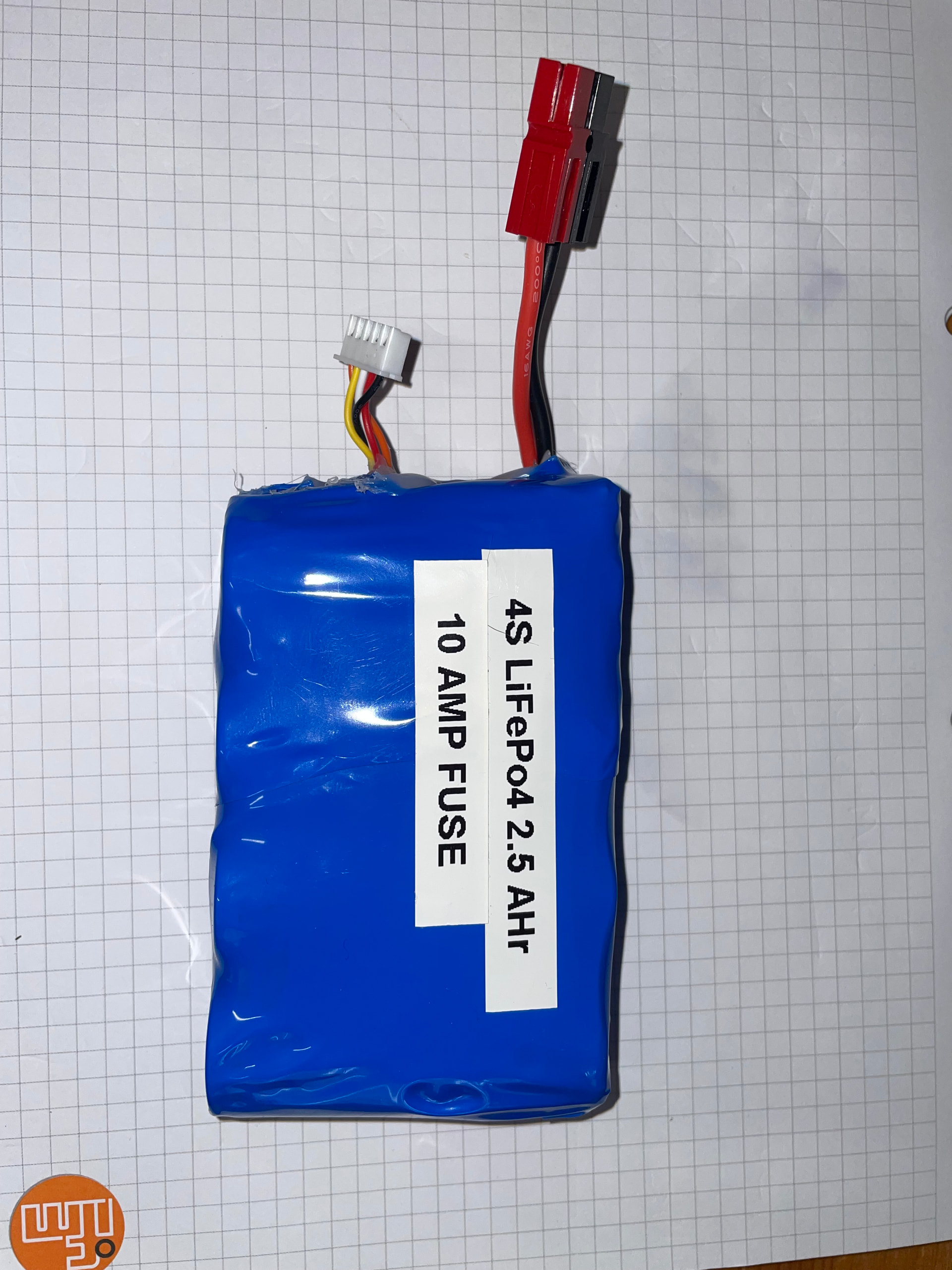

I build lots of packs up mainly to show others what can be achieved. With LiFePo cells, I bought some secondhand 26650 cells (ex vehicle) that were nominally 2500mAhr but were down to 2300mAhr. They work as expected for low current use (KX2 etc.) but being designed for vehicles can provide 50A without distress but not for long of course! I have some myself, the rest went on to locals in the Edinburgh area.
You can buy dual 26650 holders from AliExpress and these photo shows a number of homebrew “proof of concepts”
LifePo cells, Hobbyking, Eremit and 4x26650 with 2x holders on a piece of stripboard. (AA for scale)
LiPo: 3x21700 (green), 3x 18650 (lilac), 3S2P ex-vape and AA. The 18650 holder shows 2 cells and a piece of ribbon used to make removing cells easier. The ex-vape pack is so light, it’s the backup KX2 supply and will run it at 8W or so for an hour.
All the holders and balance leads (JST-XH to wires, 4x and 5x) came from AliExpress. Charging done with an Imax B6AC at home.
