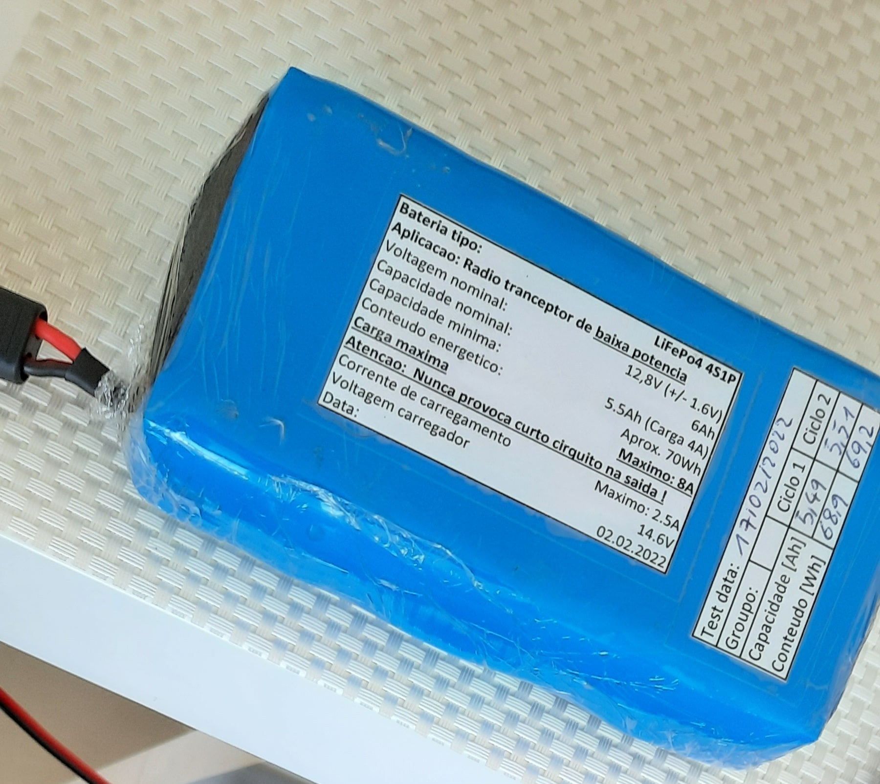

I buy from hobbyking, they have a selection of 2s packs, such as :
https://hobbyking.com/fr_fr/turnigy-nano-tech-2100mah-2s1p-20-40c-lifepo4-receiver-pack.html
https://hobbyking.com/fr_fr/turnigy-nano-tech-850mah-2s-12c-lifepo4-transmitter-receiver-pack-w-jr-s-type-connector.html
Easy to make a 4s 13.2V from them
However, I still use my lipo’s because I have them in various sizes (and they are lighter compared to lifepo4).
Lead-acid batteries and LiFePO4 batteries are not directly comparable. The voltage of a LiFePO4 battery only drops significantly at the very end of its capacity. Therefore, more of its capacity can be used compared to lead-acid batteries.
I would recommend buying a 4S LiFePO4 battery with a BMS. Connecting two 2S batteries in series will result in the loss of some protection. Connecting them in parallel is usually not a problem.

What do you mean ? 2x2S or 1x4S is the same, it’s 4 cells in series. The BMS is not really needed if you think about unplugging your battery pack after an actviation (no over-discharge protection). Then for charging I use a balanced charger, so no need for a BMS, or ?
I was only considering weight savings for the same capacity. LiFePO batteries certainly also have higher efficiency compared to lead-acid ones.
I’m thinking of buying them with a rigid casing and Faston connectors. I didn’t think it was possible to connect them in parallel. I prefer to use them as they are sold, without wiring them in series or parallel.
I assume that LiFePO batteries don’t have a storage voltage like LiPo batteries and don’t suffer by memory effect, so there shouldn’t be issues with storage voltage or leaving them below full charge for a long time. I also wonder whether it’s good practice to keep them a store when fully charged.
