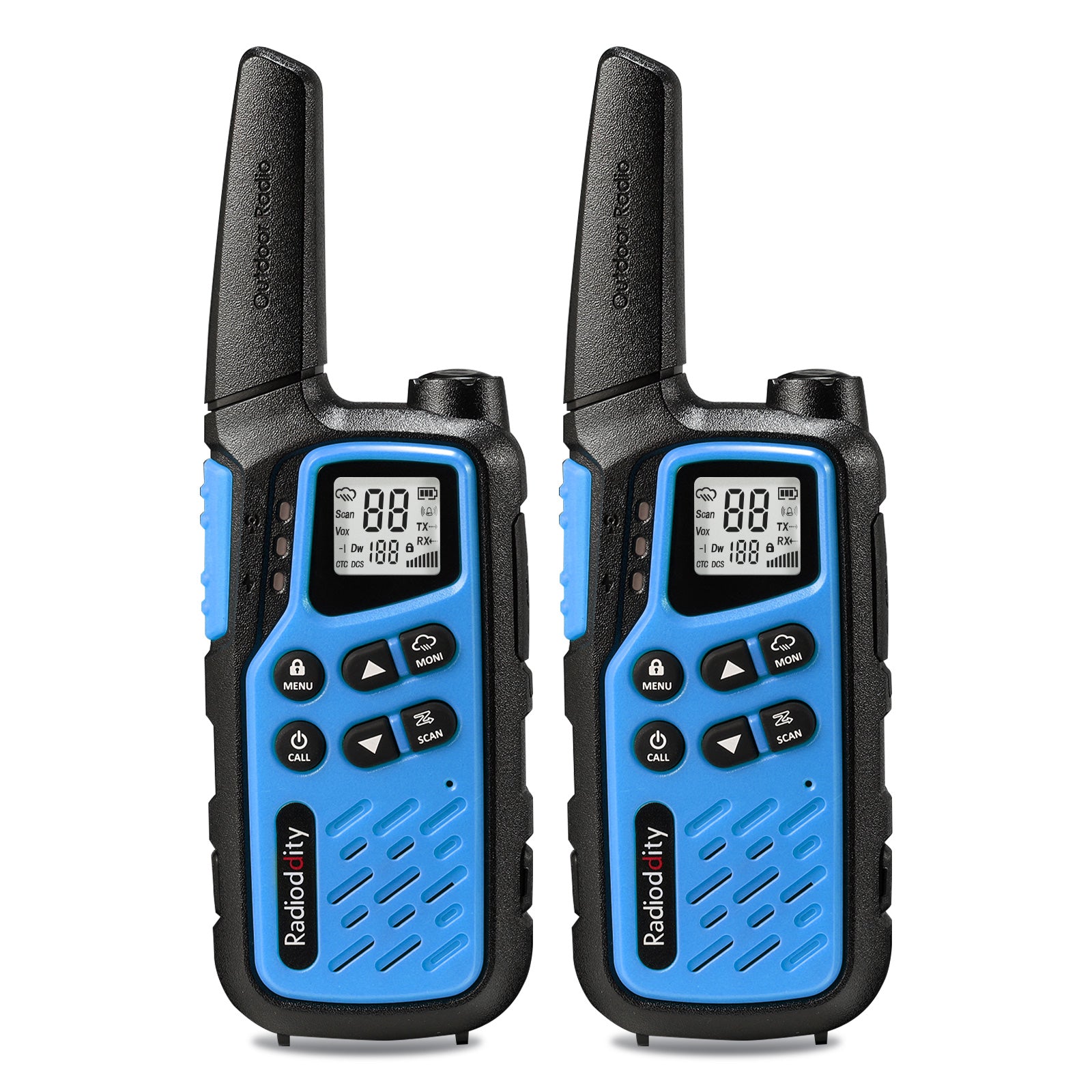

I suppose FRS is the easy and inexpensive route. I’ve got an old Motorola set but here is a modern example:
The “privacy codes” don’t provide privacy from others hearing you; they’re more to reduce nuisance interference when receiving.
