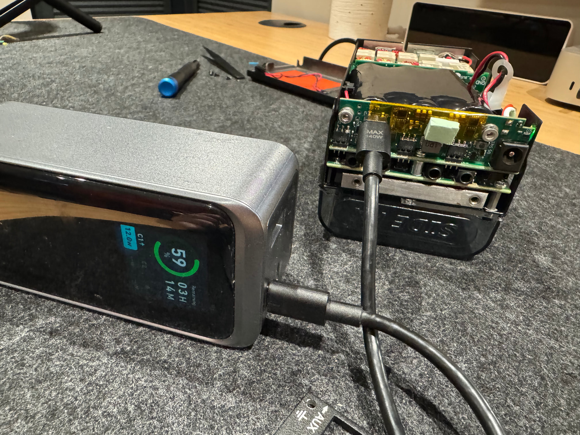

KXUSBC2 boards have arrived here in Durham I’ll be putting the first one together this evening and may attempt an installation video into my KX2.

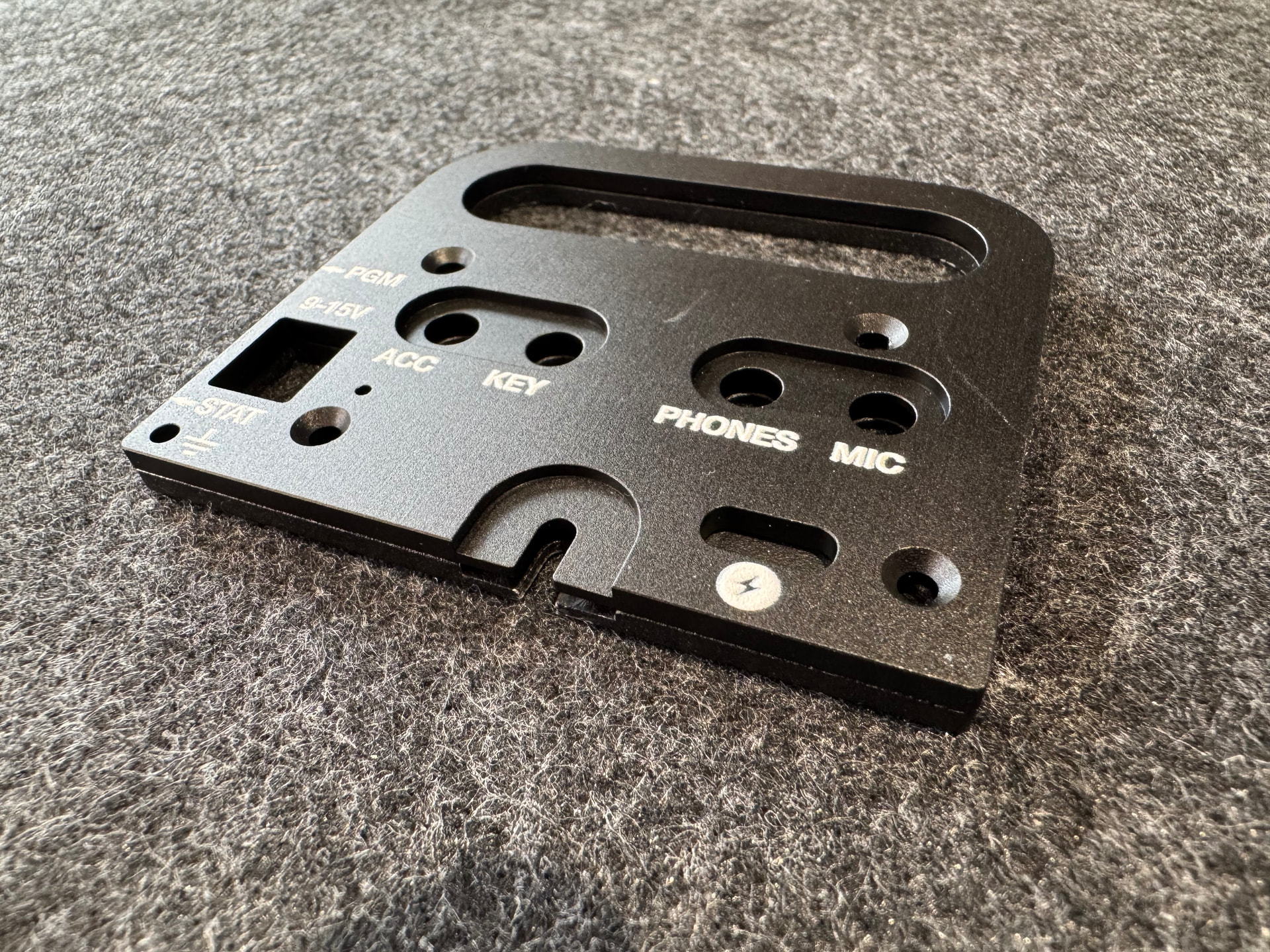

While I wait for the panels to arrive (UPS now say “Due to operating conditions, your package may be delayed.”), I took the chance to solder the remaining components on the board and flash it (this will be performed on each prior to dispatch). Thanks to @HB9DQM’s excellent documentation that took next to no time.

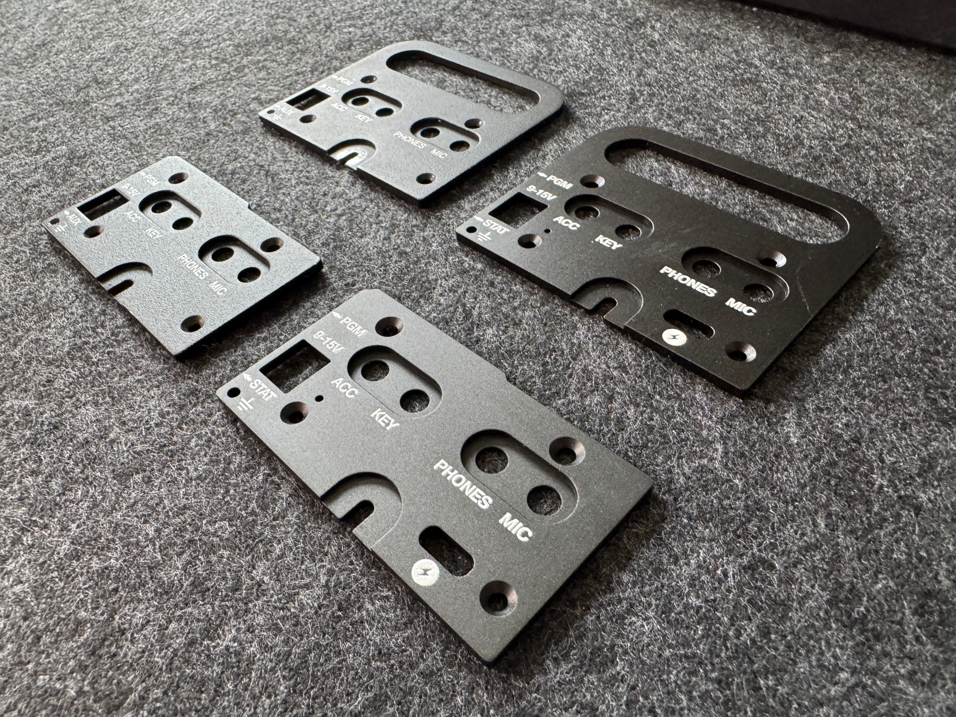

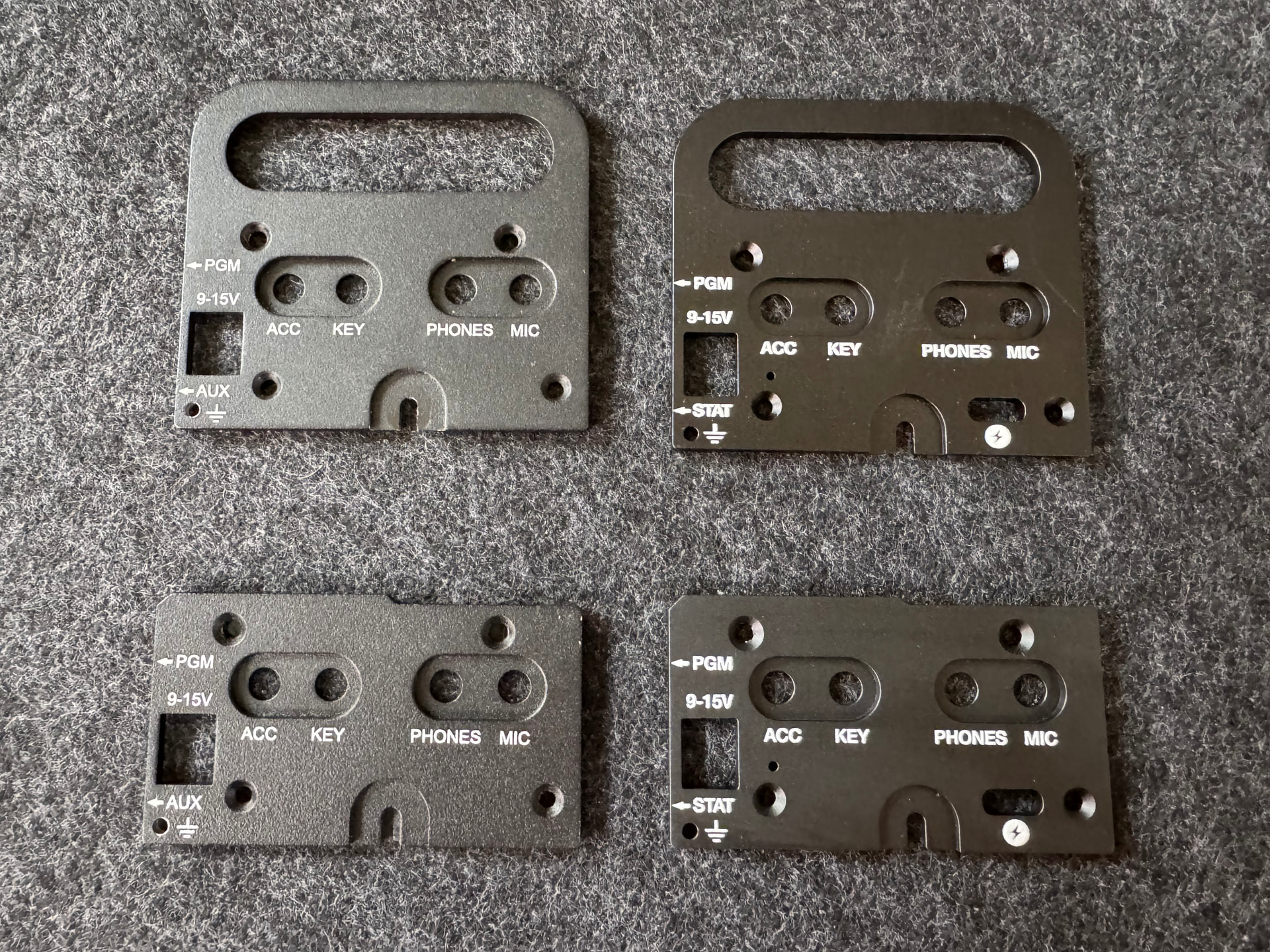

I’m about to order a KXUSBC2 from G7UFO and would like to take the opportunity to add side rails to my KX2. Specifically, I want to add the version from ProAudio Engineering with the integrated heatsink (this one).
Before ordering, I have a quick question: Are the dimensions of the rounded rectangular cutout in the KXUSBC2’s handle-style panel the same as those in the ProAudio Engineering side rail? I’d prefer both sides to match aesthetically.
Probably best emailing @G7UFO directly (or summon him with this @!)
I have been summoned (thanks @GM5ALX)!
I have the (non heatsink) SideKX rails here and UPS are suggesting I’ll receive the handles today. I’ll take a picture side-to-side as soon as they arrive but I believe they’ll be compatible.
Panels have arrived. No difference in size between my SideKX and the replacement panel - same with my standard ones.

Thanks @MM0EFI for showing the soldering part of the install in your video. It was the part that put me off ordering until now.

Yes! Neil @G7UFO laser etches the paint away and does the wires, standoffs and flashes the firmware.
I hope my video does it justice. I believe everyone will want this for their KX-2. It is superb! Well done Manuel @HB9DQM and to Neil also, for getting these out!
