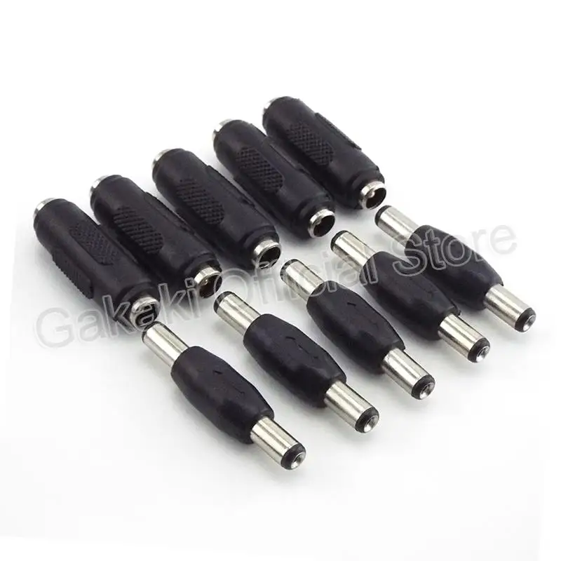

I went the very easy route and bought a 3s LiPo charger on Aliexpress and a small adapter so I don’t even have to solder the plug myself :sweat_smile: Works fine :slight_smile:
62g vs 250g for the original charger.
What adapter is that you got? I’m about to buy the same charger for my KX2 as well. Useful post, thanks all for the information.
Smashing. Thanks for that.
Found them on Amazon UK too for €5 for 3 of them. Picked up a charger though from Aliexpress that was linked above in this thread.
