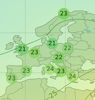

It’s easy to see why 10m is so difficult at the moment.
courtesy prop.kc2g.com 1446utc today
I didn’t check a few hours ago but I wonder if MUFs got above 28MHz at all in Europe today (except in southern Spain). MUFs were regularly above 28MHz by 1200utc back in January-March. Some of you may recall the 10m WSPR tests I did then showing a strong correlation between 10m WSPR contacts and MUFs.

It seems another world back in February when I routinely got all those N.American 10m contacts (see post 8 above). My rucksack’s all packed and I’m ready to leave in 30 minutes to re-activate Holme Fell G/LD-051 [which I did in January but was too cold to do HF so had a quick 2m FM activation]. But I’m watching the live MUF map for Europe and suspect it will be like yesterday where the MUFs don’t get up to 28MHz.
courtesy prop.kc2g.com today 0900utc
Maybe I’ll be lucky and get a few groundwave contacts. In any case, it’s a lovely day here so at least the dogs and I will enjoy the walk.
