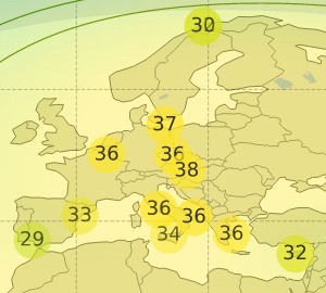

Recently I’ve been running WSPR on 10m from home at times from before dawn until evening and comparing the paths with the live MUF map, I noticed a strong correlation with daylight. It seems one needs to have a path in daylight to get very far on 10m. I bet the MUF was rising rapidly after 0800 [dawn in the UK] so that may explain your later success.
WhatsApp Image 2024-01-26 at 11.02.52_bef85cd4
This is from 1115utc. I plan to be on G/LD-046 at ~1445utc today with 10W CW hoping for 10m action.

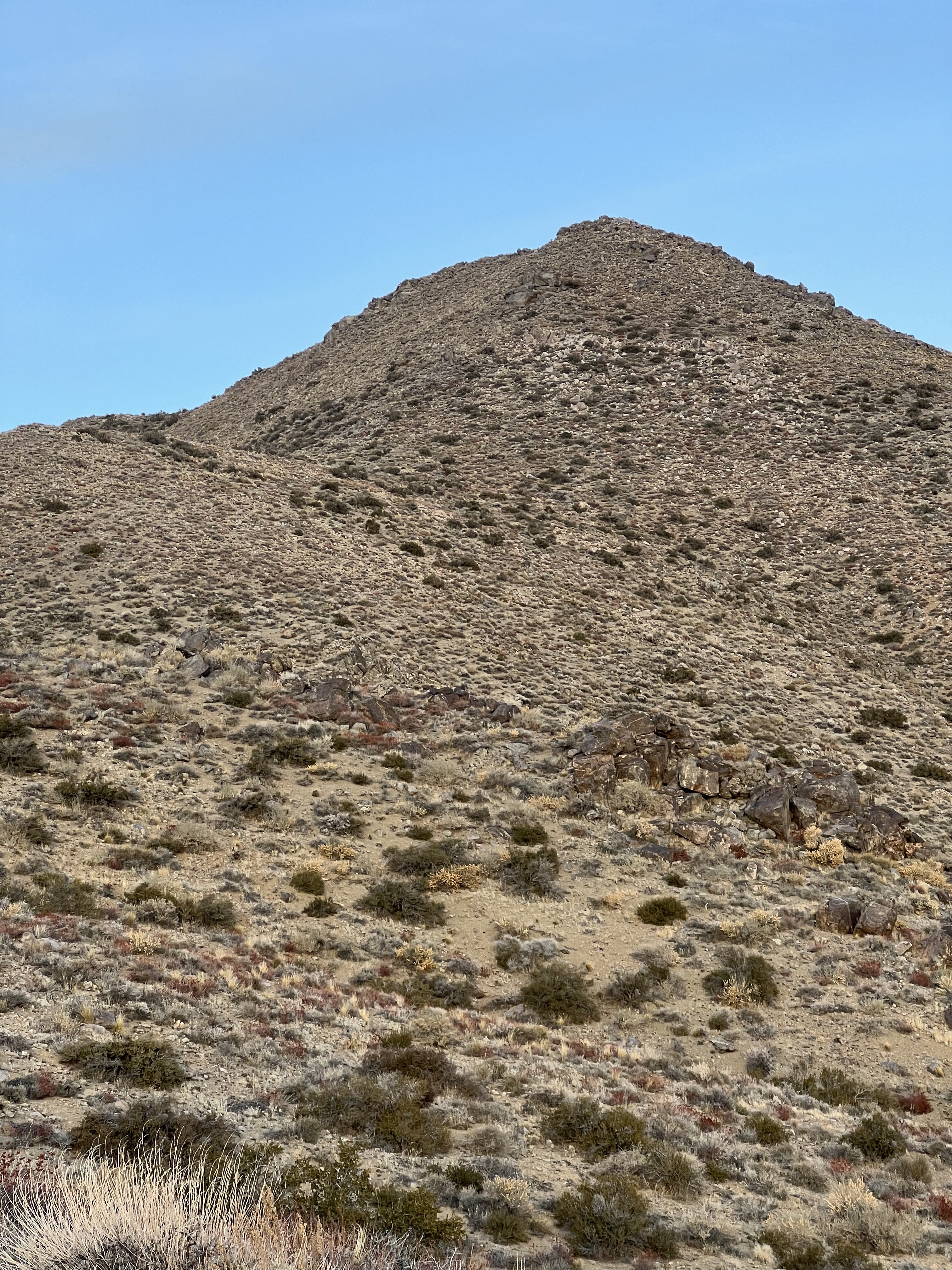

Thanks for transpacific s2s, Andrew @VK1AD! That was fun. Running about 7W on a KX2 to a 41’ random wire antenna on this end.
It was a mild winter day for us on a California desert peak:
Mike K6STR
