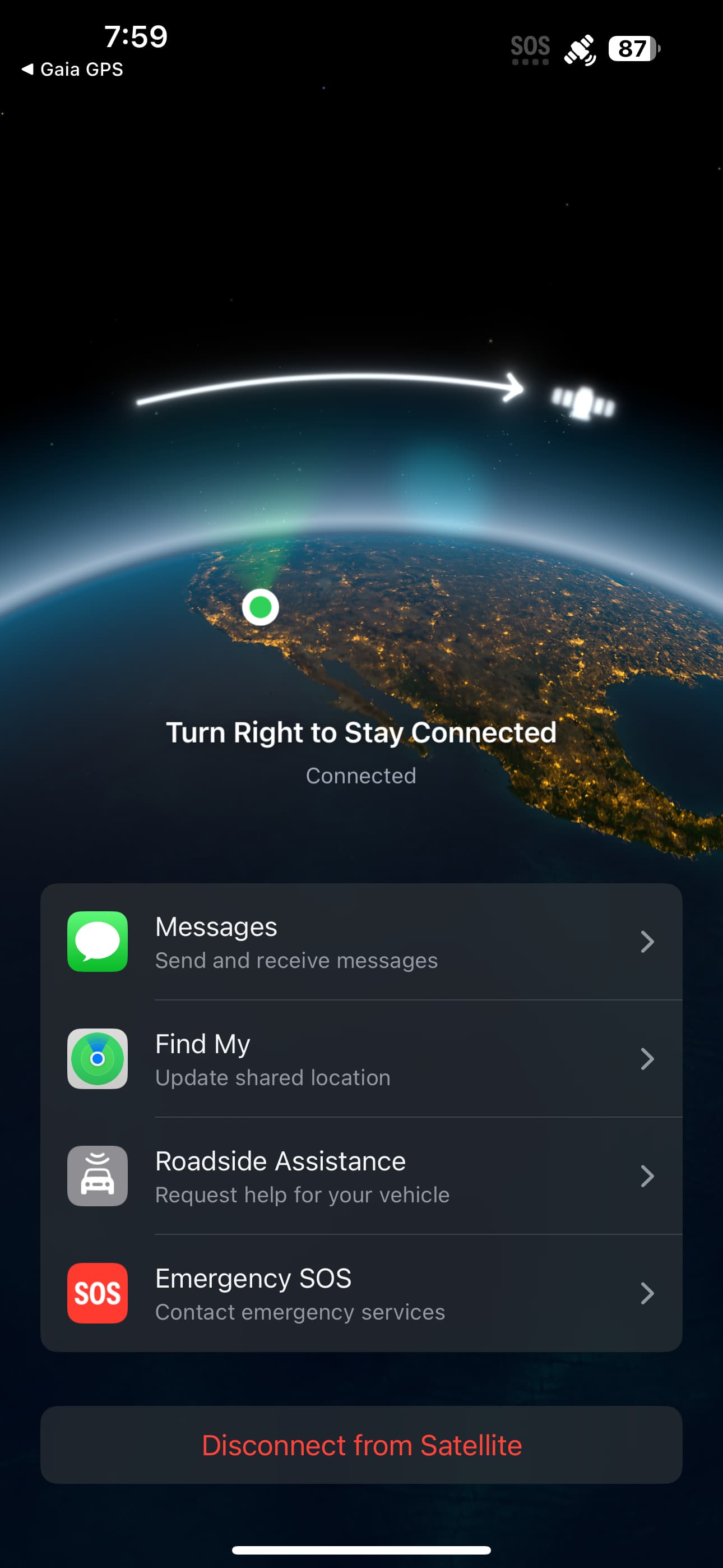

I’m back from a wander around the Eastern Sierras in California and while hiking “way off grid” to a peak or two, noticed IOS 18 on my iPhone 14 offering to connect me to a satellite. For giggles, I tried and it seemed to allow me to send a non emergency and general text.

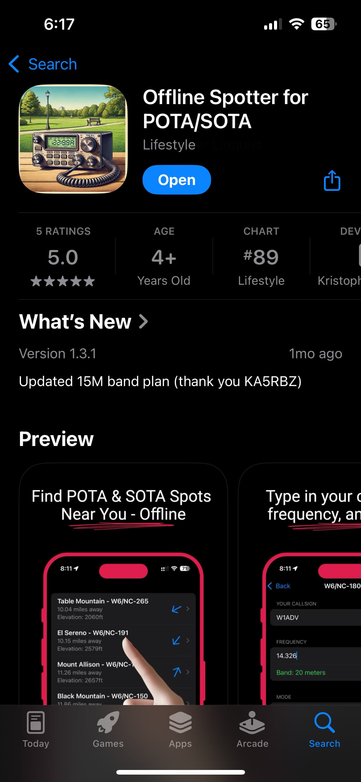

Take a look at this. It’s an app in that Apple App Store that does exactly as you are saying, spots via satellite on your phone. You download the POTA and SOTA database in the app before your trip and the rest seems really easy! I have it downloaded but my last few trips out I just set an alert.

Interesting app and I’ll check it out.

I’ve found that the iOS satellite messaging is very sketchy in areas where it’s tough to get away from tree cover, which is no big surprise.

Thanks and tree attenuation makes sense.
