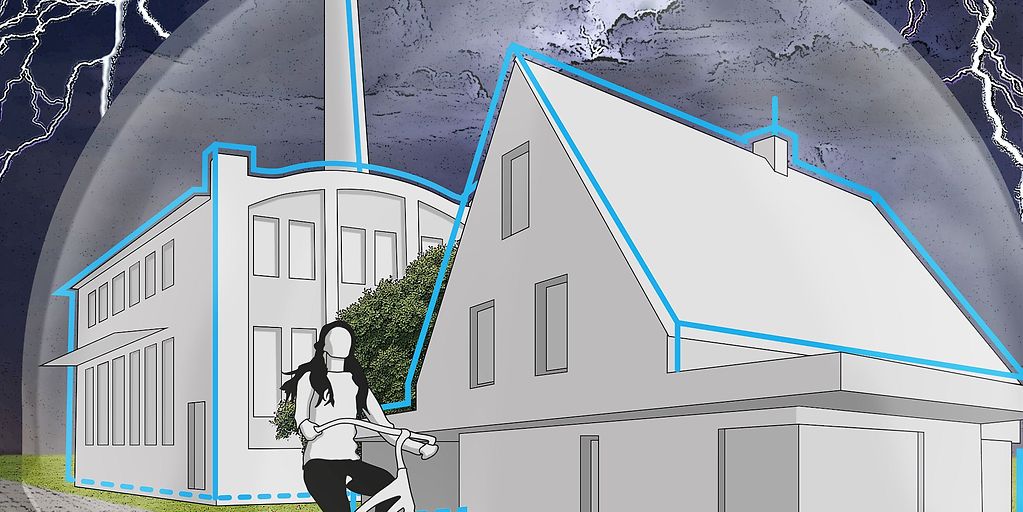

In Germany there are several classes of lightning protection. This depends on the exposure and the location.
For some applications, isolated lightning protection is required… and the lightning protection must of course be close to the antenna. If the mast is also supposed to carry antennas in the middle, then such lightning protection becomes necessary.
I believe that the topic is becoming more important due to climate change.
