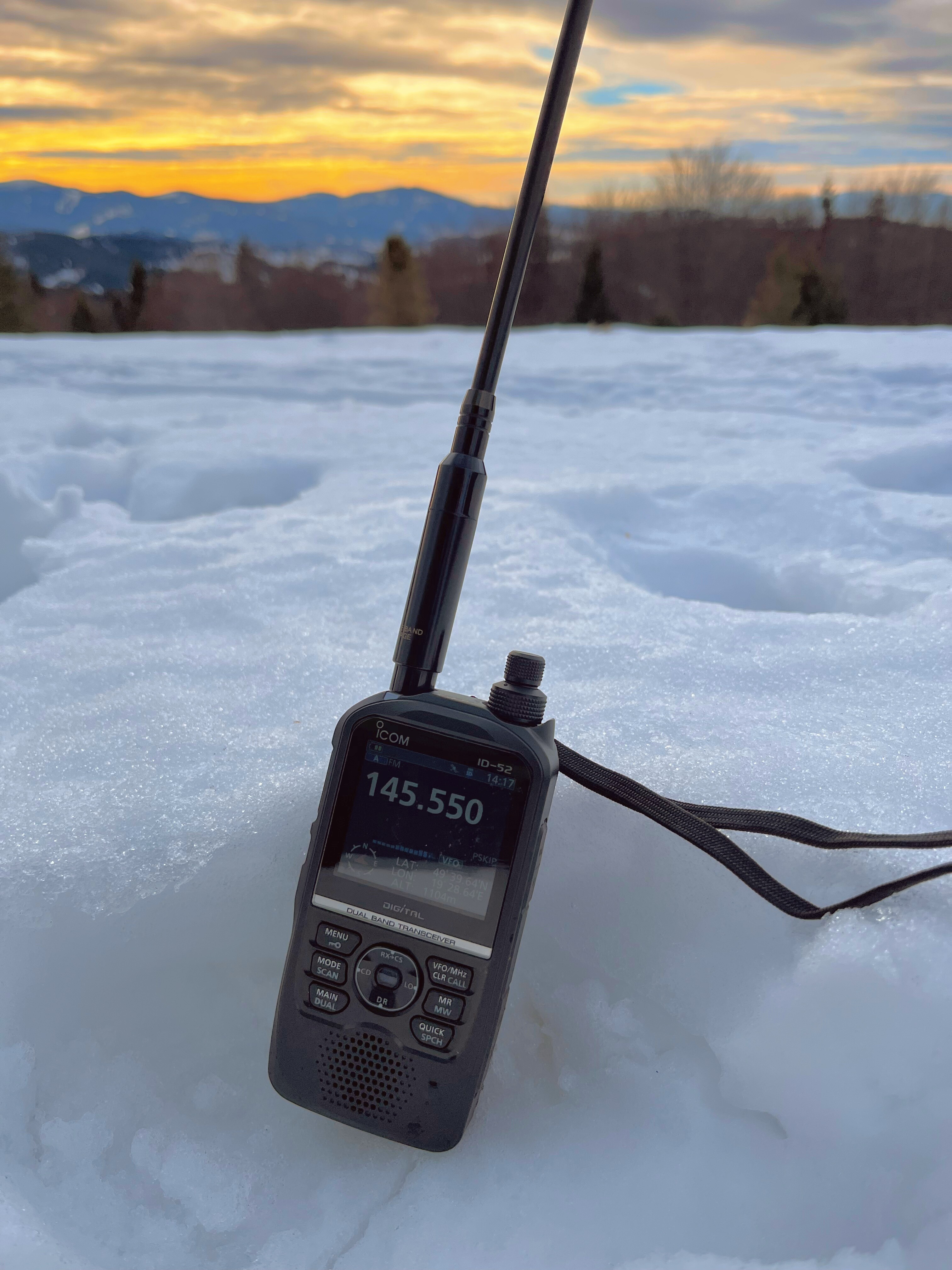

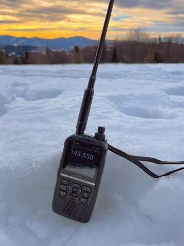

I’ve been using my ID-52 since September 2024 for over 20 activations, averaging 20–25 QSOs on 2m per activation. At least 10 of those activations took place in sub-zero temperatures, and the radio has never dropped power to 500mW on me.
I usually carry the radio in one of the external pockets of my backpack, so its temperature is close to ambient when I operate it.
