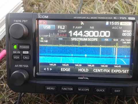

Lucky you, Michael! The rx is miserable on 144 MHz. See the video of my last weekend’s activation. Same effects on the October’s/November’s first Tuesday. The FT-857 easily outperforms the IC-705 on 144 MHz.
Not that much activity on the band, except some CW signals below 144.150, some beacons above 144.400, and QRM on 144.174. Built my shack on a summit (365 m asl) in JO50sw, 5 ele DK7ZB (8 dBd) @ 4 m agl.
The rx is heavily overloaded with the internal preamp on. Note the OVF indicator showing constantly! Switching the external preamp on (at 0:26, ca. +12 dB) stops the blocking with its narrow band pass filter. When the strong station on 144.328 (S 9+10 dB) starts to call, the rx again overloads.
