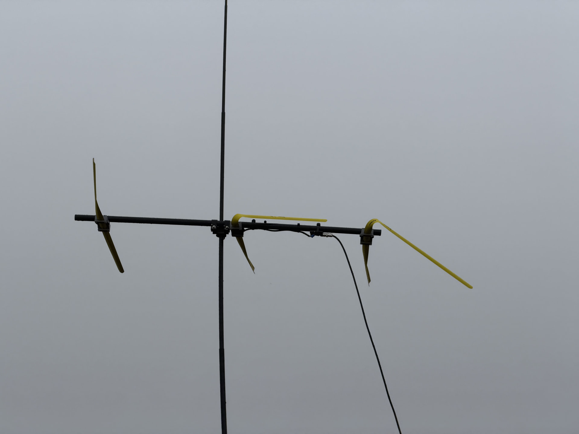

Upon reaching the summit of Cold Fell, we were indeed Cold and I almost Fell on some slippery rocks - really living up to its name here. We set up the M1TJM Botherer Magnet and away we went on 2m SSB, properly, for the very first time. You’d be right to say that I am very late to the 2m SSB party, and I feel like I’ve missed out on some epic contacts on my past activations, but no-more… this mode will be used on future activations for sure. Like most activations when trying something new, it didn’t all go to plan. From bending elements to coax losses and eventually just completely broken coax, I was described by Jake as ‘crestfallen’. Now, I wouldn’t go that far… but it was rather sad to hear these chasers from afar and not be able to get back to them. Cue the picture of the tape measure elements bending in the wind.

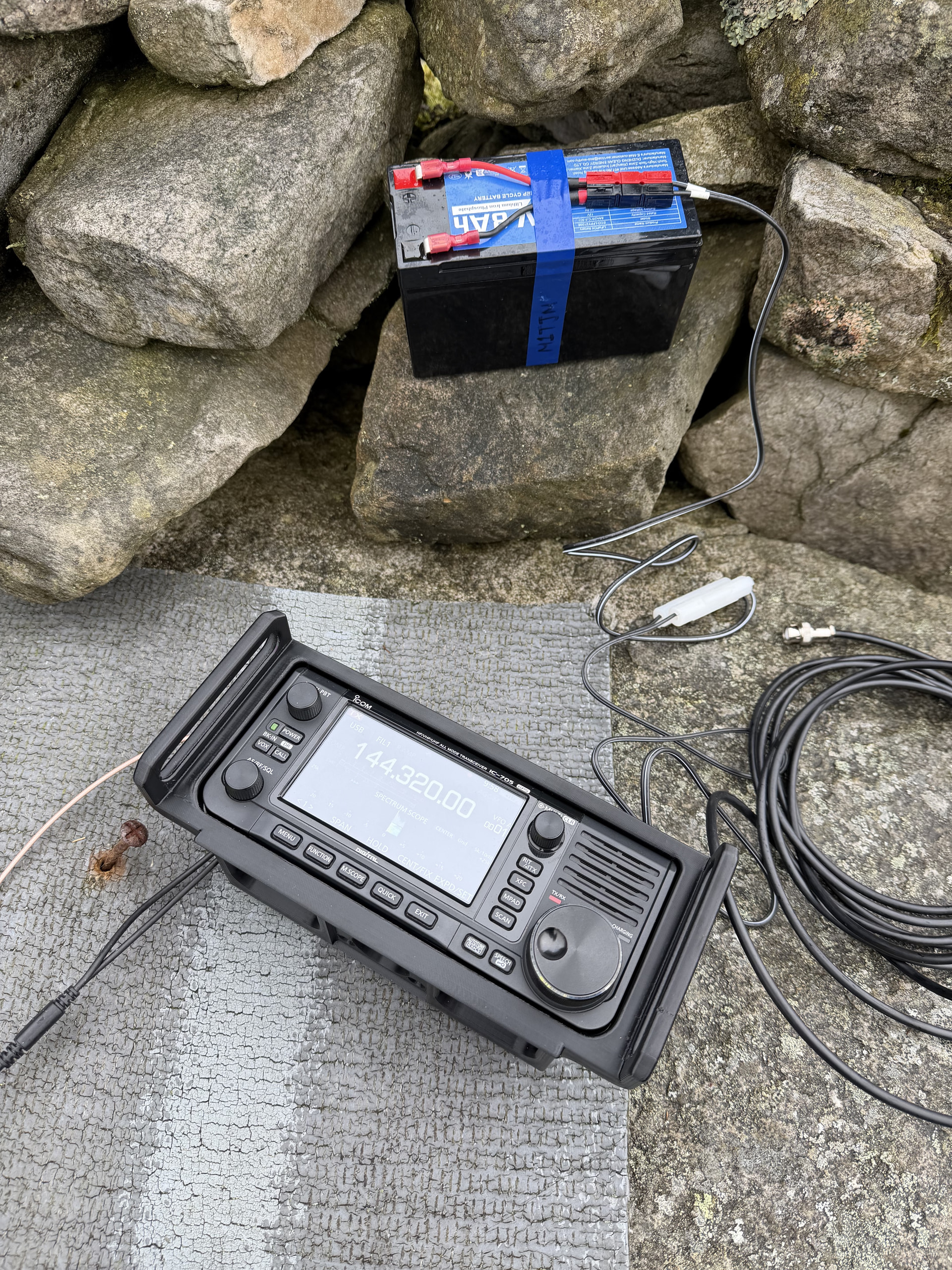

The coax, which I had made in the Austria YOTA 2026 camp a few weeks ago, was no good. I remember at the time saying “this feels weak, no way am I taking this on a SOTA”. I am unsure what changed my mind - but I’d also forgotten a fleece and coat, so maybe I am losing my marbles?!
We set up Jake’s slim-jim antenna and decided to try some vertical 2m SSB. Whilst I am not a fan of breaking convention, it was our only option at this time. I am very glad we tried, as the results were spectacular! Two contacts on our 10W into West Wales. Don, @GW0PLP and Frank, GW1OFA, were definitely the highlights from that activation - with a max distance of 354 km - this was just outrageously incredible. I can only imagine the distances we’d reach if our yagi had worked :smiling_face_with_tear: Thank you, Don, for continuing to try us whilst we were experiencing issues - your patience was very much appreciated.
This was the first time I’d used the Icom IC-705 in the field, and I really do love this radio. Having sold both of my Xiegu radio sets earlier on in the week, it was farewell to the G90 and X6100, and helloooo to the beautiful 705! I think this set is joining the FT-891 as one of my favourites. Not keen on that rusty nail so close to it though… thankfully I’d printed a nice rugged case for it.

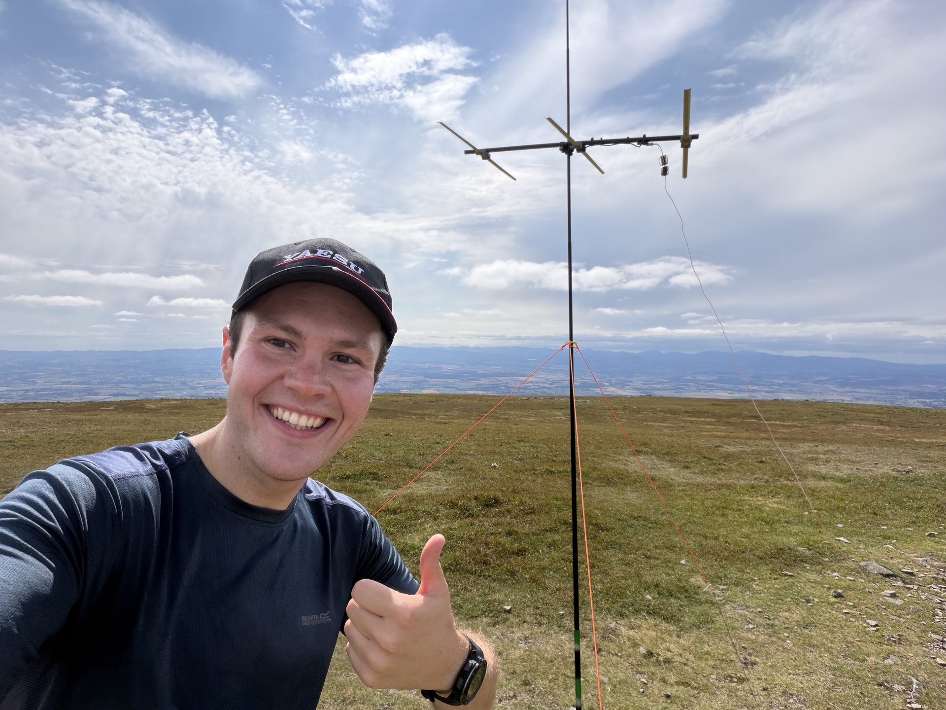

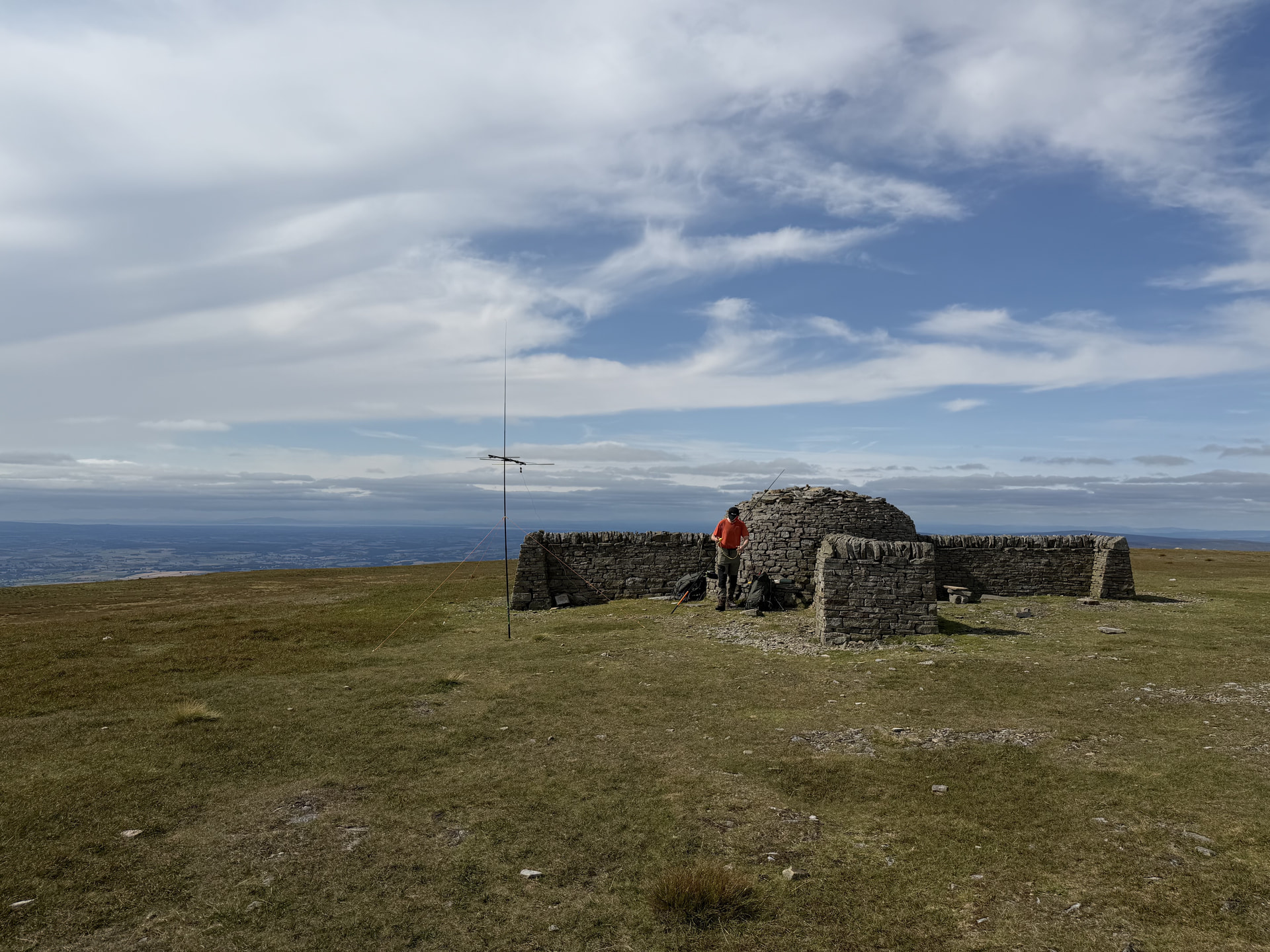

What better way to celebrate than setting up an antenna-farm next to the shelter. With a different run of coax, I was absolutely determined to put this tape measure yagi to the test. Aren’t I glad I did… as we had two glorious 2m SSB contacts with GI5JOE (what a callsign) and GD4OFB. With an excellent 59+10 dB report from GI5JOE both ways, I was very pleased with the antenna. At least the elements were behaving themselves this time. As you can tell from the picture, I was pretty chuffed that it worked out.
Jake set up his OFC-Dipole for the HF bands, but unfortunately it didn’t work out - we’re blaming the ground (it probably isn’t the ground :sweat_smile:). We deployed my linked dipole for 40m and 20m and made some contacts on the awfully cramped bands. Almost every contact complained about QRM on adjacent channels, but such is life I suppose!

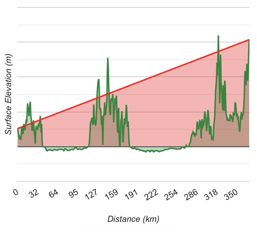

Hi Don,
Here is a rough elevation profile of our contact on vertical 2m SSB on 10W. Just incredible!
