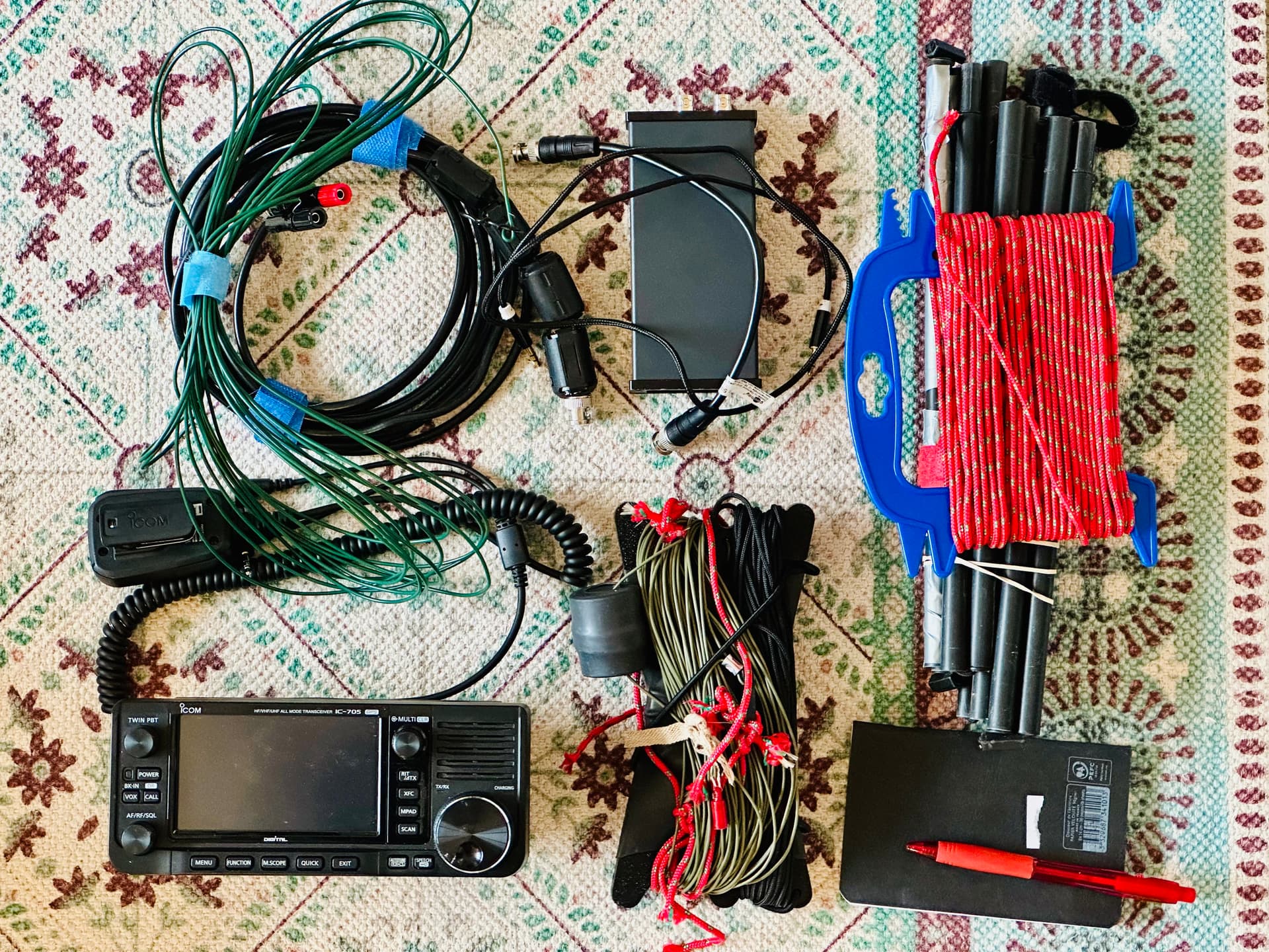

In my case, and until last year, the vast majority of my activations were made with the extremely heavy, battery-killing, but INDESTRUCTIBLE FT-857. When the 4th QSO didn’t appear, I simply increased the power to 25 watts and that’s how I achieved the summit points.
In 2023, I loaded the 857, VenusSW-3, and a QCX 18MHz into my backpack. I started calling with QRP rigs, and the conditions weren’t good for 5 watts. Here again, the old FT-857 saved me.
Last year, I acquired an IC-705, and when the propagation conditions aren’t good, I hesitate to consider whether to carry the FT-857 or the 705, since the power is what has helped me achieve the coveted 4th QSO on several occasions.
For these reasons (Surely there are much more), the weight can vary from just a few grams to several kilos on my shoulders.

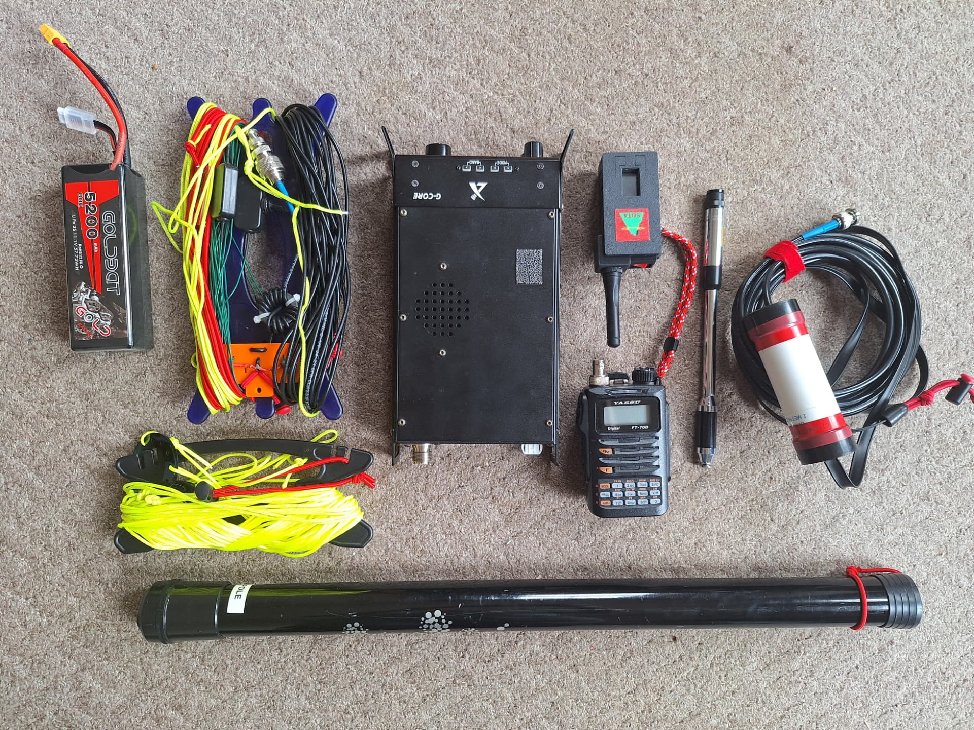

I don’t know what antennas you use for HF, nor do I know the reasons for using the FT-65 when using the IC-705.
With the 705, you have an SWR reading and could tune the antenna (if it were a link dipole or a telescopic vertical), and with an “L” connector, you could use the 770 antenna on the IC-705.
This way, you could reduce the weight by 647g.

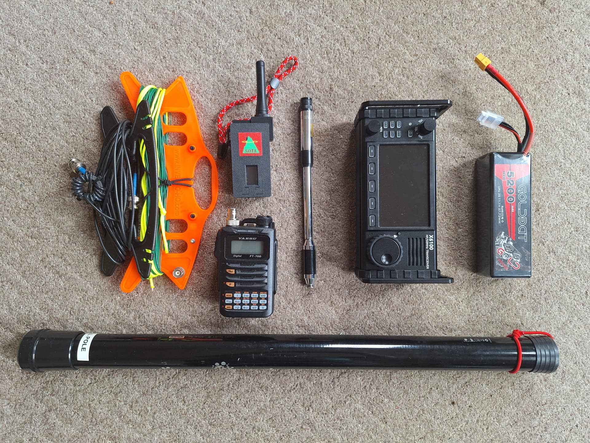

Agree there is a lot of gear that I probably don’t need to carry, but I do for redundancy and flexibility. For example I now generally carry a my home brew EFHW that is resonant on 20, 40 and 10m, but also an AliExpress 20m telescope whip. The telescopic whip is quick and easy to setup and I feel it’s better to use on a busy summit, but it’s a compromise compared to the EFHW, so I take both just in case :grinning_face:
Yes the SRH770 (BNC) is a great combo with IC705, I connect it directly to to IC705 and turn the transceiver on its side. However I still always carry a 2m HT. I have arrived at some very busy summits this year and opted to activate 2m FM only using a HT, even though I have HF gear with me.
But to be honest my x6100 is my HF transceiver of choice for longer activations, as much as it pains me to say after forking out to buy an IC705 :joy:

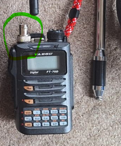

That gold-coloured BNC-SMA adapter is the same one as I use on my Yaesu FT1D 2m FM HT with my trusty Diamond RH770 ½-wave whip. In gusty wind the waving about of the RH770 can put a strain on the adapter and lesser brands have failed on me (3 times) mid-activation [the SMA pin snaps] but this adapter has lasted for many years (to date). I use a fibre washer between the adapter and HT case to ensure the connection is rain resistant.
