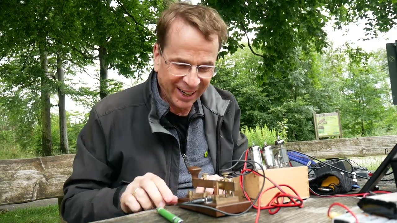

Today I took my recently built transceiver to my favorite summit DM/NS-122. The concept was make it as small and simple as possible with tubes. The result is 1W out, one channel (7.0202kHz) and a receiver bandwidth of 1-3 kHz.
The challenge was the circuit design and implementation, but today also the decoding and the unfamiliar straight key. Here is the result as a clip and a few pictures. Special thanks to Uli, HB9CGA and Fred, DL8DXL and the other OMs for their well audible signals.
P.S.
Don’t be surprised if I’m always checking my phone. There runs the excellent Morse code decoder “Morse Expert for Android” :smiley:

This is wonderful! How to you obtain the 90V voltage? 60 AA batteries in series? Or some kind of step-up circuit?
73 de Martin, DK3IT

This step up converter would be an ideal addition to my TCX. I’ve been thinking about how I could develop and build something like this myself. The suppression of the interference signals is very important. At the moment I solve the supply with 90V by 11 pieces of 9V batteries.
