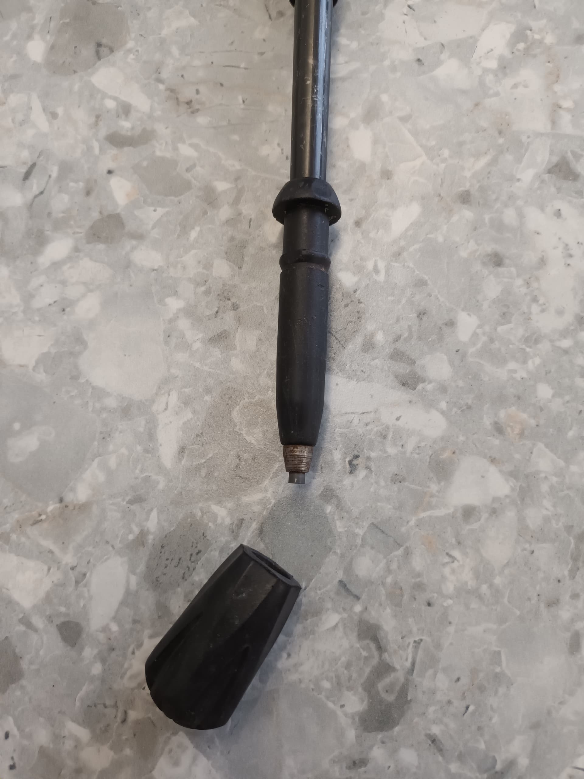

I thought the boots were for tarmac. There should be a disc which stops the sharp bit going too far into the ground. This is how I use mine and I couldn’t be without them, up or down hill, especially when carrying SOTA gear. One of them keeps my tarp up but have never used them for antennas.
I bought my first set when in Slovenia, to help with the ascent and descent of Triglav - from Bohinj to Rudno Polje.
They were a godsend going up and down - I now never go anywhere without my poles.
My first set eventually needed new tips after a few thousand miles… but with the bottom section being made for a specific tip, it was difficult to find new ones. Also, the carbon/resin had fallen apart in one of the bottom sections.
I’ve since bought a pair of alpkit poles, which use the same tips as some Leki poles (spares available), and the bottom section is Alu which will make life easier when they need replacing. Barely any weight penalty for something sturdier and longer.
I always thought they were called snow baskets. But snow baskets are much bigger than what are known as baskets or mud baskets. They make a big difference when using them. Mine are the notched type that make it easy to clip the poles together at the “sharp end”.
