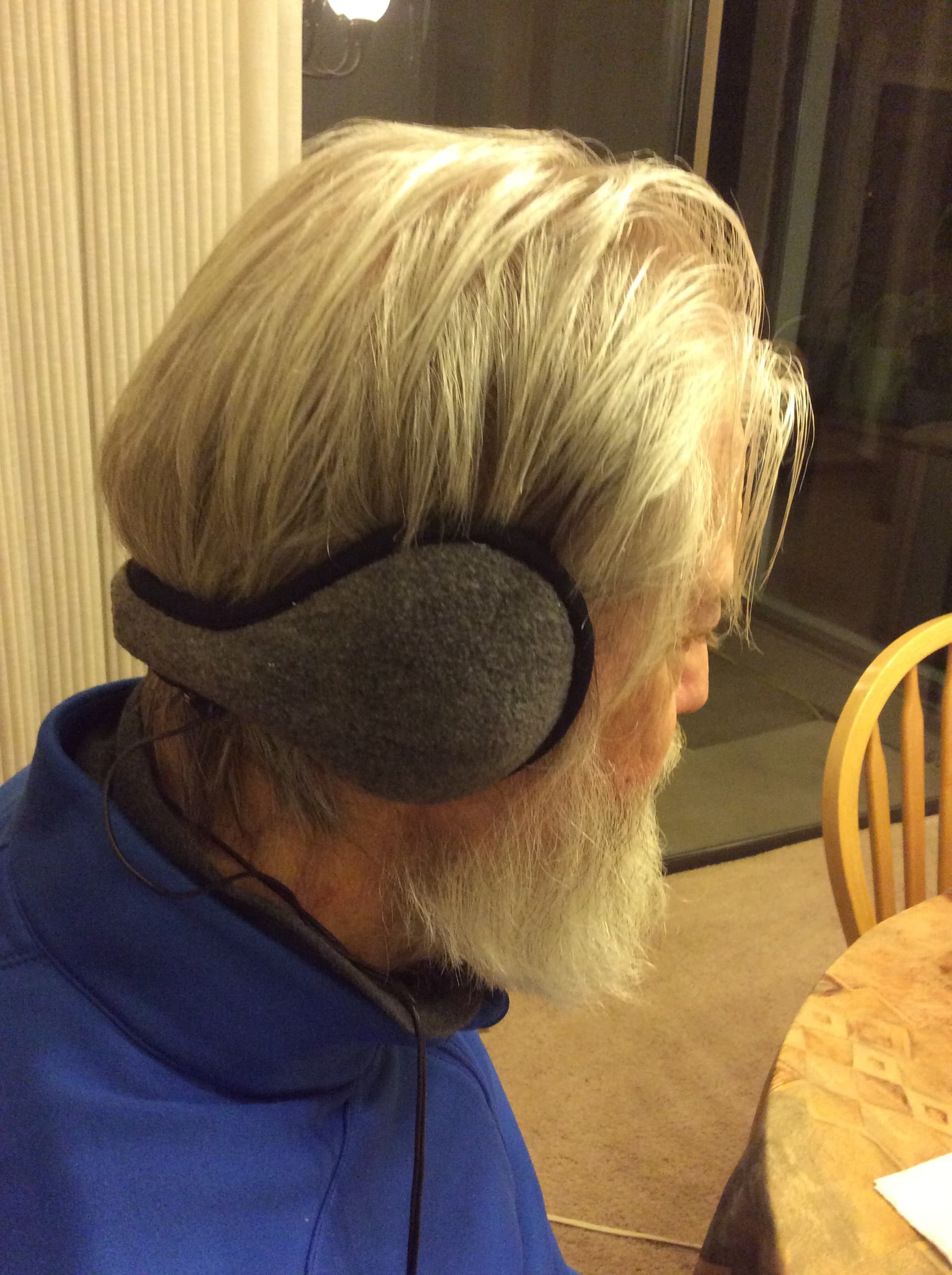

Perhaps the best discovery, however, was when my wife bought a pair of ear muffs that wrap around the back of the head rather than over the top. They had included pockets on each side for optional speakers. So now I have this for cold weather operating:

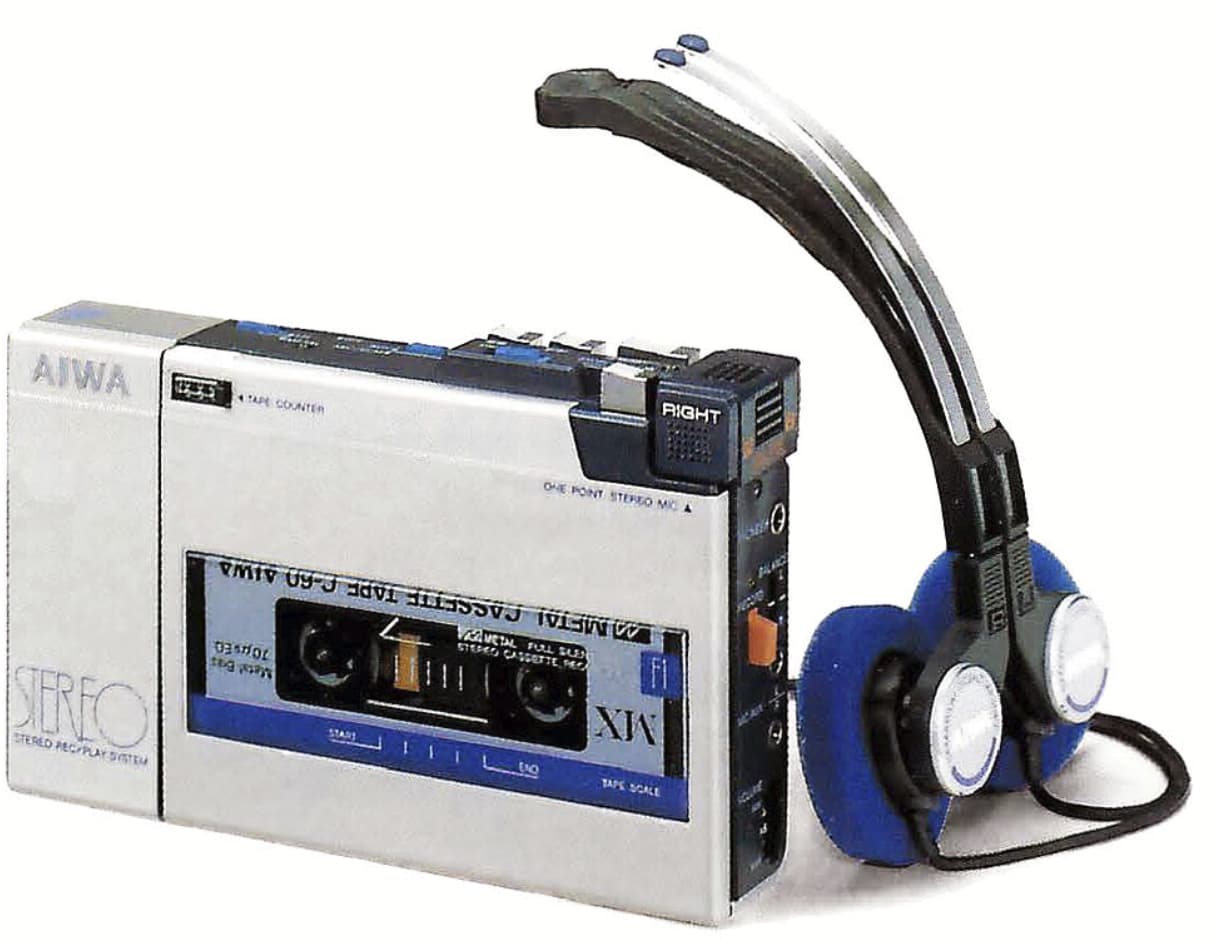

In the 80s, I had an Aiwa Walkman with foldable headphones… I’d love to have those headphones again for SOTA.
They were light, small, and sounded good. I’ve never seen anything like them again.
If any of you have something like this lying around - and would like to part with it - please let me know :innocent:
