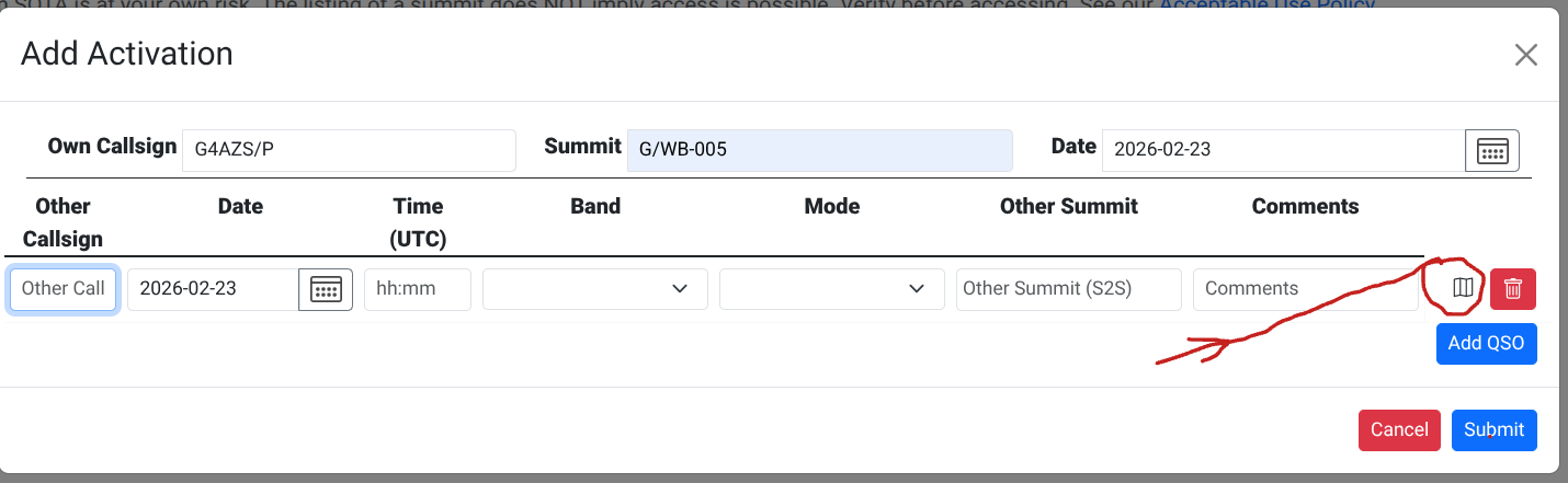

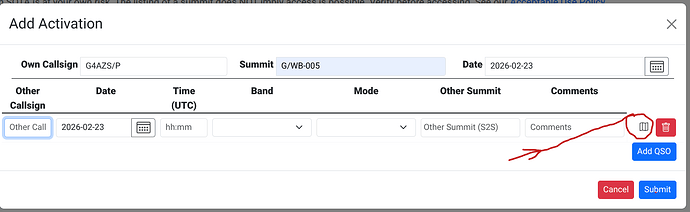

When I try to submit QSOs for SOTA Challenge manually as an activator, I do not see any location dialog. Only available fields are “Other Callsign”, “Date”, “Time (UTC)”, “Band”, “Mode”, “Other Summit”, “Comments”. Should I put other station location into “Comments” field?
Hi Oleh,
It isn’t very obvious how to do it - you have to click on the map icon in the upload window as shown here:
That will open and let you input location data. For logs that you have already uploaded, you can edit them in the same way and re-submit. No need to type all the info again.
