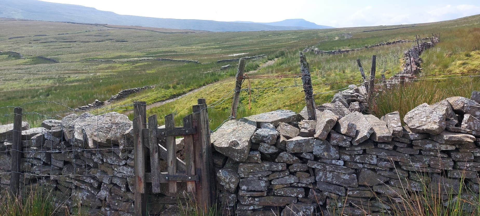

I walked along Occupation Road for a while before going through a small gate, heading up across a rough field towards the boundary stone on the ridge.
Turning to face the little gate off Occupation Road you have a good view of Ingleborough G/NP-005.

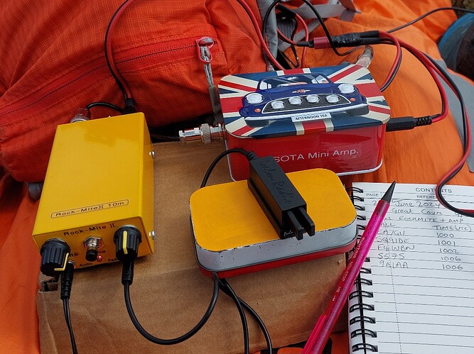

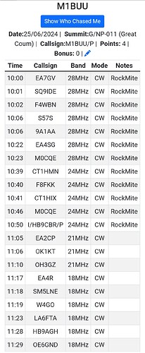

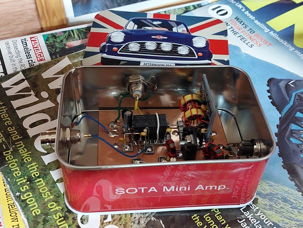

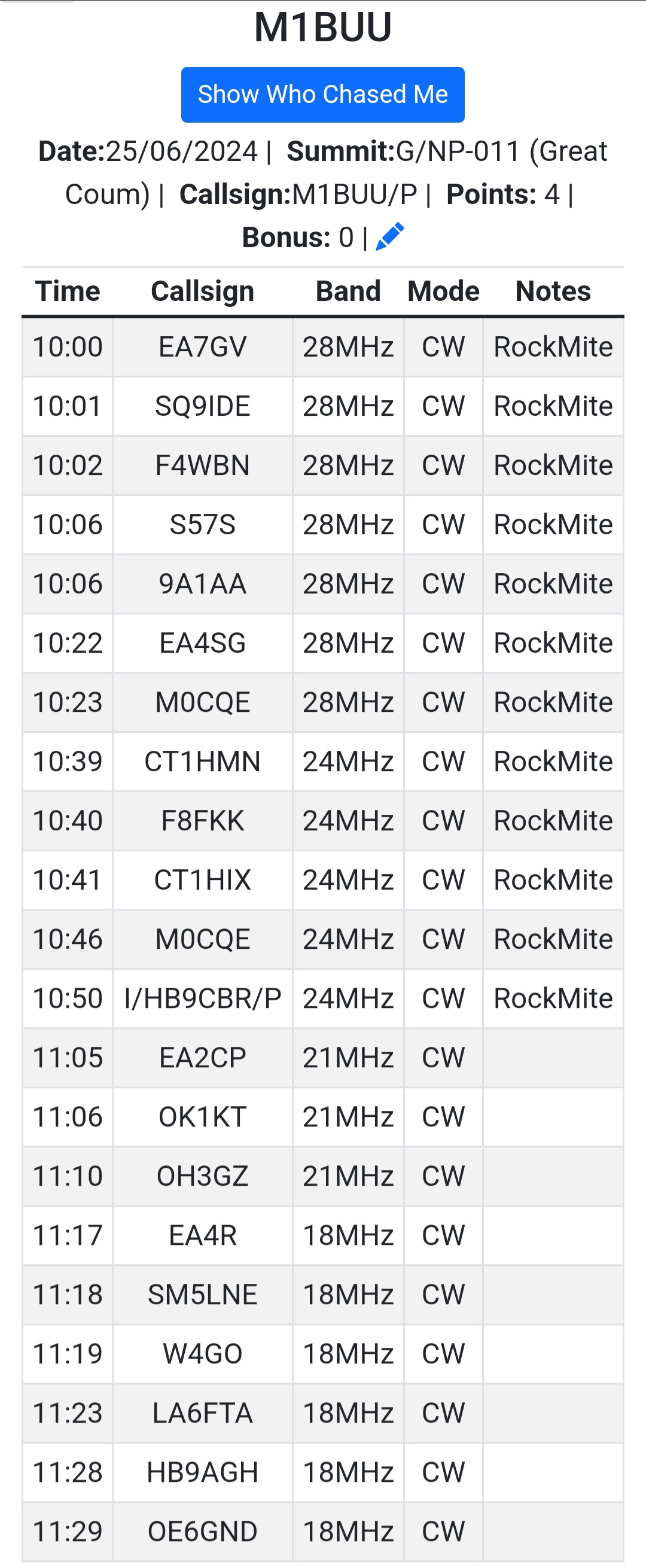

I’d taken my RockMite 10 and home brew QRP amplifier to try. The discussion about lack of CW/SSB QSOs on 10m prompted me to have another go. I was pleasantly surprised to make more than enough QSOs to qualify on 10m CW. Output from the amp is about 2.5watts on 10m.

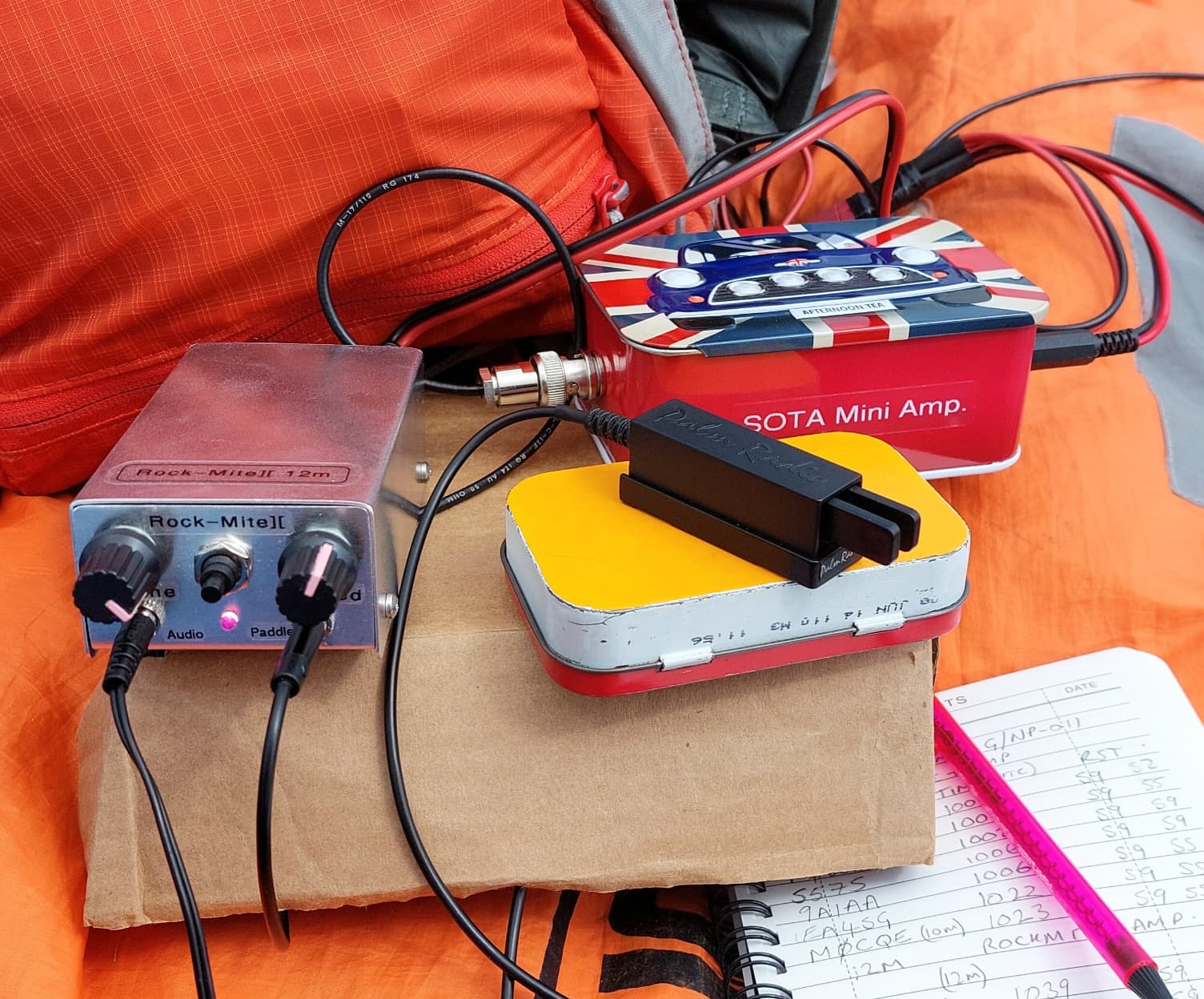

I’d also packed my 12m RockMite and I gave that a go too. Again I used the amp and I was able to make 5 QSOs, including an S2S with @HB9CBR operating as I/HB9CBR/P on I/LO-440.
I’ve been a ham for over 25 years but I still find amateur radio magical. Making that QSO with Bruno using a rig, amplifier and antenna that I’d constructed myself really filled me with pleasure.
I plugged in my MTR-5B to have a go on 15m and 17m as my dipole is built for 10/12/15&17m. It was nice to be called by Matt @W4GO once again, he has become a regular caller :slight_smile:

The amp tin, LOL!

The amp was made with the idea of achieving a homebrew transatlantic QSO, which I managed during an S2S event.
The tin was found in a discount store at a reduced price, it contained tea bags.
