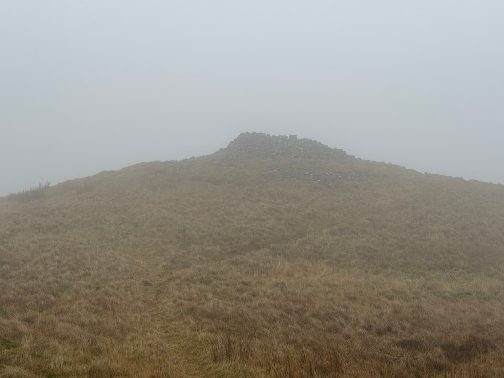

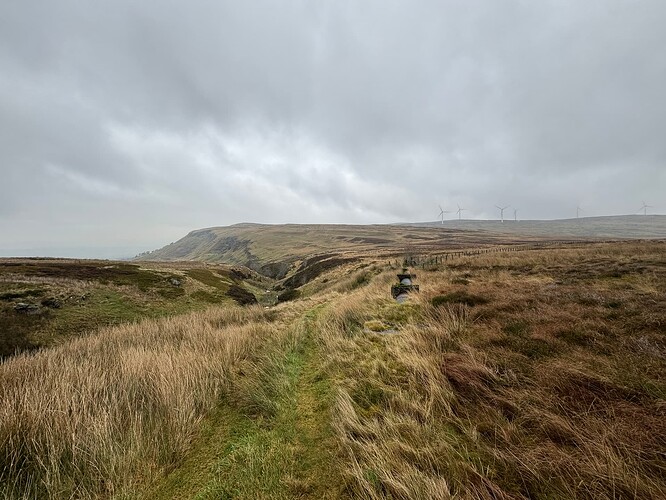

As you can maybe tell from the image, the cloud base had not in fact been at 700m at all, but probably closer to about 350-400m. Still, other than everything being OmniDamp™, the rain had stayed off and it was time to get hunkered down in the small stone fortress. There’s a handy trig point in the middle of the summit shelter, complete with open cap, so I popped the 4m fibreglass pole up with the Spectrum Slim G and got cracking.

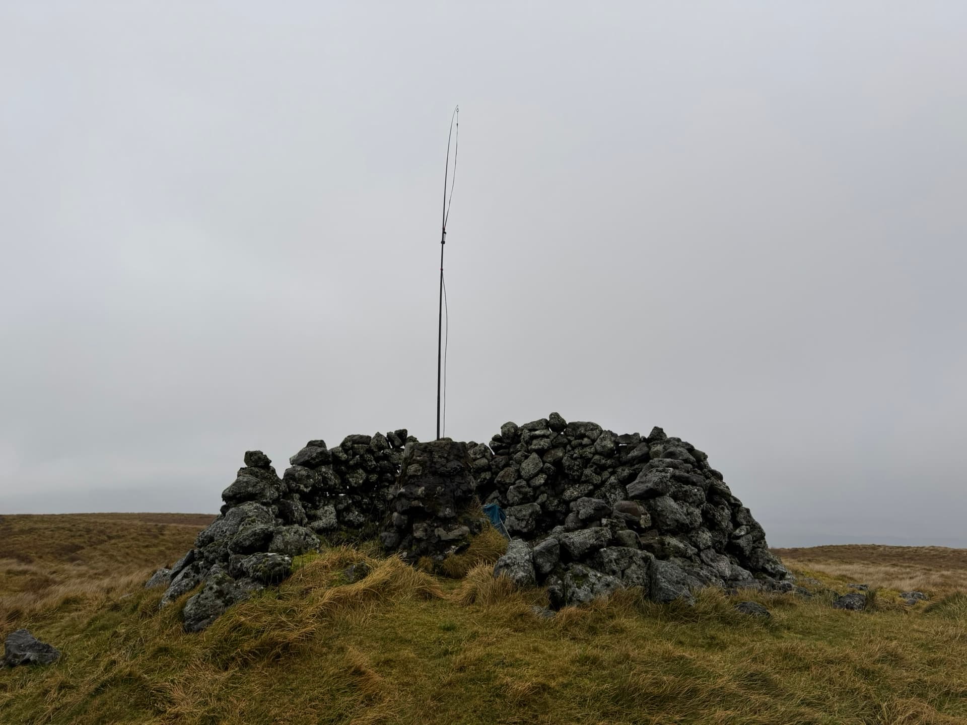

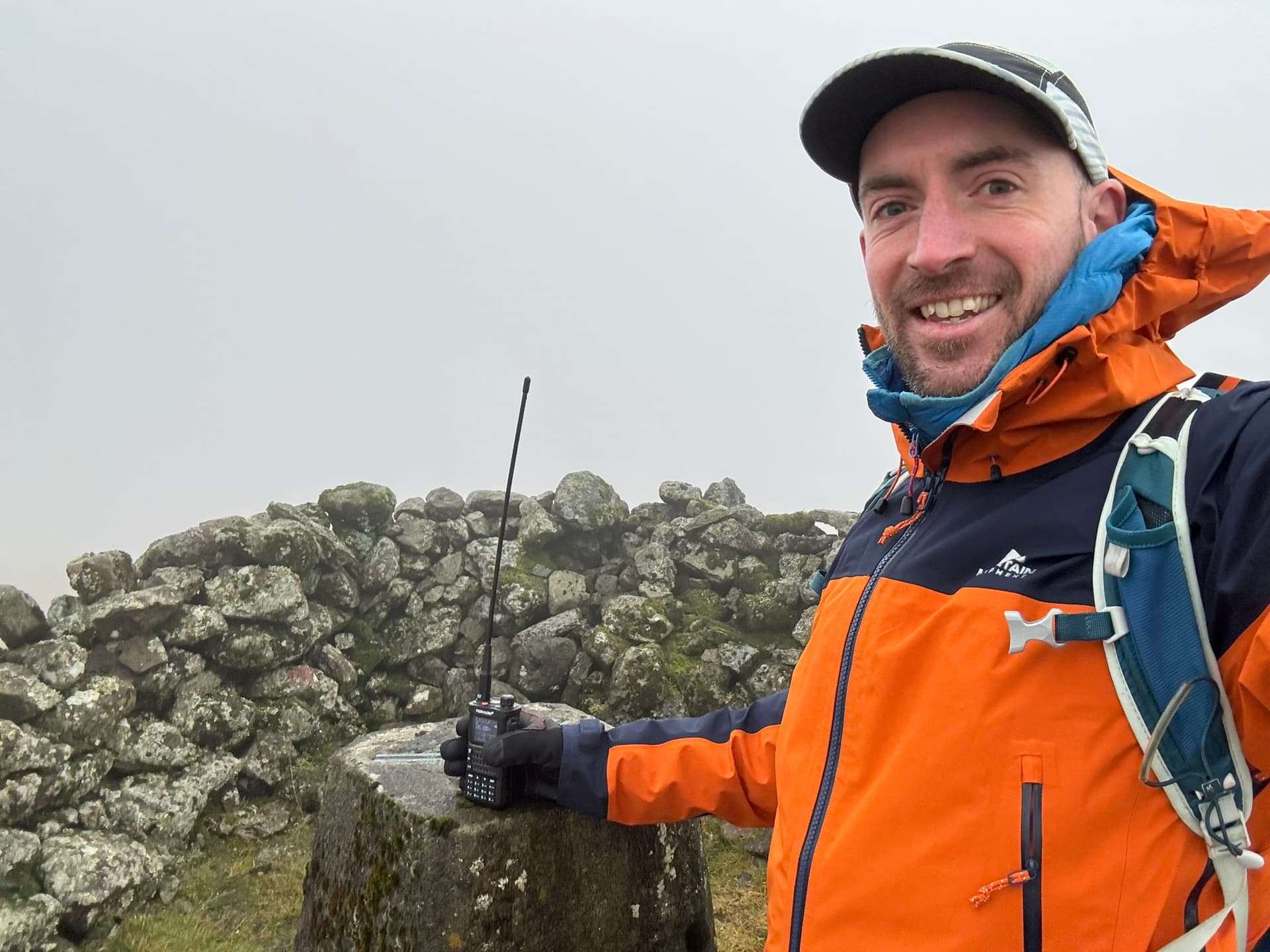

Once again, the summit at Stronend is marked with a handy stone shelter wrapped around a trig point with an open top, so up went the Slim G and out went some more CQ calls. Once again, I was having a lot of trouble with music breaking into my receive, and probably even worse than previously on Carleatheran. My other problem was that the summit shelter was built to protect against the prevailing southwesterly, so of course the wind happened to be a robust easterly, so I had to use the trig point itself for what wind shelter I could get from it.

Anyway, beyond the activation day itself, I was having an absolutely hellish time with the receive on my radio, and this has been a wee bit of a common theme. I’m new to amateur radio (I passed my foundation in October 2025, and just upgraded to my intermediate in early December 2025, and I’ve just been using a couple of cheap hand-held radios to get me started. The radio in question I was using for this activation was the Tidradio TD-H8 - I’d seen some of Fraser (MM0EFI)'s youtube videos where he’d had some pretty good results on RF-heavy hilltops with the H8, but I was getting fairly audible music coming through on mine, so I don’t know if mine was maybe from a different batch etc., or whether it’s good against pagers and the like but not so useful against broadcast stations?

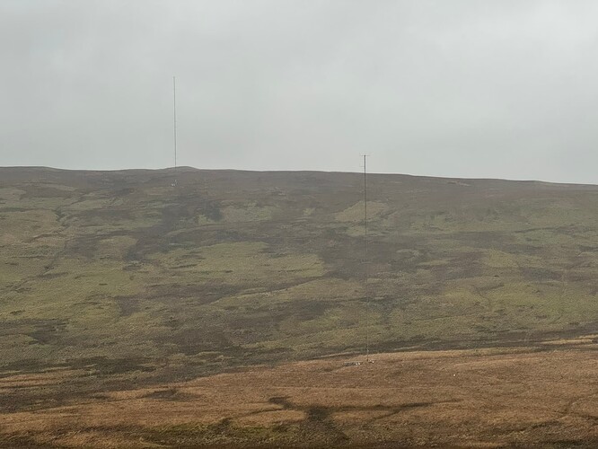

Anyway, trying to suss out the source of the interference, my guesses at the culprits would likely either be Earl’s Hill (various radio) which was about 5km from Carleatheran, or the Fintry telly transmitter which was about 3km west of Stronend? Also, there were various other bits of mast kicking about, including the weather station for the Earlsburn and Kingsburn wind farms, and two masts that I couldn’t identify just on the other side of Backside Burn (approx location grid square NS 65 88)
