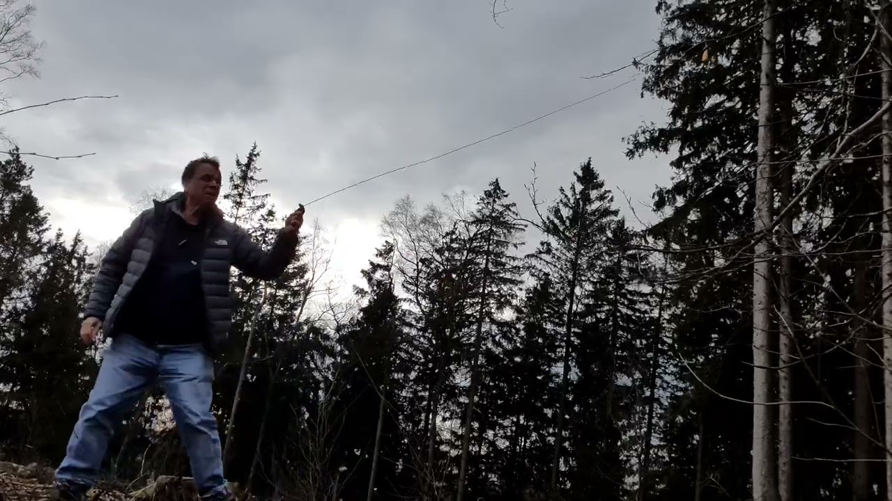

Matt, that’s exactly what I’m doing with almost 1000 activations now.
I don’t always hit the right branch and a few times I had trouble getting the weight to drop back down.
My brother wanted to help me once and threw with too much momentum. The result was that the weight wrapped itself around the branch several times and is still hanging in the tree today. :face_with_hand_over_mouth:
See the clip in German.
I can fully recommend W4GO’s sound advice. One additional note: The line should be long enough so that the throw weight (in my case, an arborist’s throw weight) can come down unhindered. If this is not the case, the weight may swing around a branch.
So you never throw your weight higher than half of the rope length (plus allowance for you not throwing vertically up).
I don’t use the bag that real arborists use, but lay the rope on the ground. You might want to clear it somewhat before, with time you get a feeling how clean the space should be.
My line is about 15m, this brings the wire high enough for EU S2S contacts.
As we say, “practice makes a master”: At first, my throws were abysmal and it took me much time to get it where I wanted (and ignoring the advice as all young apprentices do about not pulling the weight back, I lost a throw weight on DM/BW-235). But now, I can choose a branch and mostly get it with the first shot.
If I can do it, so can you!
