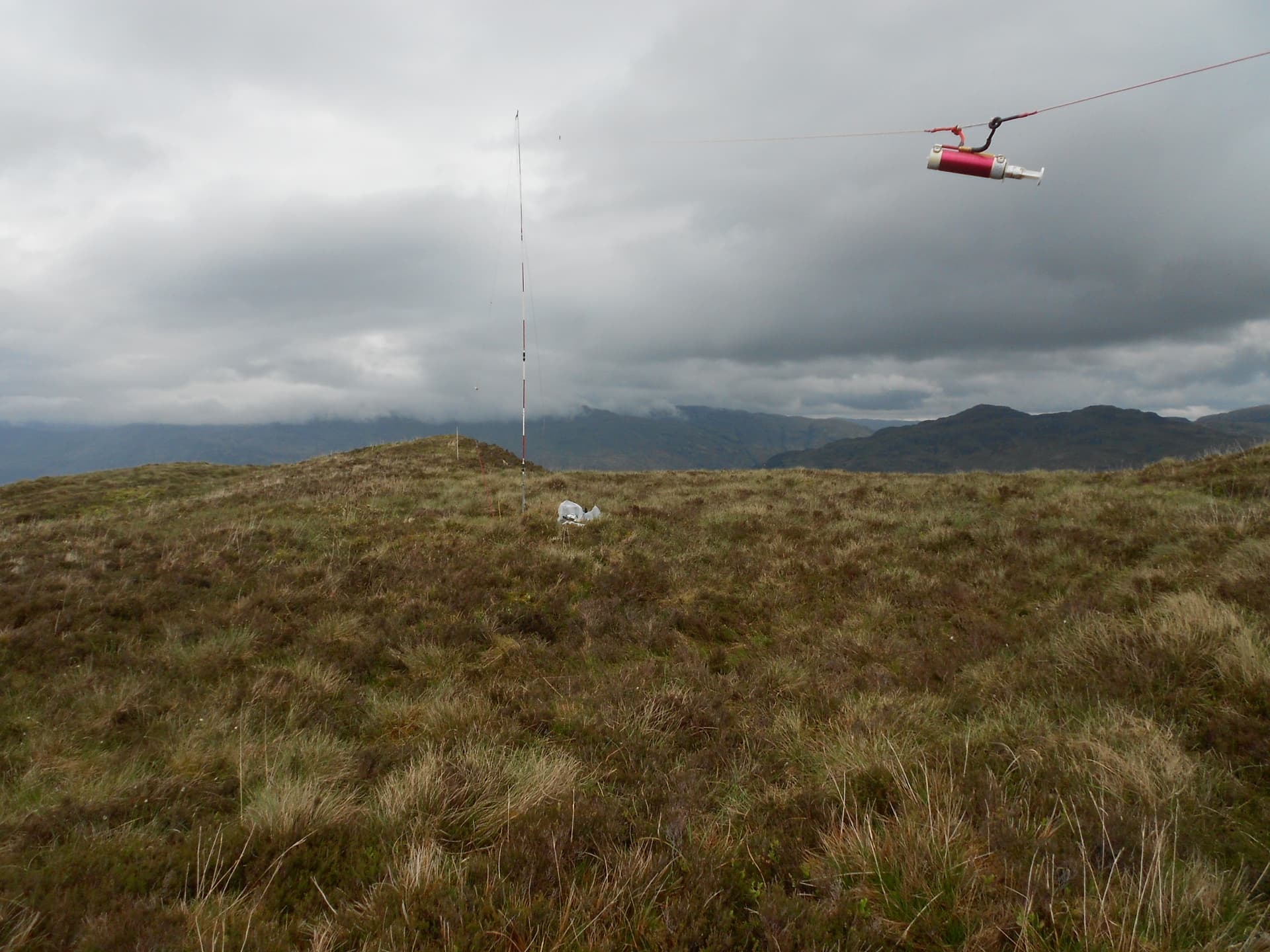

I set up the dipole in parallel with the trig point ridge and on the west side of it. For VHF later on, the intention was to move up to the trig which was in a windier place.
I didn’t bother to pre-alert for this activation, I was hoping for phone coverage and self-spotting. The SMS service had failed me up to now but I remembered what my son had told me. When a tiny ‘4G’ icon appears beside the phone’s signal meter, by selecting ‘Internet Connection’ spots are likely to appear without delay. Thus I made my first successful self-spots of the week!

Above: Trying Top Band - 160m
