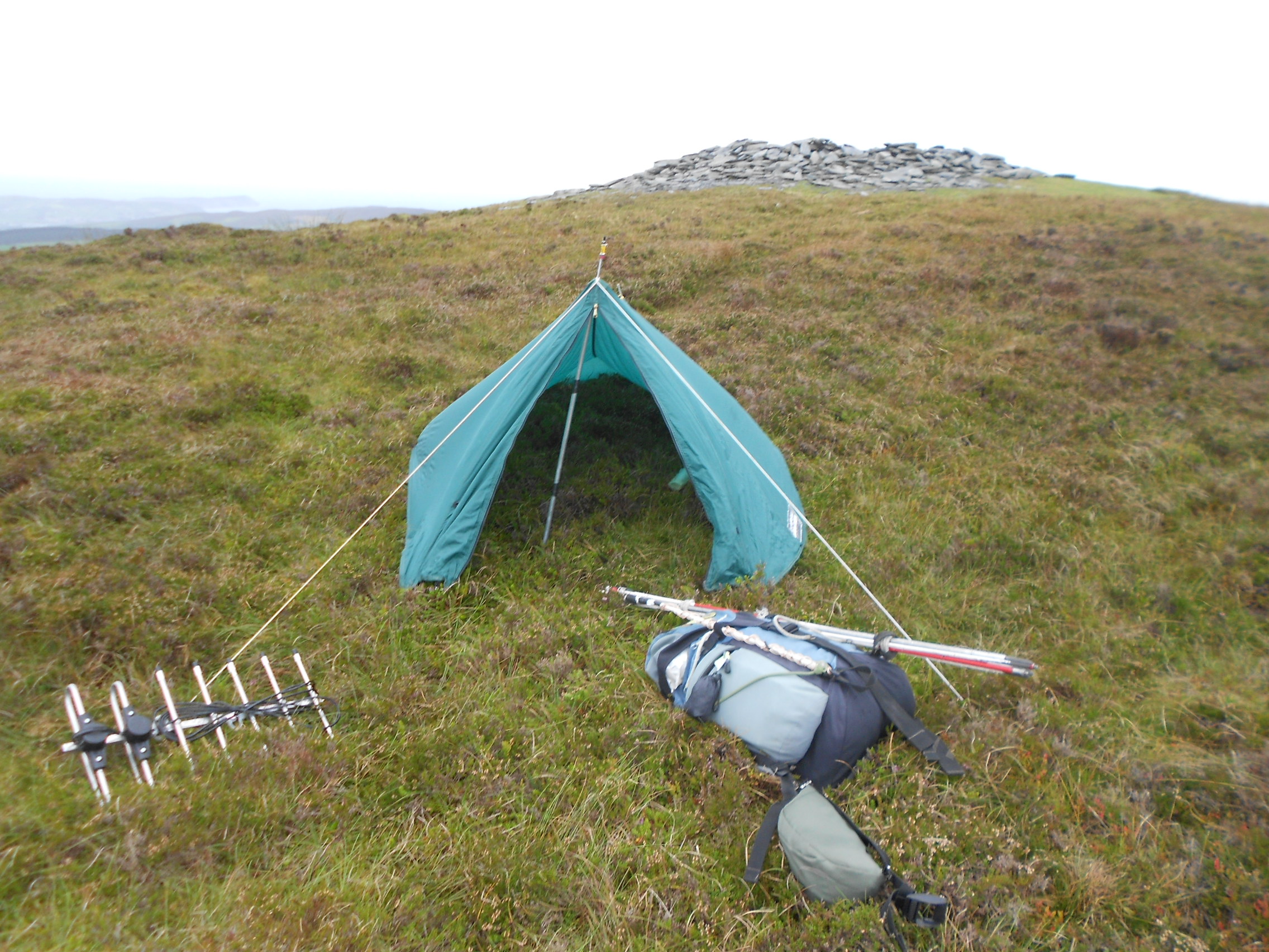

With a stiff wind blowing from the WSW, I tried to get into the lee of the rubble-surrounded trig point but there was little lee. In fact very little respite at all was available. The next consideration was the take-off for 70cm. That and the low, squishy bits needed avoiding. I settled for a spot about 25m NE of the trig, hoping that the latter and it’s plinth of large stones wouldn’t block the sight-lines SW too badly.
With rain expected sooner or later, the first job was to pitch the flysheet; a relatively quick job, except that the short pegs weren’t really reaching the ground through thick vegetation, some of it heather. Once the rucksack was inside and unpacked, I was happy. Rain? Bring it on!
The HF dipole antenna was erected parallel with the wind. I looked at the bodged repair at it’s centre, a legacy of GD1, hoping it would hold for this most important Top Band night operation. ‘Not too much tension John, but enough to keep the coils as high above the deck as possible, once the time for fitting them came.’
To be fair the long-suffering dipole in thin 24 AWG wire, with its attractive pink insulation, was not initially intended to take the weight of two loading coils, even though they’re only three ounces (accurately 78gm) between them. If set up over challenging topography (which doesn’t apply to GD3) or with the wrong included angle into wind, they can end up a foot off the ground, which really pulls the tuning, causing severe QSB if it’s windy.
The 7-ely beam was plugged into the rig and prepared for use but I carried no separate mast for it.

Above: GD/GD-003 accommodation for the evening
