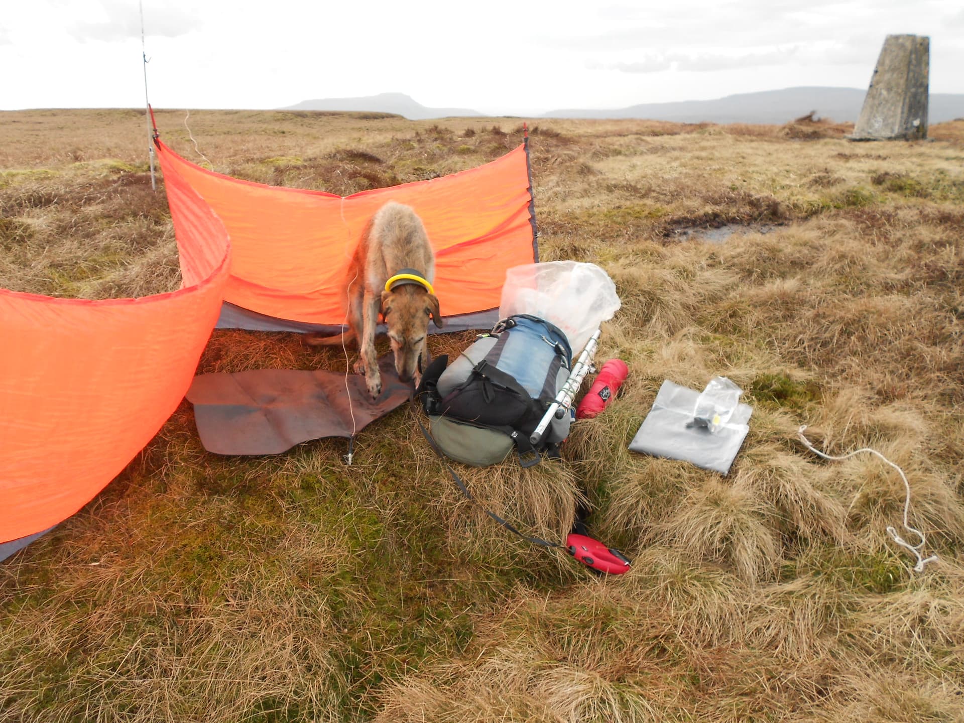

G/NP-016: DODD FELL HILL, 668m, 4 pts, 13:28 to 14:37 , 3 Deg. C 15 mph cold SW wind. Overcast. LOC: IO84VG, WAB: SD88. Trig: TP2795. No lying snow. Sparse Vodafone mobile signal.

The Moonraker MT270M 25W miniature mobile rig (570gm) was dragged out of the rucksack with a big filter and battery in tow. The receiver in this rig can suffer badly from overloading. The Sotabeams filter only handles 5W so I had to use an alternative.
Since I was only carrying VHFM gear to Dodd Fell, I’d brought a PYE filter which weighs 607gm (see ‘Equipment’). It is a two stage unit adjusted for 145 MHz but can be made useful anywhere between 132MHz and 174MHz. Evidently designed for the PYE Cambridge, it is solidly constructed and easily capable of the 25 Watts asked of it today.
With this set-up, which included a 2.2 Ah Li-Po, I worked stations that were not reachable with 5 Watts: G7KUJ Nathan nr Colne; G7SXR Mark in Leeds; G6XBF Walt in North Leeds and G0PMJ Dave at Darlington, enjoying 12C and sunshine which I wasn’t.
More CQ’ing on 145.500 added nothing further to the log but at least now, Plan-C, the mast and Sotabeam, wasn’t needed. I let Finn wander around while I packed up all the equipment. We walked off at 14:37 and he had another run around until reaching the PW.

Above: Prep for activation of G/NP-016 Dodd Fell on 2-FM
