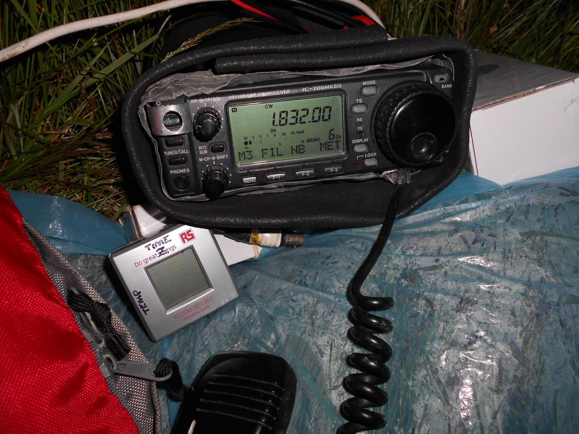

1.832 CW - 1 QSO at 22:00z:
With most bones in my body aching from the positions I was in and after two attacks of cramp, the time for 160m had arrived. That meant going back out into the dark and fog to reassemble the dipole set up earlier on the two upper mast sections to the three sections vacated by the 6m beam but I was glad of the exercise.
At bang on the alerted time of 22:00z the welcome signal of G4OBK came romping in. The exchange was 59 plus 20db/ 58 with power set to 100W and Phil kindly spotted me. Well done Phil and many thanks! As far as Top Band is concerned, you saved the day because I logged no one else after CQ’s on the two freq’s over the next 15 minutes.

Above: G4OBK was my only contact on Top Band. I need an advertising agent HI.
